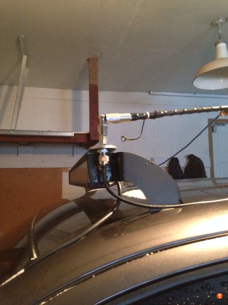

    My antenna mount

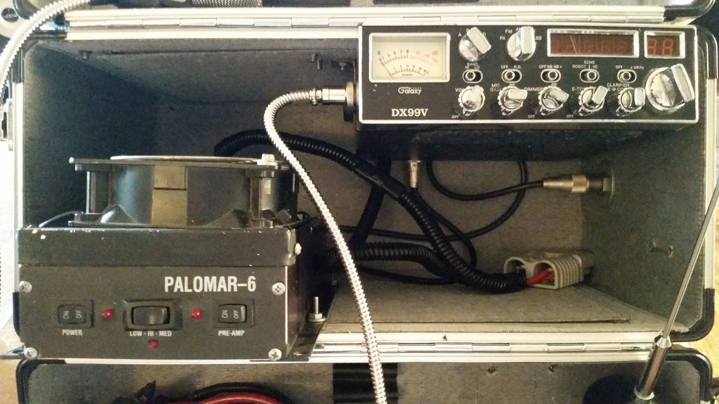

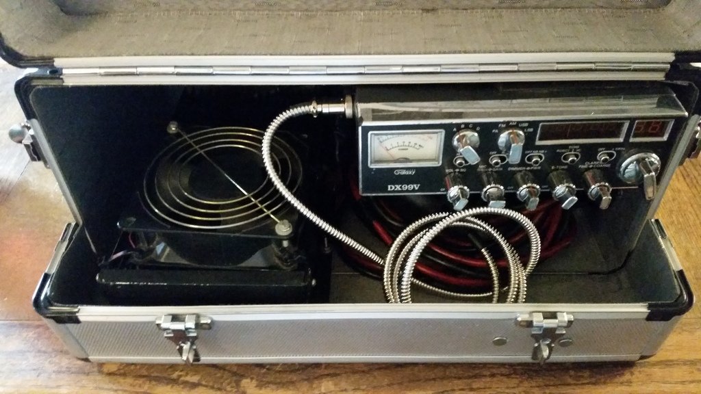

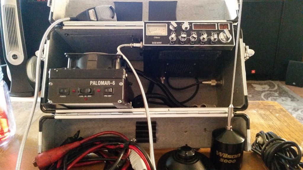

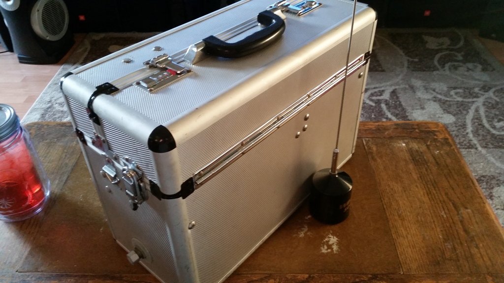

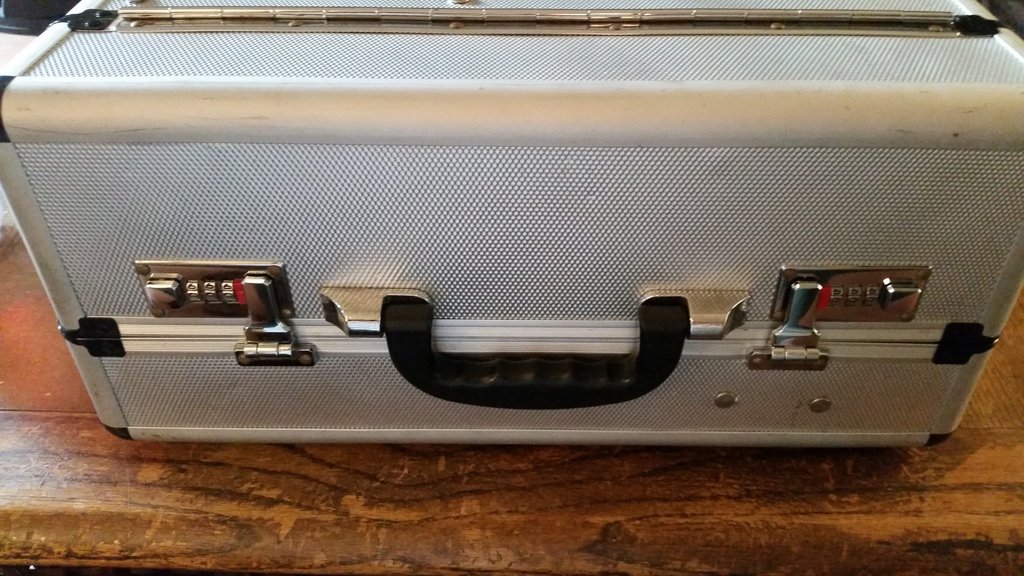

    My portable CB setup.
    LUSETACO likes this.

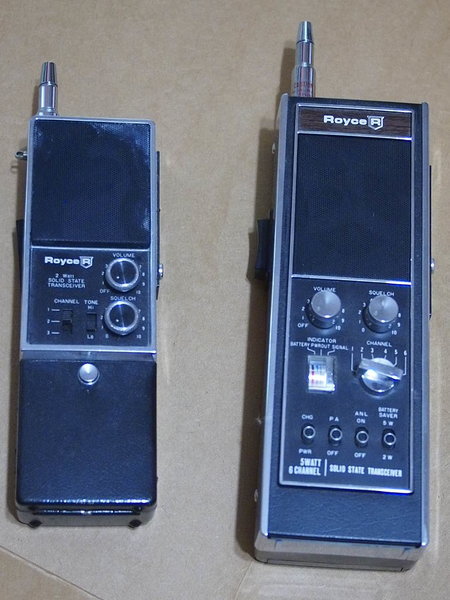

    Dude, ^ that's a cool setup! I found these old school portable CBs in storage at the weld shop I worked at a few years ago.
    I don't play with em much but I think they're cool. They do still work!
