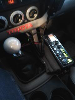

    Where are you guys running the ant. coax through and into the cab ? I made a small slit in the rubber boot around the steering column, and fed it through without a PL 259 on it and added it when done. Is there a better way to do this ? Thanks.
    We installed a Galaxy DX 959 in our work truck, mounted on the side of the console. It was kind of a large radio and this was the best place we could find and has worked out well.

    I've got light switches and Ham lines through that steering boot.. my CB runs out the passenger side up behind the ECU. CB is under the pass seat for now, soon to be replaced by a 75wxst though.
    Antenna mounted to Lightbar up front;
