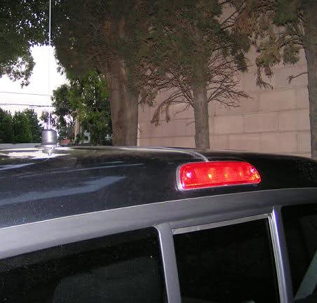

    i mounted my Cobra 29 WX LTD NW in my rear passenger cup holder. i used a dremel and a fine file to make the cuts and modification for the radio to fit.
    i also slightly modified the back of my 3rd brake light assembly so that i can run the antenna cable behind it and into the cab instead of running the cable through the sliding rear window.
