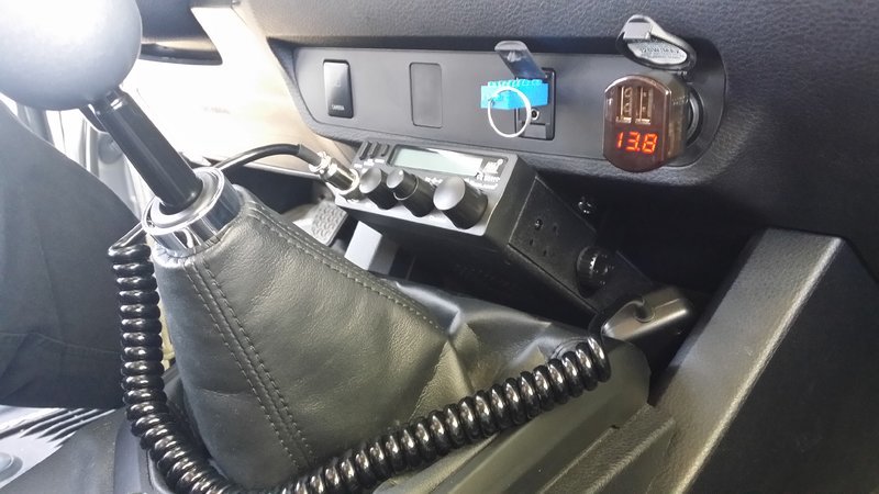

    the hand held units are probably your best bet for a clean install in the tacos.

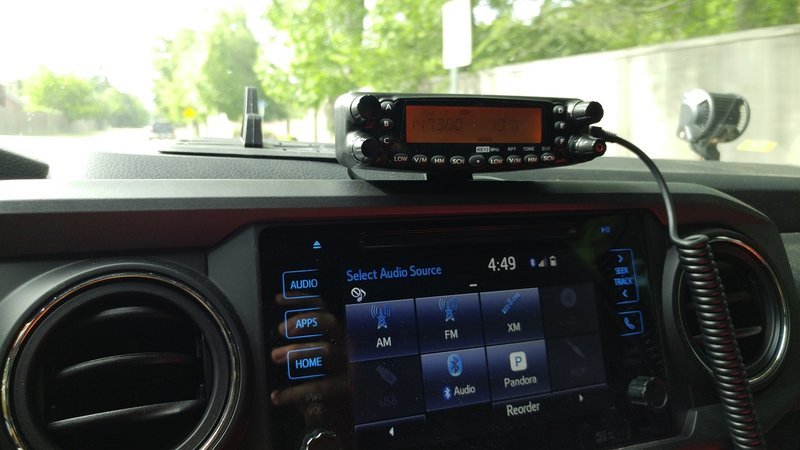

    Here's my install. I have hit 12 miles simplex and 75 miles with a 2m repeater as my best so far. Using a single 1/2 wave antenna which handles both bands and doesn't require a ground plane on 2m. (it's a 5/8 wave radio on 70cm, and even without a ground plane its 7 or so miles simplex)
    I found some bracket I had laying around, and bent it up in a vice. It's screwed with 2 small screws into the removable face of the trim.

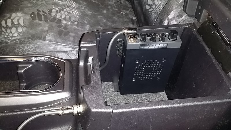

    Mobtown Offroad IFS Aluminum Skidplate Low-Range Rear Diff Mod Softopper Reaper pattern custom car grills President Johhny III CB
    Got any more pics of that uniden hanging out in the cubby there? I have toyed around with the idea of using that spot.

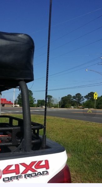

    Nice Job, looks good.
    How did you run antenna cable out? Any picks on what you did for antenna (kind, mount)?
  17. May 12, 2017 at 6:06 PM
    #37
    Flytmech
    Flytmech Well-Known Member
    Nov 24, 2016
    #203182
    857
    Jase
    Geneva Alabama
    2016 Tacoma TRD OFFROAD 4x4

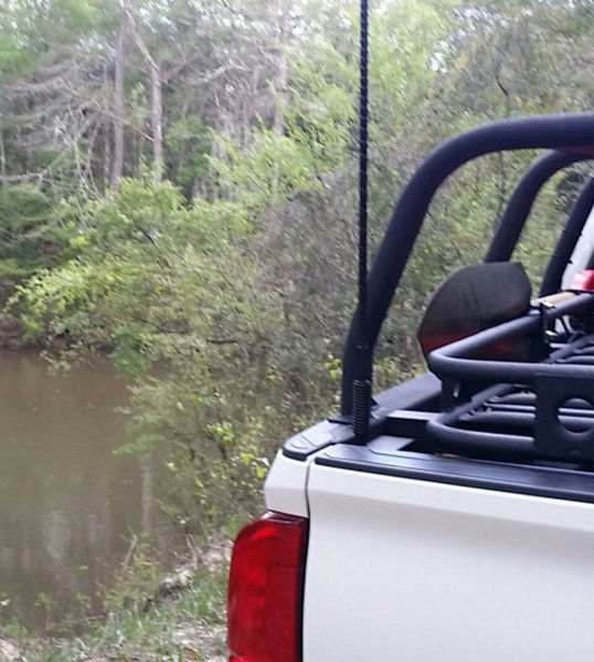

    All Pro Offroad bed rack Defender Basket OME/Dakars Total Chaos ucas C4fabrications LoPro Smittybilt 9.5 comp Uniden 520xl (tuned) CVT Mt. Shasta Black Oak 50 curve led
    Cable is under the carpet, out a drain hole in the floor and up over the bed, under the rail to the rear left corner20170512_200441.jpg sorry this is the best pic I have of it right now. I fabricated a bracket to attach to the aft bed pillar

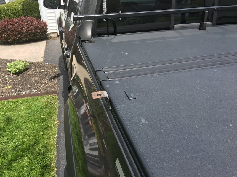

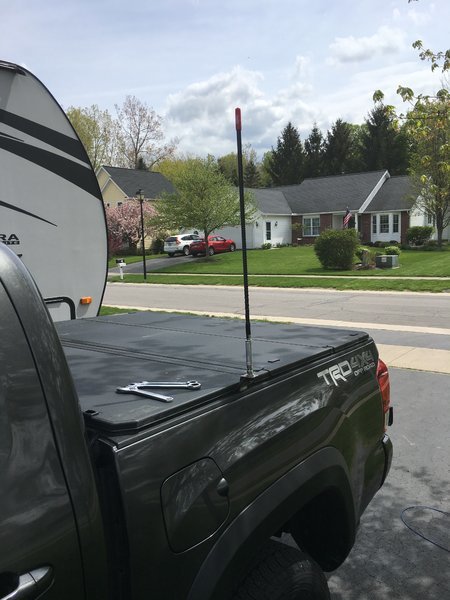

    I use this for holding my mic and it works very well. http://www.hondogarage.com/index.php/product/landing/cb-mic-hanger

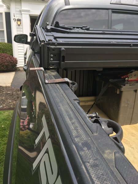

    I also have been working on building a bracket out of some scrap metal I had hanging around to work with my oem tonneau cover. I was looking for a way to move my 3ft firestik (in the picture I have a 2ft one on) as far back from the cab for best swr possible with that setup. I will be painting the bracket after testing swr soon. I have the bracket mounting to the bed rail which I tested the ground on and showed up fine on my multimeter. Anyways it is a work in progress....

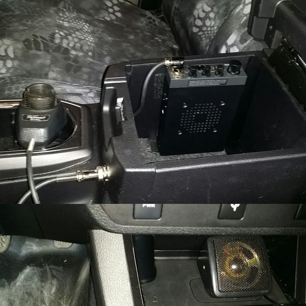

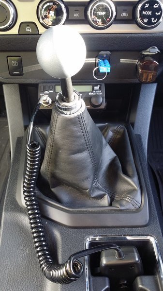

    Here you go...

    Did you just screw the bracket into the plastic?
