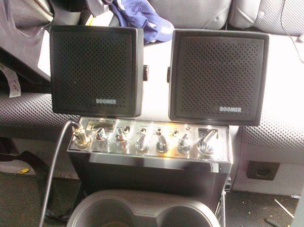

    Thats exactly the problem I'm running into, the Cobra 29 I think has an AUX so i can plug into my truck stereo system (I dont really listen to music when I wheel)
    MONDOOOO System, to big for me tho

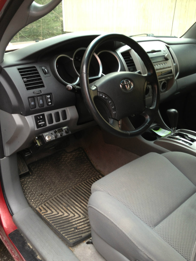

    just put mine in the other day. im in the same boat as you, as far as not wanting it to be noticeable that you're a nerd with CB.... lol
    here is where I put mine, its a Uniden PRO510XL i got on ebay for like 20 bucks shipped. it has a pretty loud speaker in it, so no need to mount an external speaker anywhere, havent used it yet, but I love it so far, as no one can notice lol:
    I mounted it to the coin tray to the left of the steering wheel. its easy and cheap to replace that if/when you get rid of the truck so you don't have drilled holes all over the place :rolleyes: also, there is a fuse box/bunch of grounding points directly behing that coin tray making it super easy to wire up, mine only turns on when the ignition is on, and turns off when I shut my truck off so I don't kill my battery or have to fish thru the firewall.... AND contrary to how it looks, your knee(s) DO NOT hit it, its not even in the way. I mounted my microphone clip to a switch blank, as once again, it is easy/cheap to get another one, and there aren't permanent drill holes all over your truck....
