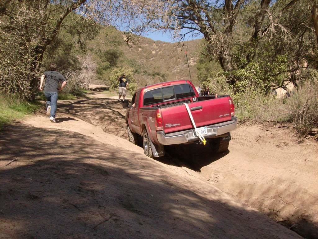

    Killer Red Taco
    Killer Red Taco NorCal Rock Whore
    Aug 25, 2008
    #8749
    1,748
    Whatsurname
    BFE–Norcal
    007 Tacoma A/C TRD O/R Impulse Red 4x4
    Bilstein 5100 on front at 1.75 setting • 5100 on back• K&N Air Filter• TRD Seat Covers• Day Time Running Lights• Foglights Anytime• Hella 500 lights in grille• Rear TSB Springs• Alternative Locker Mod• CB and 4 ft firestick II• Billet Grille• Kid puke in the back!• 265/75R16 Goodyear MT/R• 16" Devino wheels• Hose Clamp Mod• Revenge Fab Sliders• No Sway Bar• A Hottie as Copilot
    I put mine on the back of the center console by the cup holders. That back panel pops off and is strong enough to hold the cb. I ran the antenna wire trough the floor in one of the rubber plugs, I cut the plug and fit the cable trough it, and then came under the carpet and out by the seat mount.

    Killer Red Taco
    Aug 25, 2008
    #8749
    1,748
    Whatsurname
    BFE–Norcal
    I got a 4 ft firestick it mounted on my bed rail and it is tall.

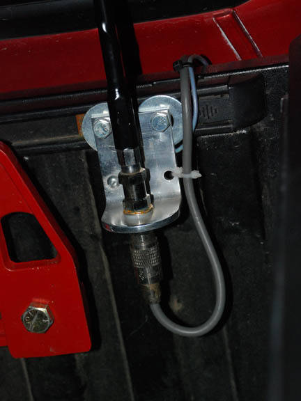

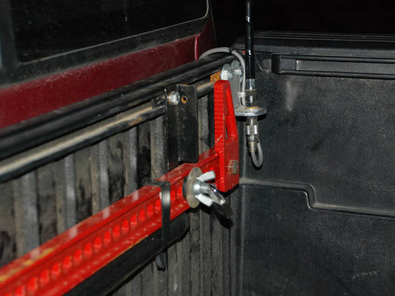

    Killer Red Taco
    Aug 25, 2008
    #8749
    1,748
    Whatsurname
    BFE–Norcal
    My CB location
    Firestick Mount: I used a simple Aluminum 90 degree mount and used a couple of pieces of flat steel 1 inch by i inch with a 3/8 hole drill into it and a 3/8 nut welded to it and put those in the rail and used 3/8 bolts to mount it. I have the washers to to keep the top of the mount form being pulled into the rail. And used the extra hole to attach a ground wire the truck frame.

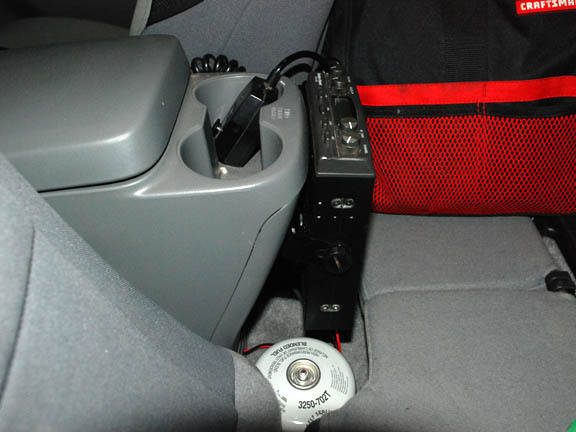

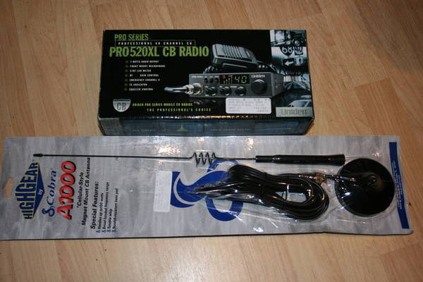

    4x4Runner
    4x4Runner Sam’s gone, man. Moderator
    Sep 9, 2006
    25,216
    Drunken Sailor
    Not north, not south, not west, mostly east
    1WD
    nuttin fancy
    I went with a Cobra 75 WXST, in this thread. Badass unit albeit the PA function. Does have an output for an external speaker though. I had a Uniden Pro 520 for the Tacoma with a Wilson magnetic mount antenna (still have). Worked great but for the FJ I went with this little set up, I later upgraded to a 4' Firestik
    Best advice I have is get a SWR meter and tune your antenna or have it tuned by someone with a meter.
