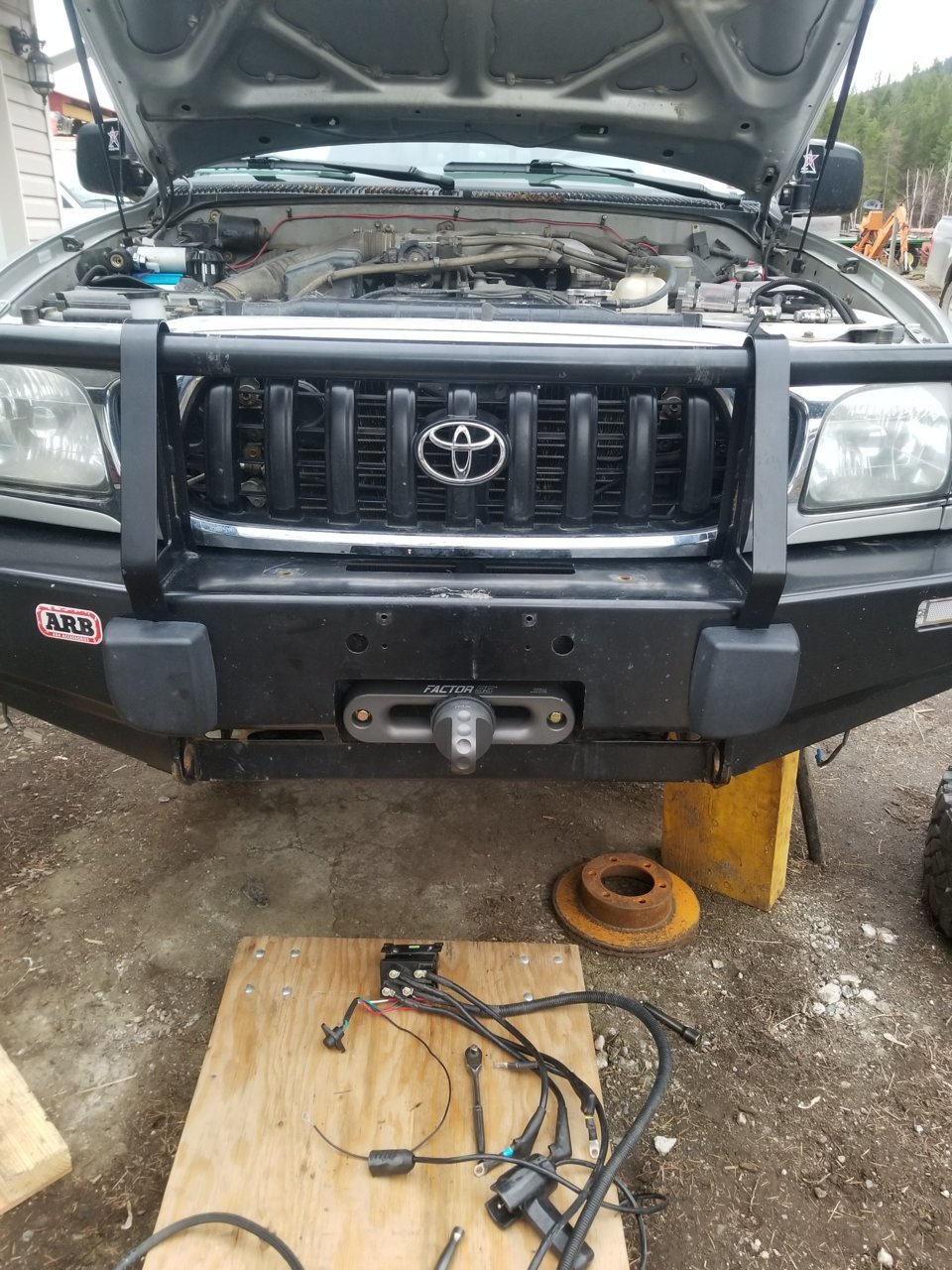

    Any updates?
    Got my Pro Link and 1.5" fairlead installed.
    cbechtold[OP] likes this.
