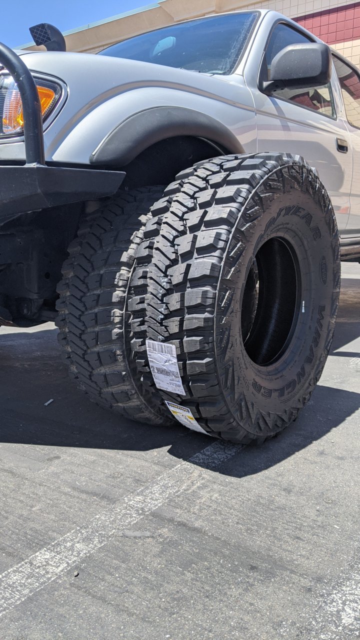

    Well I've got 3 (maybe 4) weeks until I start cutting. Tires arrived today at work. UCA also arrived a few weeks ago. I've got a few things to do this weekend, and then I can get this project rolling.

    What’s the size
  8. May 7, 2021 at 8:43 PM
    #2108
    cbechtold
    cbechtold [OP] IG: @corybechtold
    Jan 19, 2014
    #121010
    3,982
    Cory
    Pleasanton, CA
    2001 DCSB SR5 TRD 4x4
    315/75r16
  9. May 7, 2021 at 8:45 PM

    Are you tubbing?

    If he wants to be able to wheel he is. lol

    Nah, just adding a 12'' body lift.
    Yessir. Fully tub'd lock to lock at full stuff. Doing it right the first time around.

    Pull your bumps as well as the coilover. Then go at least 3/4" bigger then you think you need to. You'll have it right when you cut right next to the door hinge. It's a lot of work but it is worth it the moment you get into the big rocks.
