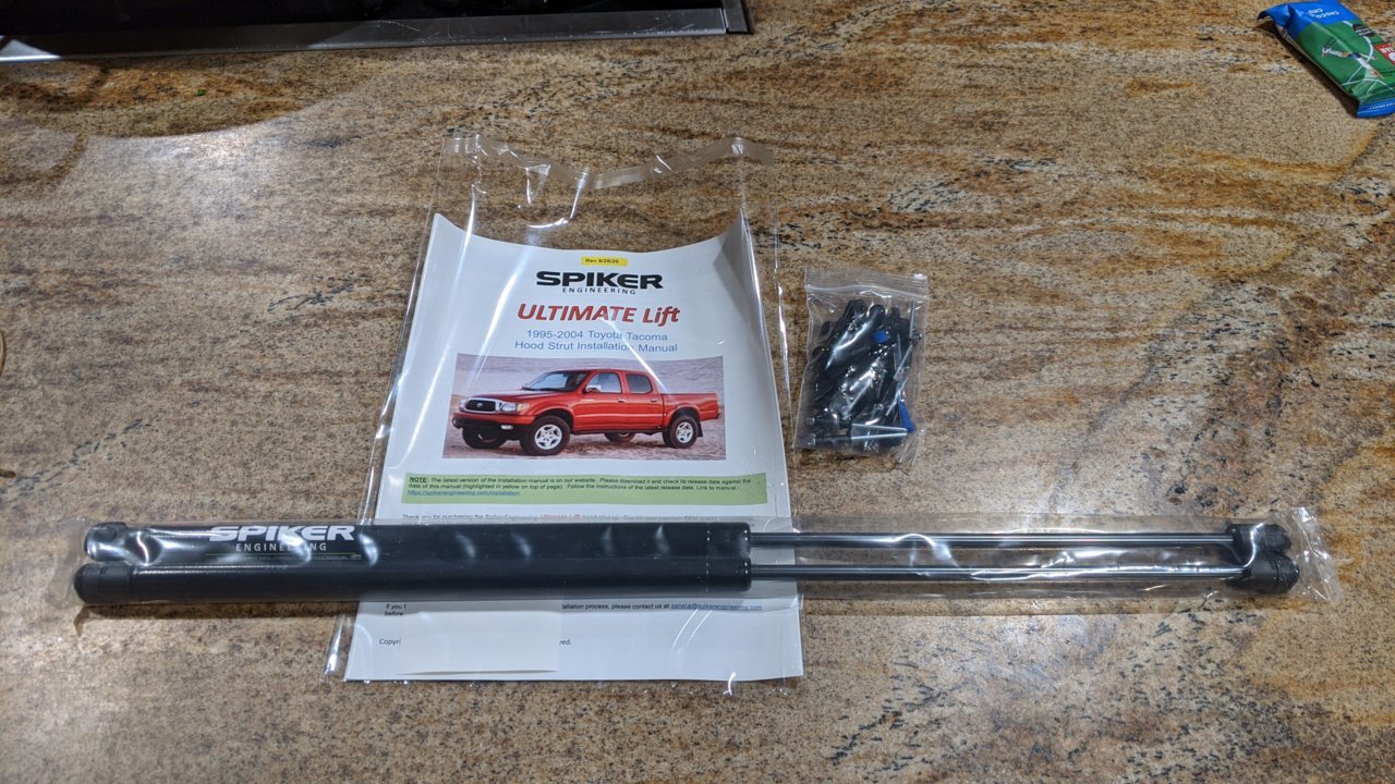

    Not 35s related, but I broke and bought hood struts for the truck. So tired of the hood prop.
