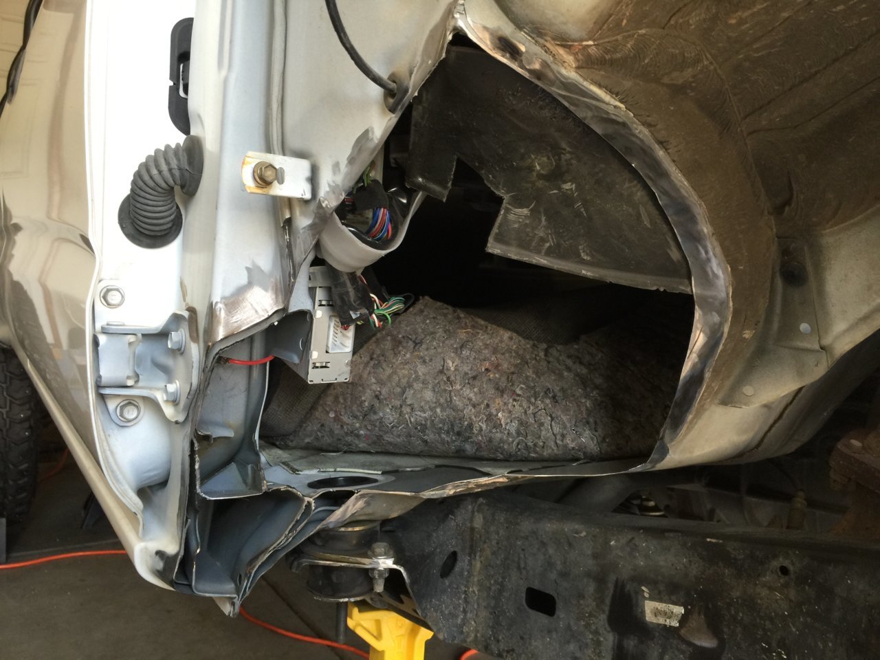

    Tubbing has begun. I definitely underestimated how much I would need to cut. Here's how the passenger side came out.
    IMG_6369
    by Cory Bechtold, on Flickr
    IMG_6370
    IMG_6371
    Going to basically copy what I've done for the passenger side on to the driver side. Should take significantly less time than I spent today, but I'd rather take my time on something like this since I truly don't want any rubbing at full bump from lock to lock.

    Yep. Does look similar. Only thing I rub on is the frame and body mount on the driver side.

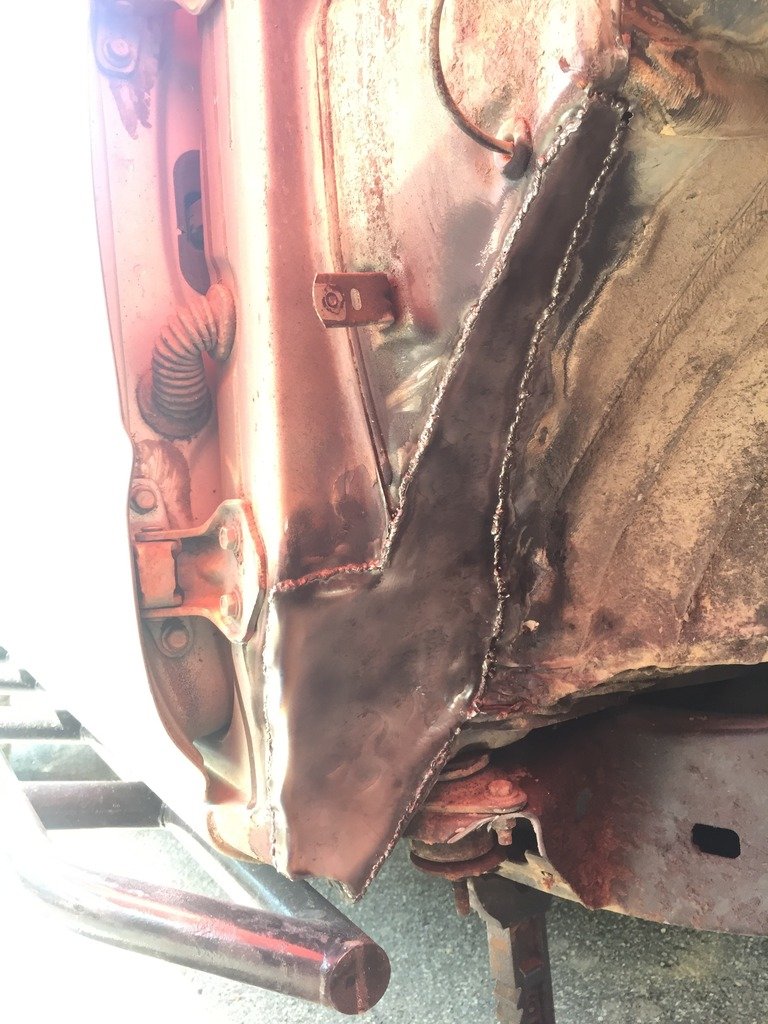

    Drive side got cut up today. Only place it rubs is the body mount, but that's only at full lock, so I'm just going to run it instead of cutting more.

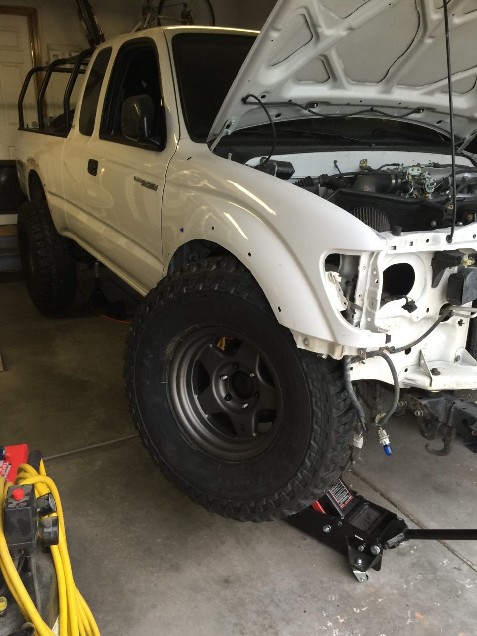

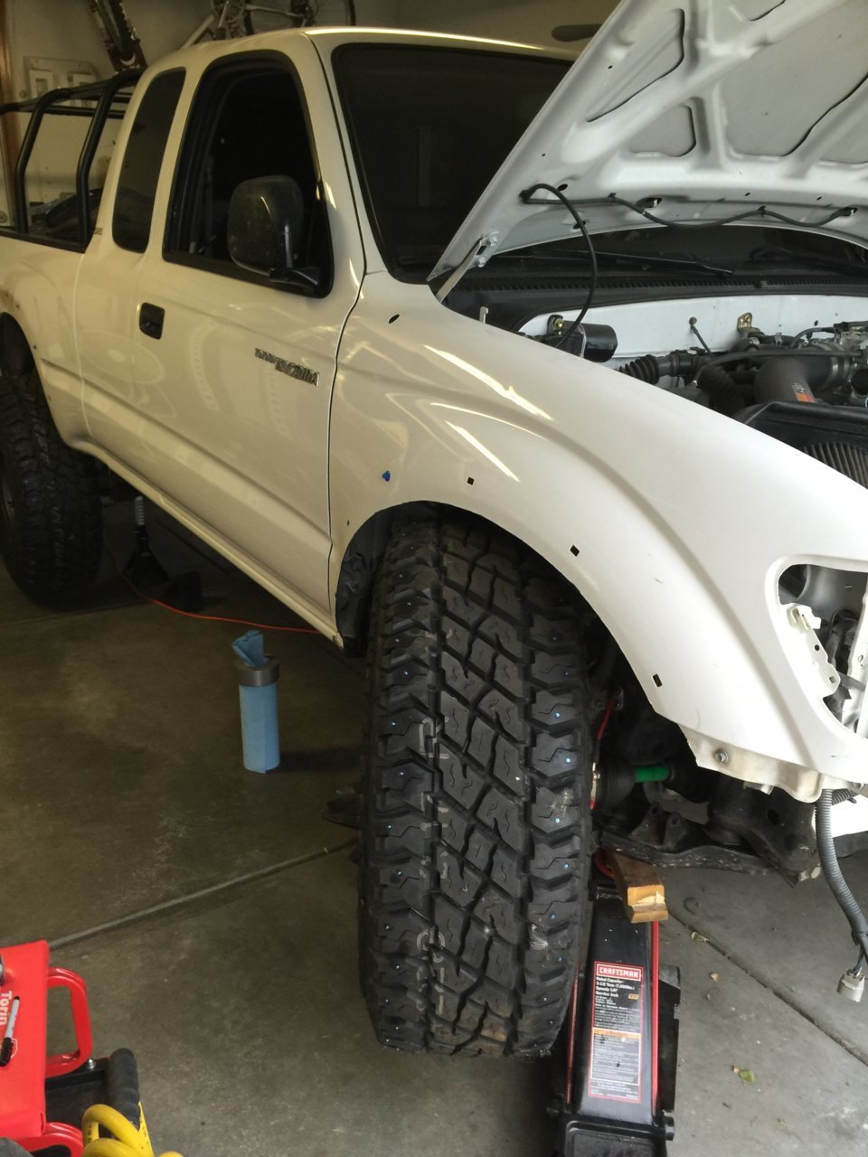

    I also had a few spare hours left before I wanted to clean up so I cut my front fenders. Took about 1 3/4 inches out of them and did some mild trimming here and there to accommodate the tire.

    Next weekend I'm hoping to get everything patched up enough so I can start sealing. I have a little time on Thursday after work so I might start making some template for sheet metal.
