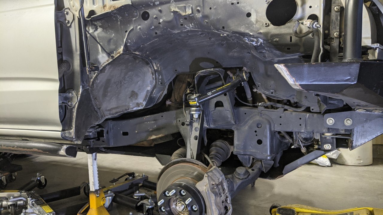

    That's what I ended up doing. Making a template worked pretty well for at least having the general shape. One of my dad's friends recommend that I use a blanket and hammer to form the sheet metal which worked pretty well to my surprise. Low and behold, I made it a 1/2 inch too big all the way around. :anonymous:
    I got it tac'd in a few spots and then proceeded to shave metal off and press it into place with a BFH.

    Well, I got a good chunk of the work I wanted to do yesterday. Passenger side is completed. Driver side I want to re-do a few welds that I'm not happy with, so one would think that one more weekend should do it!
    No fancy camera photos because it was 9PM and I just wanted to sleep.

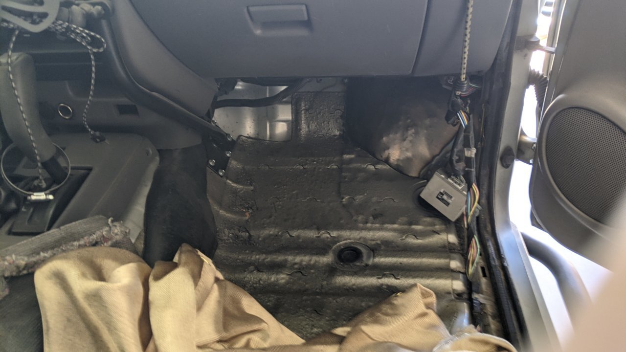

    Throw a pic of inside the cab?
    I haven't done one of these yet, and I've seen varying degrees of the interior pulled...

    I pulled a lot out and pulled the carpet and most things flammable back a good 2 feet.
