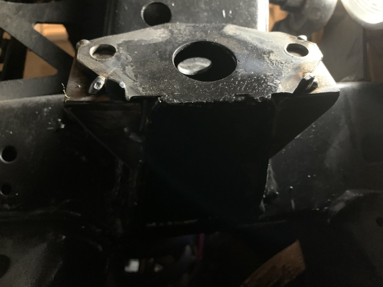

    One thing I want to do when I replace my engine is replace the motor Mount perch things.
    My driver side one is broken. I used a ratchet strap from the engine hook to the frame for now. It’s been working for awhile now.

    I'm planning to beef up the motor mounts and possibly get a set of poly motor mounts.

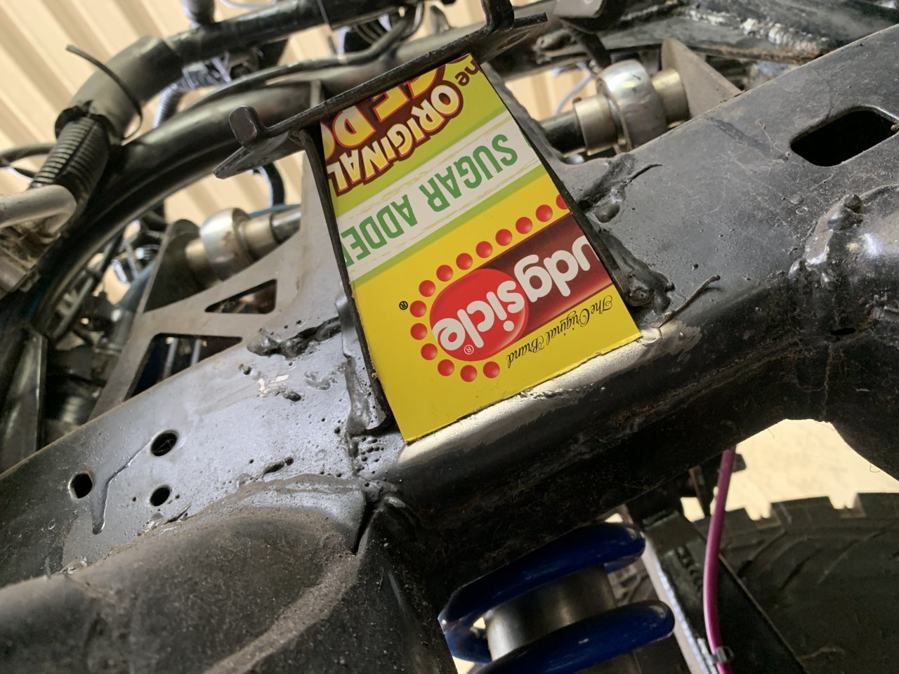

    So you can buy @Bonzen 's solid (poly) motor mounts (Solid Offroad on IG) or any other style (TG "Bombproof" etc.). That only reinforces the removable engine side motor mount, but the perch typically will also be a point of failure. That's where it can be boxed in or replaced altogether - DMZ makes a beefy replacement. I chose to box in the bottom with 1/8" and will bend a diamond shaped scab plate to go from the bottom of the frame to my boxed in gusset to further reinforce it and am adding some 3/16" angle iron to the reinforce the ears - that's what I showed here:

    Most common place. Zoom in on my avatar and you’ll see another one.

    That's what I've been reading. Local Toyota dealership has them instock, but at $1100 a piece. I'm going to talk to the guys at Main Machine tomorrow and see if they'd recommend just swapping the 1 out, or swapping both out.
