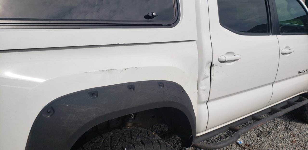

    I had bushwackers on my 1st gen and loved them, so I didn't think twice about putting them on my 3rd gen. As far as durability of the flares, I had my truck pinned against a rock and pushed in my door, c-pillar, and fender, but the flares only had superficial scratches. I actually suspect they kept the fender damage from being worse.
