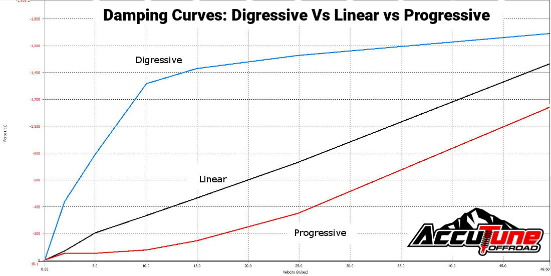

    What made you decide to go with hydro bumps? I think it is definitely the right way to do it for running fast with IFS but how most Tacomas are setup the bump limits close to half of the wheel travel. I feel like this would hurt crawling and wouldn’t allow the shock to work to its full potential when going fast.
    Some other guys talk about using low profile rubber bumps to hinder less of the travel. Maybe there is a way to setup the bump stop in a place that limits the wheel travel closer to 1:1 but I can’t think of any good ones.
    also doesn’t look like there are any hydro bumps less than 2”

    You can just make spacers to limit the bump to say 1", so it'd only be in play for 2-3" of the last travel or whatever the actual number would be. Camburg does a slapper arm setup for these Tacomas now which makes the ratios closer together, pretty neat.

    Can you setup the pressure high enough in the bumps then I assume to only use 1” to effectively bump the travel of the a arm if it is spaced out?
    I feel like the travel would end up really stiff for the whole 1” of available travel if it is set to compress a max of 1” but I can’t claim to fully understand hydro bumps.

    It would be very stiff then if you only use half of the stroke via higher pressure. Gotta remember the front has a motion ratio. If the bump was mounted inline with the front coilover, it would roughly be half as soft as if it mounted on the rear end of the truck, where the motion ratio for hydros in the rear is 1 to 1.
    In the front, it depends on how far out the bump is mounted. 1" of stroke at the bump could be 2-4" at the tire

    I was thinking more in relation to have the bump stop appropriately stop the suspension from compressing too far the hydro bump would have to be at very high pressures since it would still have an inch of shaft travel left.
    This would hit really hard when you first touch the bump. Since they are progressive (I think) it would only be using the first half of this graph so it wouldn’t be a smooth ramp, rather a big jump when you first hit the bump then a slow rise.

    The idea is that with correct valving and pressure in the bumps, I can still get full travel out of the suspension while retaining full bump and bump stop usability at speed. I'm also running very soft springs compared to most people are running.
    If I have to, I can shorten the bump to 1" of travel which would help for crawling, but definitely would hurt fast speeds.
