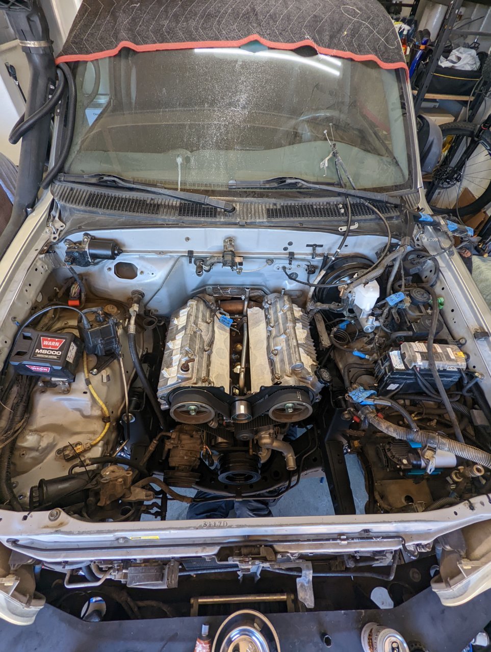

    Been a minute. Engine is basically 90% done at this point. All the new new parts are installed and I'm basically ready to fire her up here shortly. Still have a few minor things to get around to as well as the heater core to do, but that's going to be a couple days to get done.
    PXL_20220911_232450002
    by Cory Bechtold, on Flickr
    I've got a vacation from work coming up here, so I'll be putting all my focus into the rear suspension. The goal is to have everything fab'd up so I can paint and work on the heater core while I watch paint dry.
