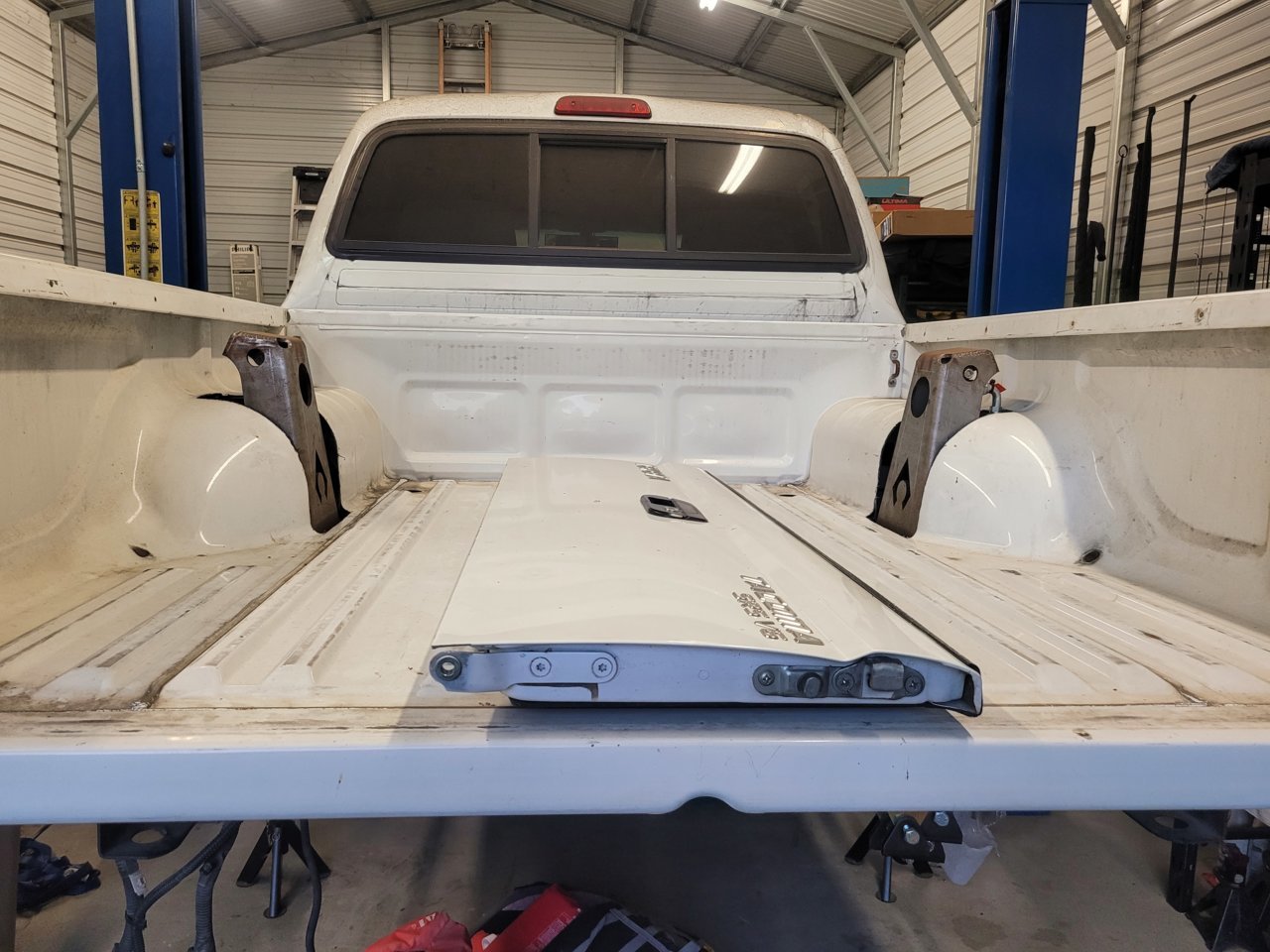

    Packaging mainly. I have no interest in moving the gas tank at the moment. I've seen a few people already link the rear of Tacomas the way I want to do I don't think I'll have many problems outside of the few short coming of not going with a traditional 4 link to relocating the gas tank.
    Just rough measurements put the top eyelet of the coilovers about an inch above the bed line, so I'm happy with that. Notching/boxing the frame is going to be a must.

    I went with Fox 2.5x14 and the towers protrude through the bed. I didn't notch the frame but pushed the lower mount as far outward as possible and it just clear when stuffed and droop.

    IMO, it should be flush with the bed side if OP plan on running 16s. But lower CO mount location will also affect placement.

    If it were my truck I wouldn't want it coming into the bed at all, but that's difficult to do when you're shooting for large travel numbers
