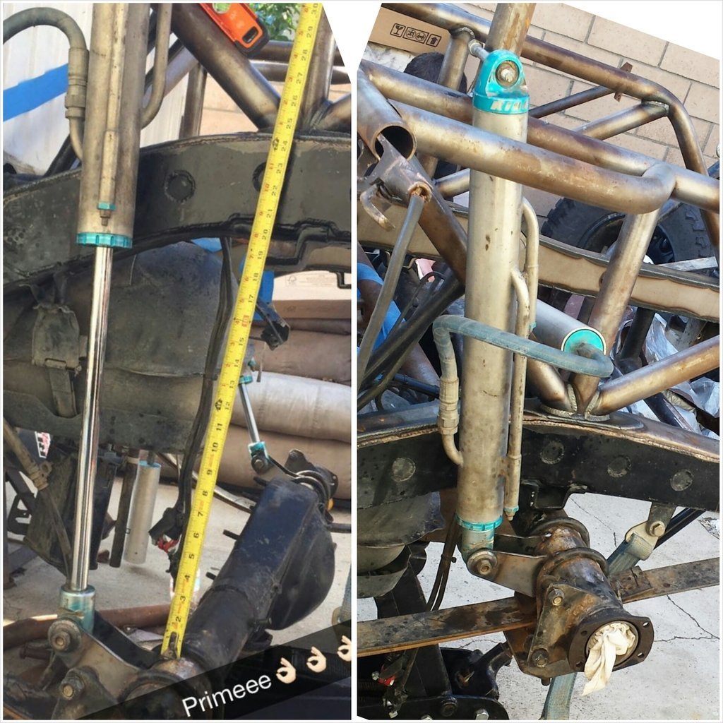

    Few more moving parts but not much more than a traditional linked setup.
    https://www.instagram.com/p/CSu4k4Rp8Ze/
    My truck has a leaf sprung setup but the components are about the same.

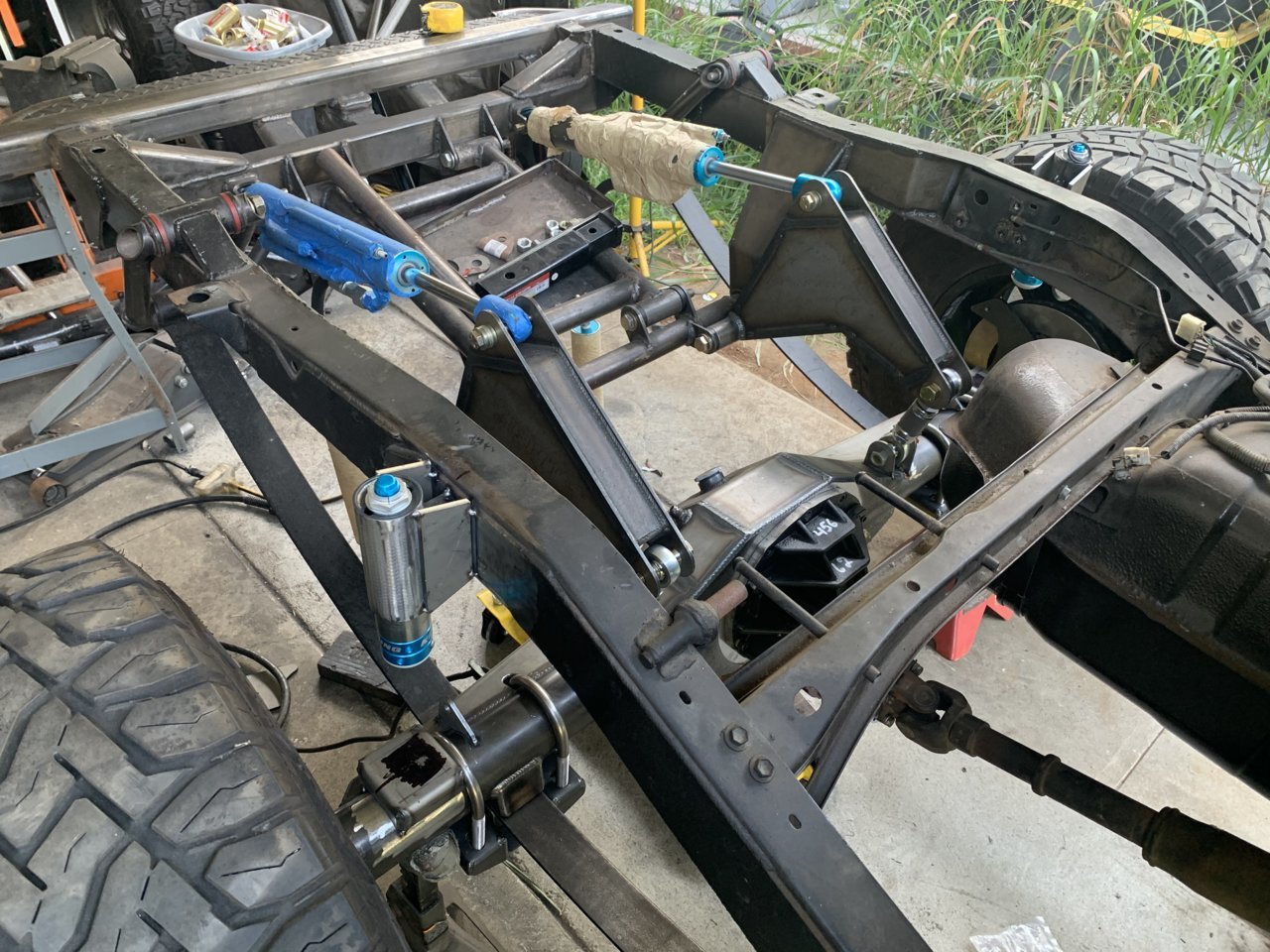

    It's going to be close, but I think it's doable. One of the guys I met when I ran the Tacos on the Rubicon makes me think I can do it as well. This is his setup out back.
    https://www.instagram.com/p/Cv-mx-8AxYj/
    I dig it. If it wasn't for the extra complexity and extra moving parts, I'd probably be looking at doing that under the bed as well. Definitely helps keep the little bed space we have still available.
