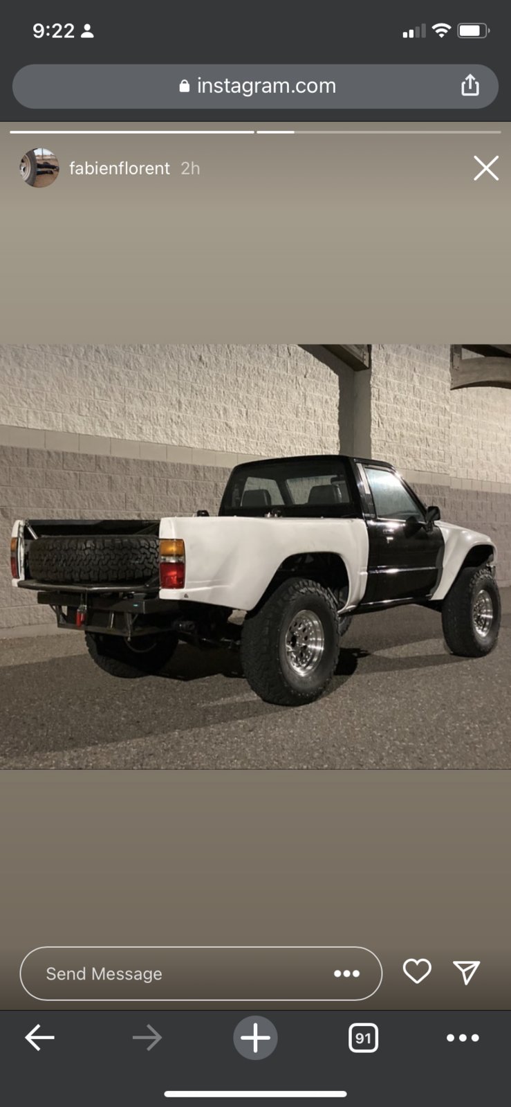

    If you have Instagram give @fabienflorent a follow or he’s on here occasionally as @Happysmiley and will be a good source of info!
