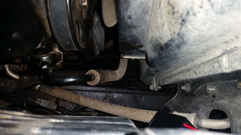

    Question for you @cbechtold , how did you get the top pvc piece on your washer reservoir to fit between the frame, radiator, and power steering hose? I can't seem to make enough room between it to fit...
  15. Jan 7, 2016 at 5:32 PM
    #475
    cbechtold
    cbechtold [OP] IG: @corybechtold
    Jan 19, 2014
    #121010
    4,034
    Cory
    Pleasanton, CA
    2001 DCSB SR5 TRD 4x4
    Very carefully... :cool: jk
    I'm actually touching the frame, the power steering hose, and the air filter box... If I were you, pull your skids off and push the vertical piece through the bottom first then pull up on it until it's level with the air filter box... and probably the fan housing... but that's okay since nothing is absolute danger. After that, then you can mess around with the horizontal piece which you can either put above or below the hose that connects to the radiator. The only thing I recommend is that you probably zip tie the wires/hose for reservoir bump away from the engine belts, they get pretty close and I would hate for something to go wrong.

    Haha yeah, I just had to use a bit more pressure to get it to slip between all of them. Now my issue is that there isn't enough room between the bottom pvc piece and my skid plate to fit the washer pump....
    Think I'm going to have to get a couple different pvc pieces and just run the single vertical pipe...
