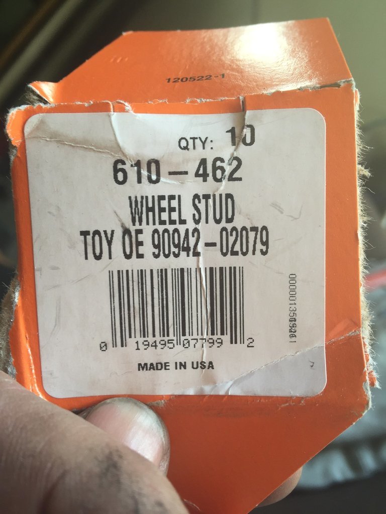

    Thanks man! I think I am going to go for a custom DIY bumper, probably from Relentless. My cousin owns a metal fab shop in San Carlos (I see you are super close to me, I'm in Oakland) and he agreed to help me with the build.
    Another question that I had, did you have any trouble with your 15" wheels? My current wheels (OEM) are 16" but I figured I could save a bunch of money buying new 15" wheels instead of 16" (not to mention R15 tires are cheaper than R16). I was about to pull the trigger on some from Desert Rat but then I started reading that people where having to grind their brake calipers in order to get 15" wheels to fit on trucks that came stock with 16". Did you have to do that or is it a non-issue?

    The only issue with the 15" wheels are that they rub on the front brake caliper if you don't use a 1/4" spacer. 1/4" spacer make you able to run the 15s in the front, but you'll also have to get longer wheel studs since the OEM ones are just slightly to short. I forget what length mine are, but they're like 5mm longer then OEM. You can get all of that either from Wheeler's Offroad, Rock Auto, Summit Racing, etc... They're everywhere lol Other then that, you don't have to worry about the rear with the 15s. Clear the front brake calipers and you're done.

    Dorman wheels studs from rockauto - part number below...
