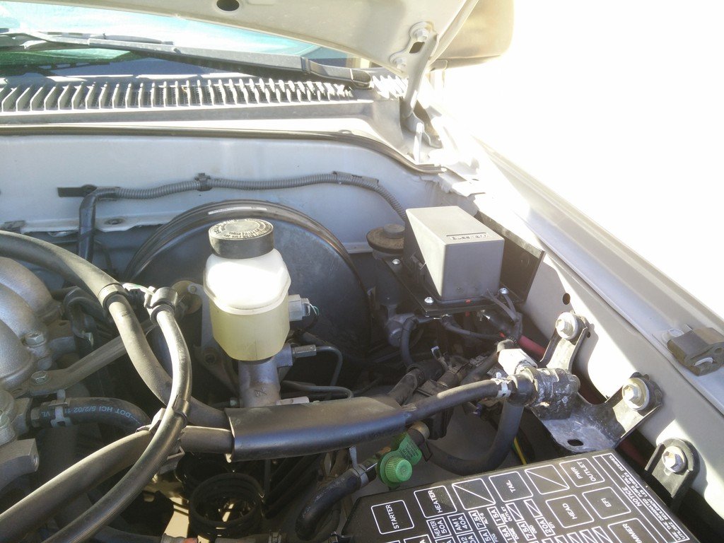

    On top of the OEM fuse block seems like that is one of very few places where we could put it. I though originally that I would be putting it behind the backseats in my truck, but running 30ft of 0 gauge wire, from the battery to the back of the cab, doesn't seem like fun.
    I'll also agree with Brent. The Bussmann might be better option since it's smaller. Only reason I went with a Blue Sea System is because I got a smoking deal on one.

    Blue sea is cheaper....from what I remember. Brent, how do you get to the grommet with the box right on top of it?

    Just unbolt the bracket and set it to the side. It's just one bolt and I have plenty of slack in the wiring to fit my hand beside the grommet. Haven't needed to get back there since I installed it but one time.

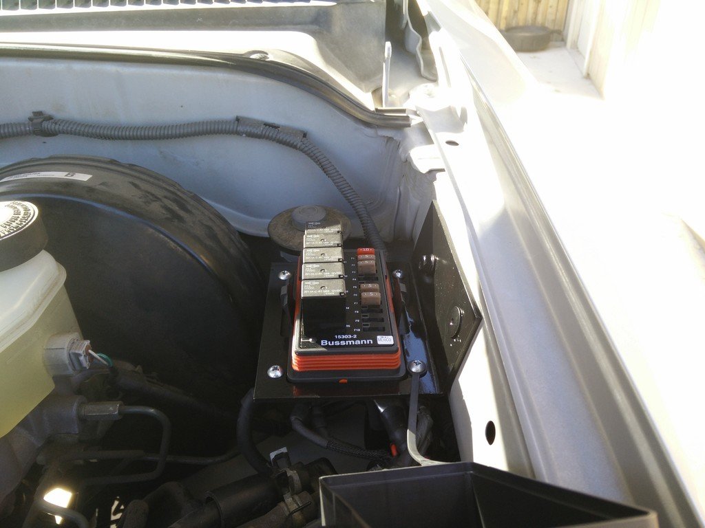

    Aux fuse block is wired.
    Aux Fuse Block
    by Cory Bechtold, on Flickr
    For the most part, front lights are wired. The switch panel has a coat of paint on it. Need to wire the switch power/ground and then just make everything look clean with some wire loom. Should be done tomorrow.

    Auxillary fuse block is hooked up and working.

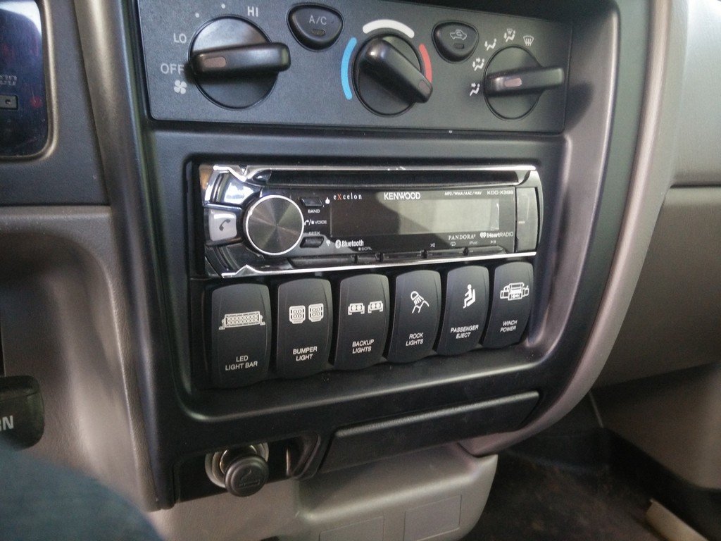

    Switch panel looking super clean!

    @paranoid56 Thanks for making the switch panels! Cleaver place to put them and super clean. Love it! :thumbsup:
