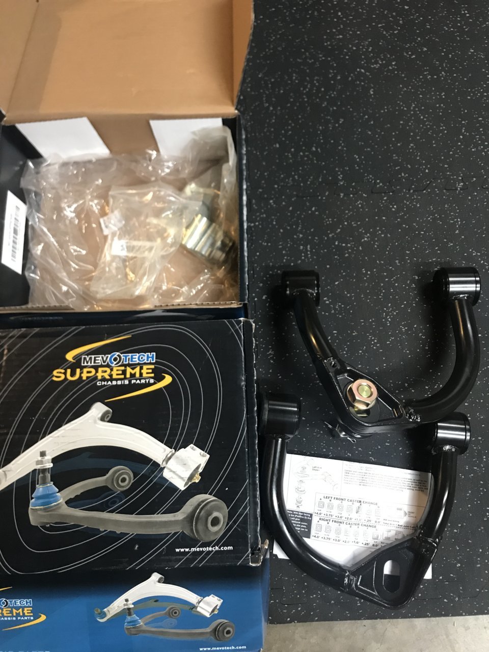

    Nice. I hope you love it just as much as I love mine!
    :thumbsup:
    If you're keeping the rig on IFS, it makes sense, but I'm not about to spend 5/6/700 on UCAs when I'm looking SAS later on down the road.
    I never got install instruction, but hopefully this has been resolved by now. I'd be glad to answer any questions if you still have any.
