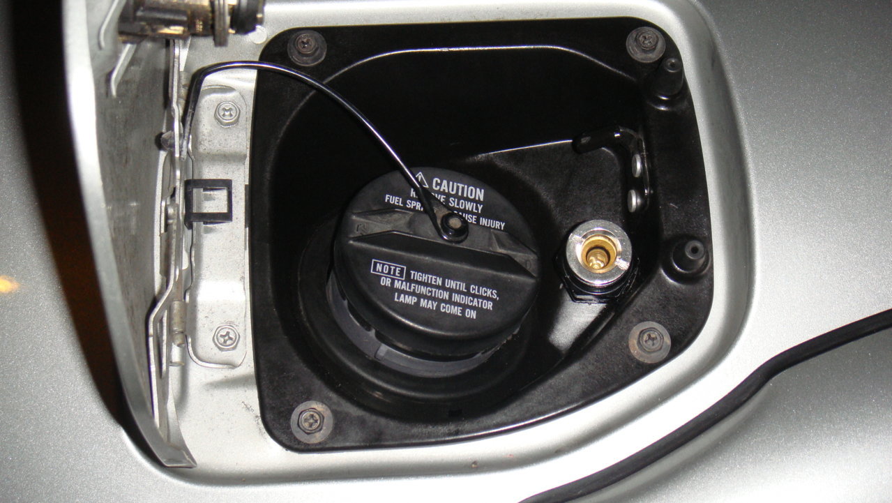

    Nice... now plumb the fitting to the fuel neck area so you don't have to lift the hood. Works great.
  6. Jan 2, 2020 at 8:08 AM
    #1646
    BYJOSHCOOK
    BYJOSHCOOK Mr. Mojo Risin
    Jun 9, 2013
    #105887
    27,915
    Josh
    Woodstock and Alpharetta Ga
    2000 SR5 4WD Lunar Mist
    Check Out My Builds
    That's a good idea, my buddy has one in his front bumper and in the rear bumper. But I like this since it's out of the elements

    Thought about it, but I don't mind popping the hood to air up if needed. I won't use it often to air up thought. Going to get a 20lb CO2 tank eventually to be my primary source of air.

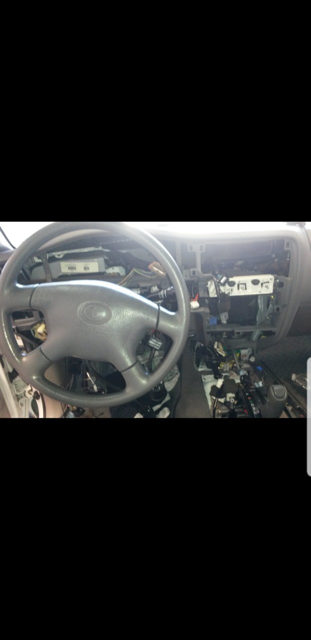

    Are you sick of ripping the dash open yet?
  13. Jan 2, 2020 at 12:48 PM
    #1653
    cbechtold
    cbechtold [OP] IG: @corybechtold
    Jan 19, 2014
    #121010
    4,033
    Cory
    Pleasanton, CA
    2001 DCSB SR5 TRD 4x4
    Nope. I gotta rip it again whenever I feel like adding rock lights or a fast charge usb hub or when I actually get air lockers and have to wire the switch for my rear locker to work with the compressor :bananadead: this shit never ends
