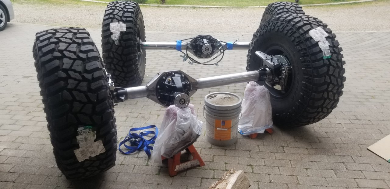

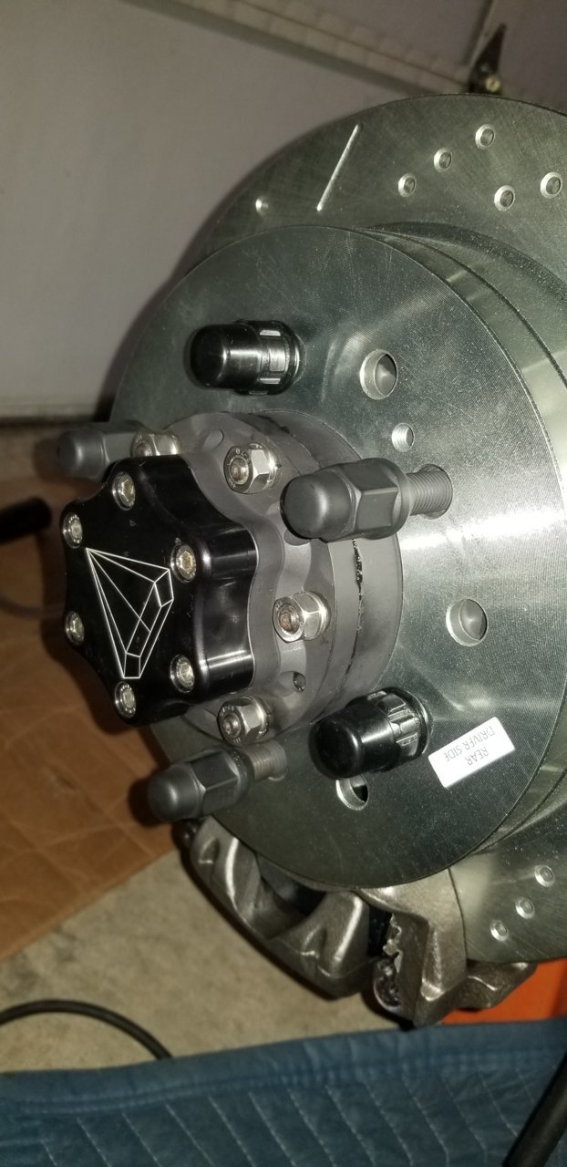

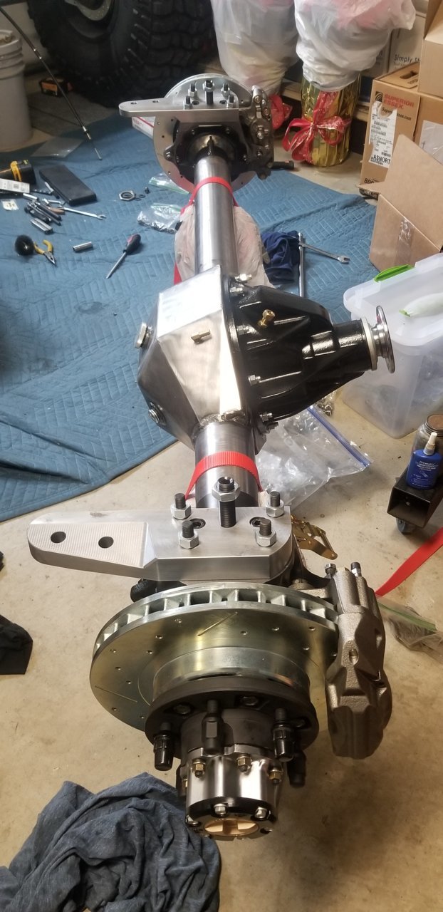

    02hilux
    02hilux What do you mean there’s no road, I’m here
    Sep 14, 2016
    #197244
    6,193
    Planet: EARTH
    Might not be ton, but i can't stop looking at them. I call these "Toyota's 1ton" :rofl:
    Both are Diamond axles. RCVs, Hell Fire knuckle and FF rear with Diamond drive flange. Both are mated with LC 9.5 centered, 5.29 and TJM prolocker in both. 69wms, monster beadlock with 4dz.
    :spending:
  19. Apr 2, 2020 at 6:23 PM
    #1699
    JasonLee
    JasonLee Hello? I'm a truck.
    May 9, 2014
    #129454
    12,177
    Jason
    Q322+3C Denver, Colorado
    15 TRD OffRoad
    TRD Supercharger and more.
    Please tell me they are going underneath that Prius in the top left of the photo.
    cbechtold[OP] likes this.
  20. Apr 2, 2020 at 6:35 PM
    #1700
    02hilux
    Sep 14, 2016
    #197244
    6,193
    Planet: EARTH
    Yep. Turning a grocery getter into a capable curb climber
