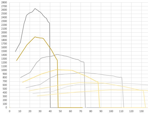

    I know I'm late to the party, but I made a spreadsheet to figure some of the gearing options out a while back.
    Drive force (basically a scalar of slug) vs speed (MPH) by gear; 5VZ Torque map with A340F ratios; 33"Tire, no Mass. No Torque converter adjustments.
    Yellow is 5.29; Grey is 4.88. IMO 500 is a good value for highway travel for a modified rig, allowing moderate top-gear gradeability, ~380 units of this scale is about what it takes to keep my truck moving at 75mph on flat ground.

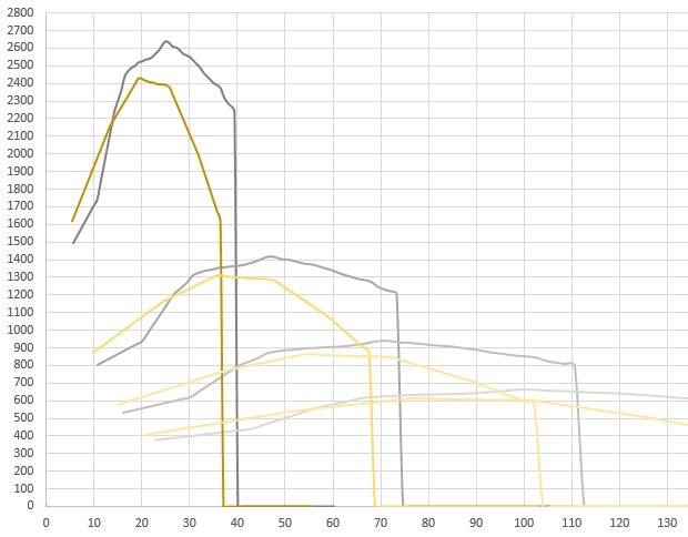

    Yellow is 5.29 again, grey is 4.88 using a tuned, Supercharged 5VZ Torque map, the Low RPM torque dip is real, but I think it is more response based and during partial throttle at low RPM, there is actually more torque available.

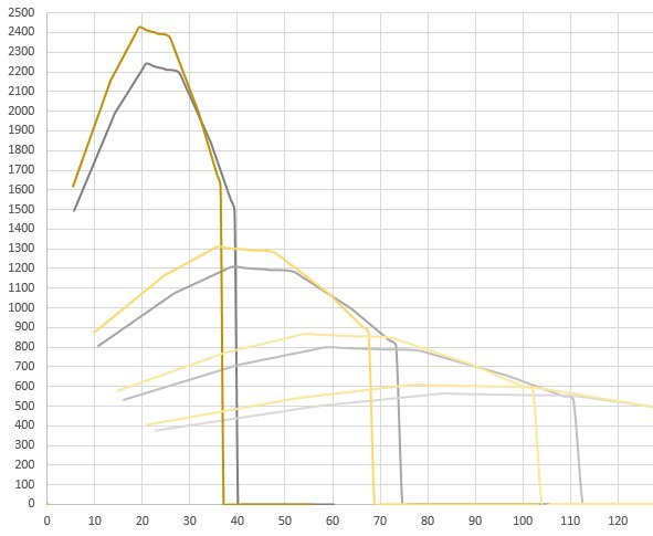

    Yellow is Stock powertrain/gears with with a 33" tire; grey is 4.88 wiht supercharged 5vz again.
