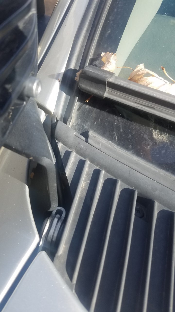

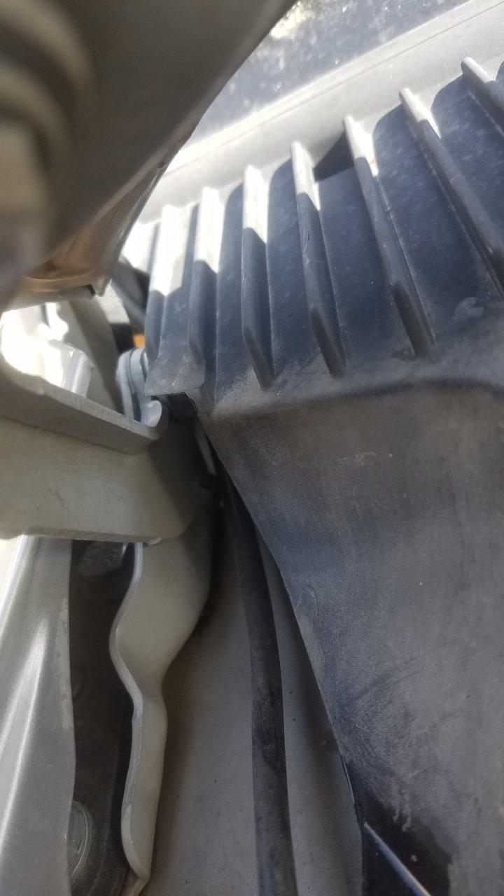

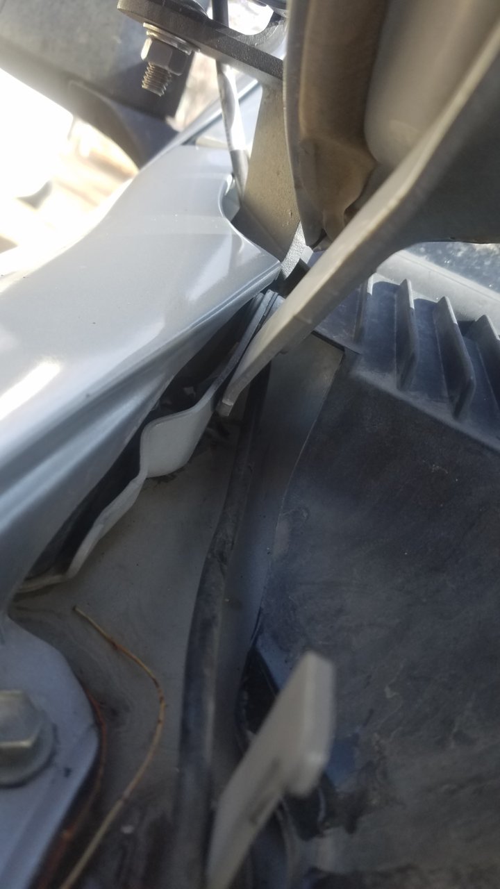

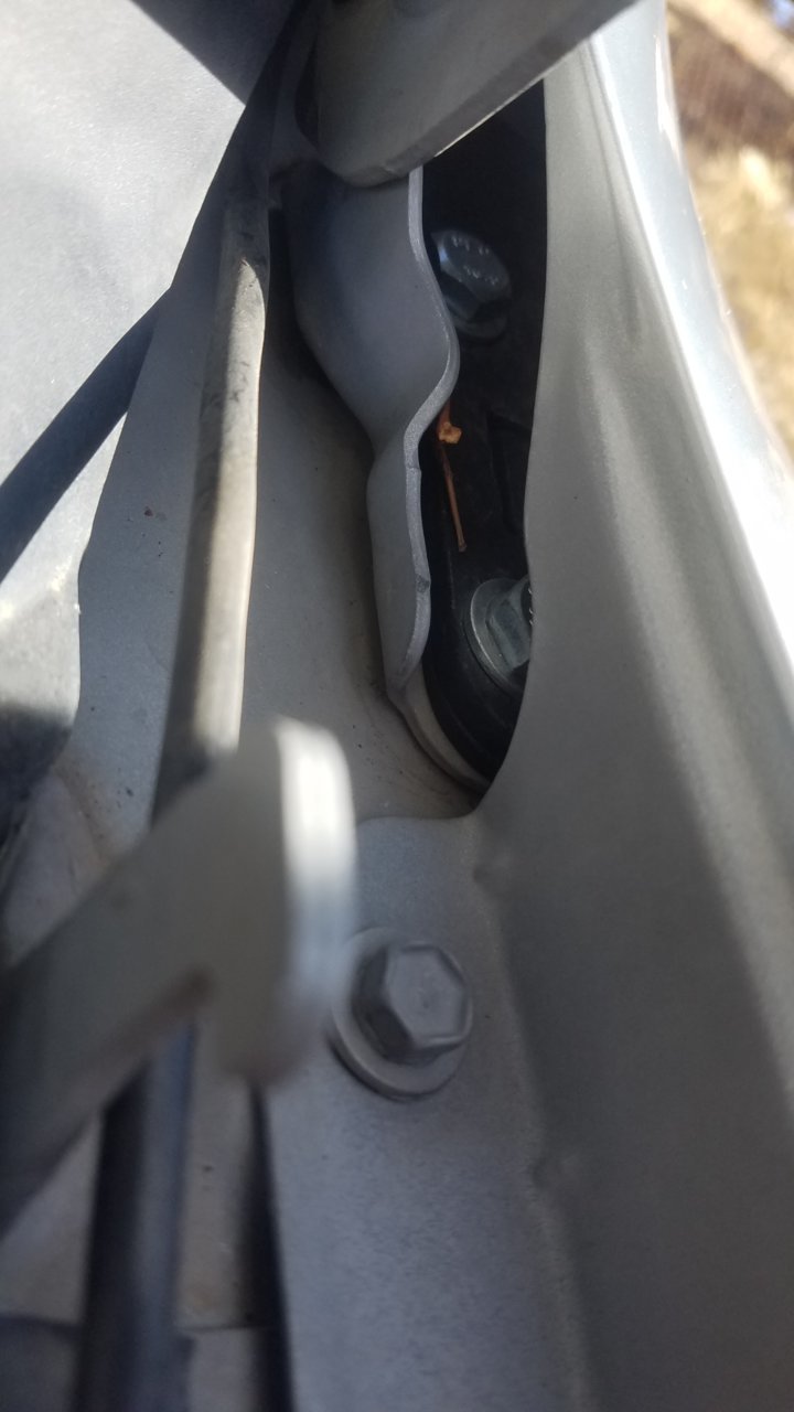

  9. Jan 23, 2021 at 2:25 PM
    ccctaco
    ccctaco Member
    Mar 2, 2016
    #179966
    19
    2002 tacoma ext cab
    Here are a few pics. It is hard to get a good shot as it is mounted under the edge of the fender. I hope this helps. It didn't take long and was not difficult. It took longer to remove the cowl to cut than to install. I had a friend help with the realignment of the hood and fender. Good luck. Chris20210123_142336[1].jpg 20210123_142505[1].jpg 20210123_142514[1].jpg 20210123_142547[1].jpg
