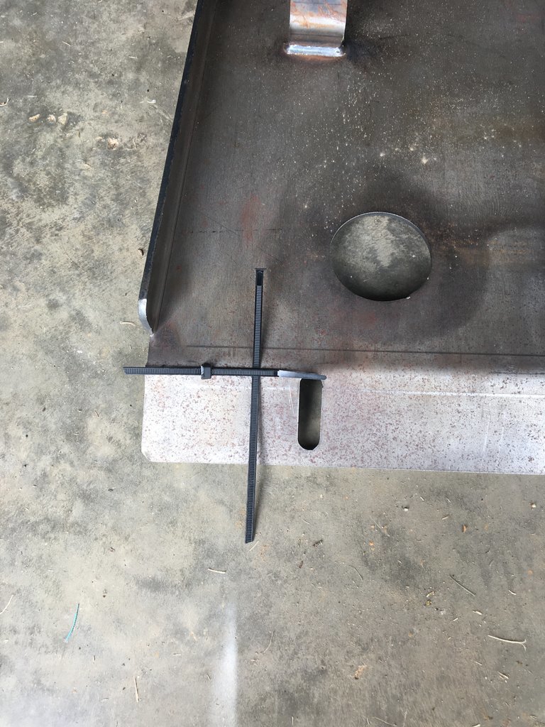

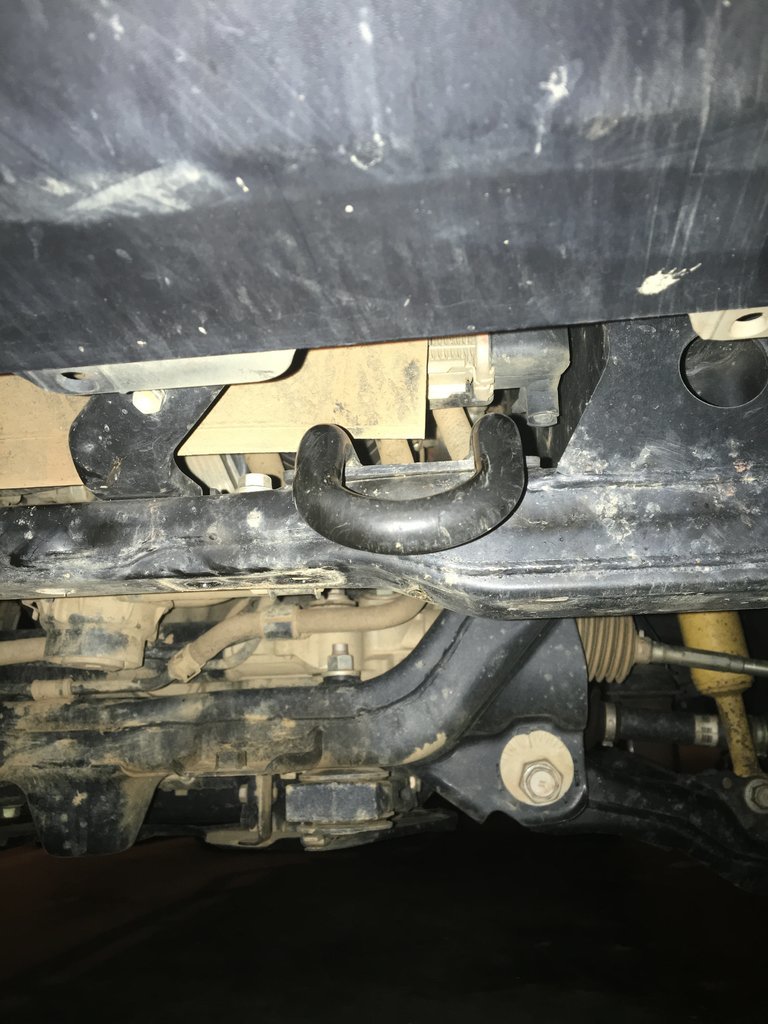

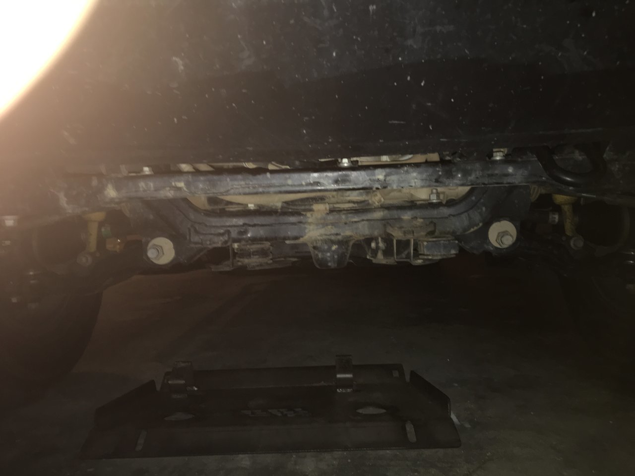

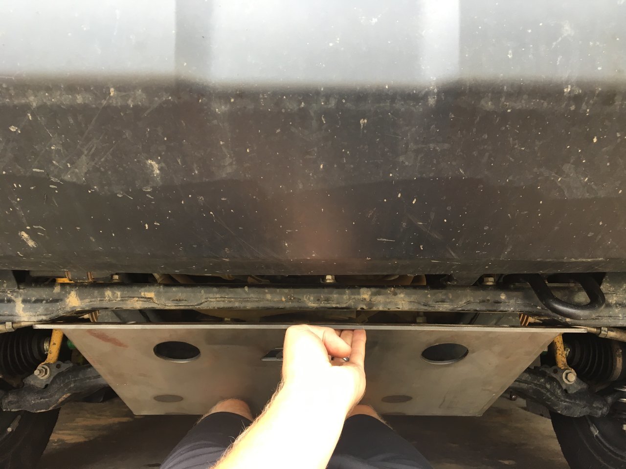

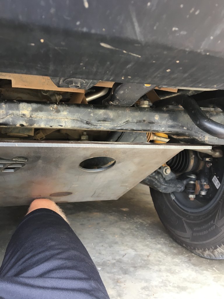

    Ok so this CBI skid is not fitting how I would like. There is about a 3/4" gap because the brace it bolts to is curved down on each side and it is to wide to fit between the curves.
    I have a couple options:
    1. Get longer bolts and use washers as spacers and let the gap be. Will that gap be an issue? Will it bend up in the middle?
    2. Cut the corner out of the lip on both sides. Will it still have enough strength around the bolts?
    Any other ideas or comments would be very helpful!!

    The skid is an old version that was purchased from our garage sale list. Our old skids only fit the 2nd gen tacos. To fit the skid on the 3rd gen the skid will need to be notched to fit the crossbar in front as shown in above post. All of our new skids fit 2nd and 3rd gen models.
    If [OP] has any questions on making this skid fit please give us a call and we can help you out.

    Yep, I notched it no problems. It is for sale now if anyone wants to pick it up!
