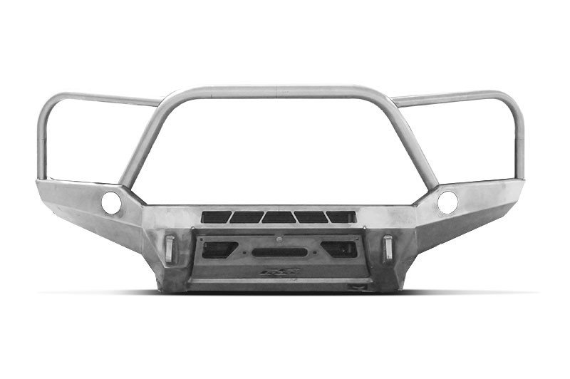

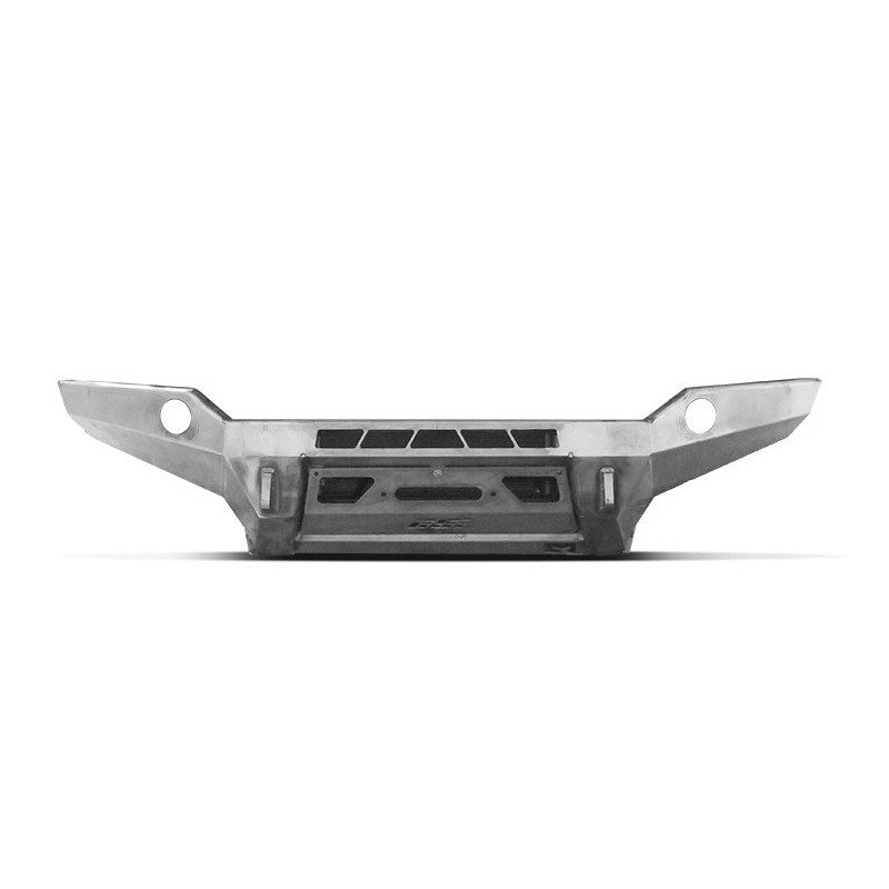

Which CBI T3 front bumper would you go with?
  1. No hoop
  2. Hull coverage
  3. Screw TSS and go with the grill hoop

    I'm looking for your thoughts, and/or experiences with CBI's T3 bumper for 3rd gen Tacomas. I'm debating between no hoop, or the full grill protection version. Being that I have a 2018 with TSS, I think the center grill guard version will interfere with the cruise control radar. My previous Tacoma's front end took quite a beating on the trail (and vs. deer), so I'm leaning towards more coverage for my new taco—but the hoopless T3 sure is clean. Thoughts?

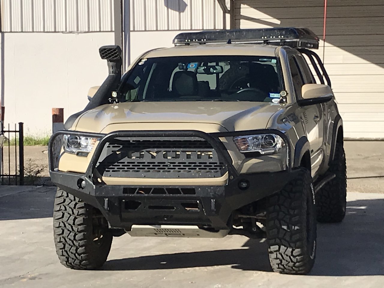

    Full hoop some different angles. 197BA329-C878-4A6A-BC09-EC3179EB7445.jpg FFF22803-1E29-4A0A-8078-A036BB712A3F.jpg C523A3E1-0C37-41D4-87BC-A261068BF381.jpg34F16C79-5BA9-46D5-A8E1-882B2AF9BC10.jpg

    Full hoops if you take her out. Others for it looking real nice.
    I'll be doing full hoops this spring to make it easier to attach limb raisers.
    P.S. @MRBOND101 very nice truck

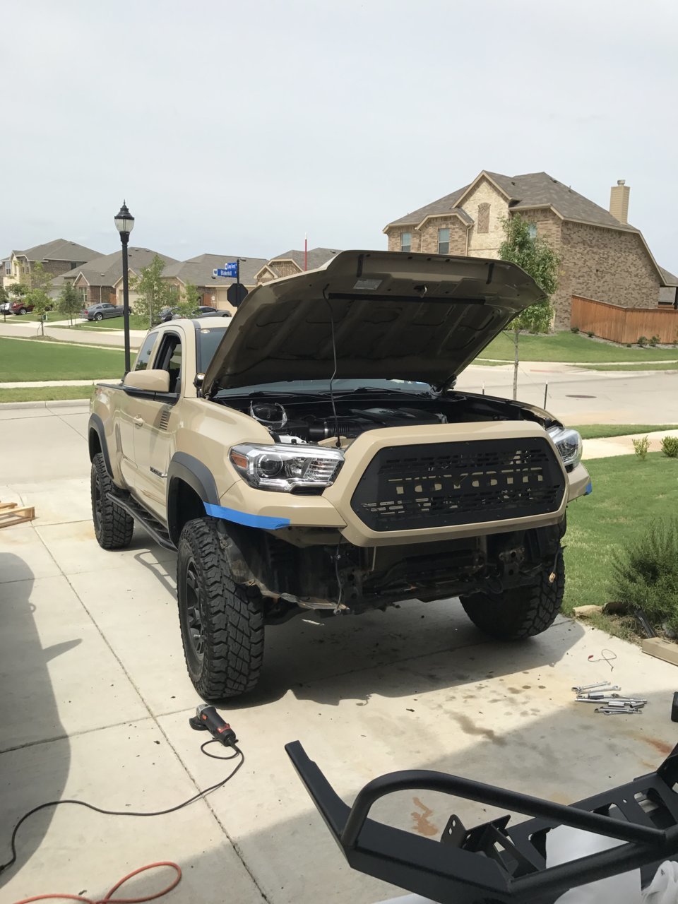

    Full hoops do look great and I like the idea of extra protection. Did you install yourself? Also curious if you had to cut the hooks off the stock skid? Thanks!

    Thank you!
    Yes I did it myself. Are you talking about the factory front recovery point? If so then no I didn’t. You can see the hook still in this picture. 9D6CF282-C3AD-4D76-8A96-540A86D3C60F.jpg

    Nice! I'm going to install myself, too. The Off Road OEM skids have small retainer hooks up front; It looks like those aren't there on the TRD Pro skids—so answered my own question. :)
