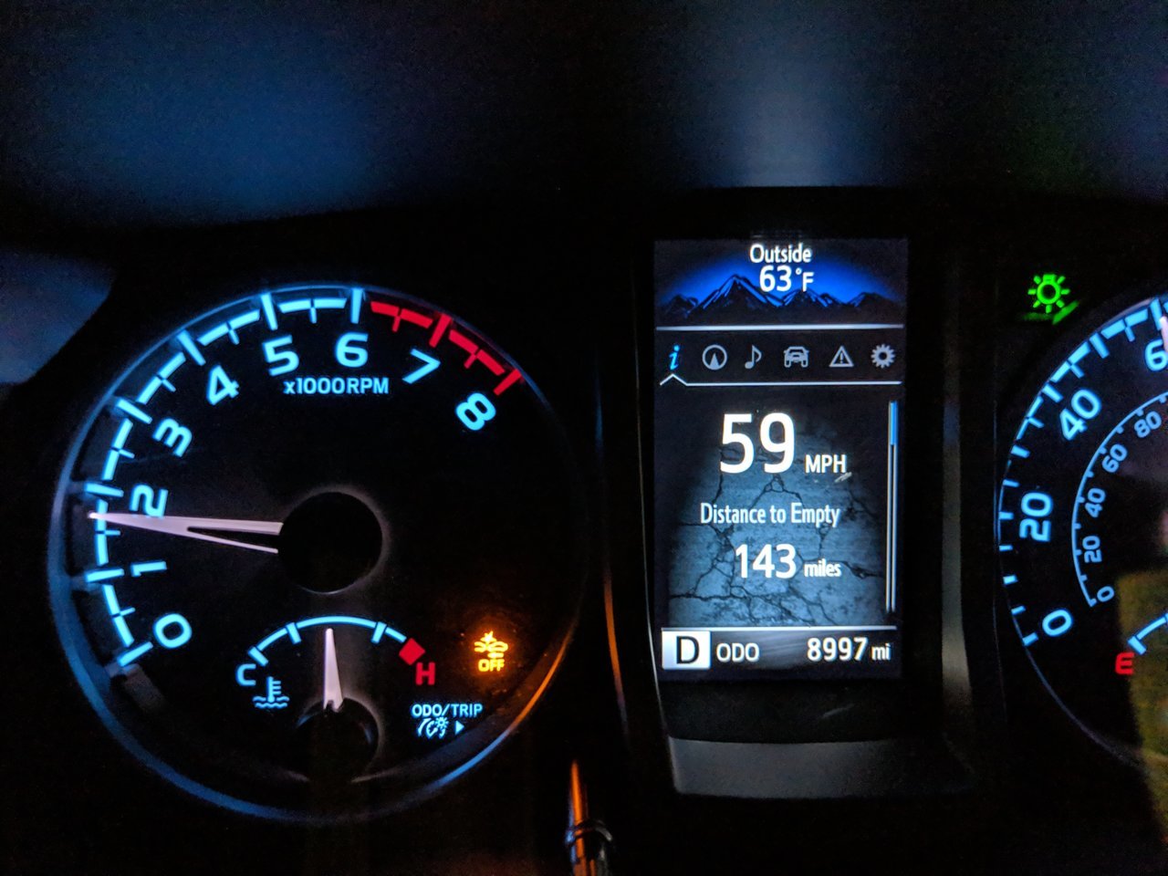

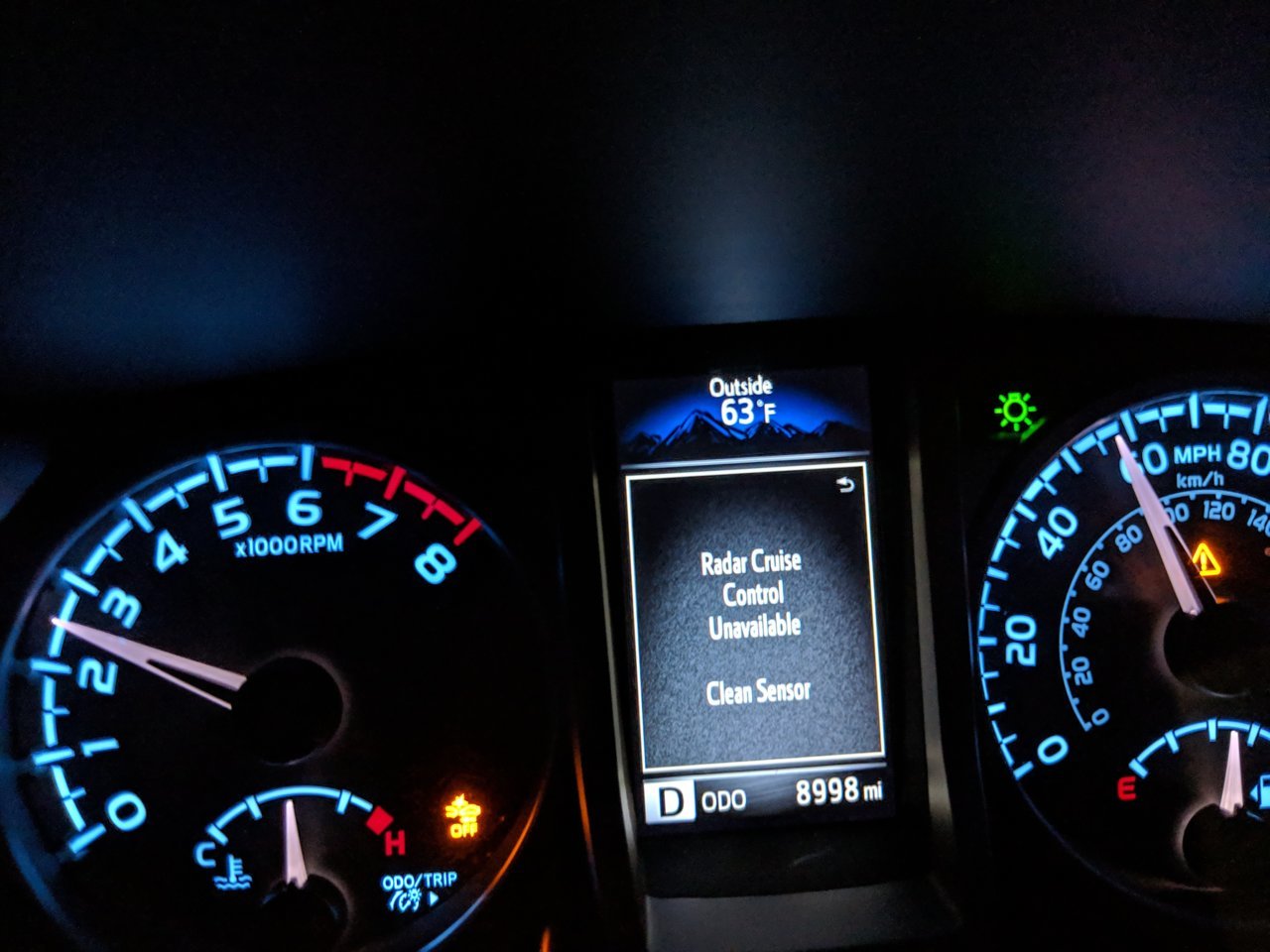

    Hi K9cali, the CBI T3 front bumper with low center grill protection will unfortunately inhibit the TSS front sensor from functioning on 2018+ models with a pro grill. I get an error code every time I drive telling me to clean off the front sensor. It doesn't bother me that much because I don't really use cruise control that much but it would be nice if the sensor worked.
    Then I tried removing this sensor entirely and the whole system freaked out. It prompted me to take my car into the dealer because the sensor system wasn't working, so I decided to just plug it back in and let it sit dormant.

    Just to give you an idea of what happens when I'm driving. Most of the time this little orange light is on all the time. It's not super annoying but it's always on. Then if I click the button to start cruise control, the system tells me radar cruise control is not available and the explanation point lights up on the right side. Check the photos to see what I mean.
