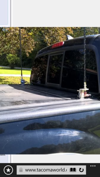

    TXPROMAN
    TXPROMAN Well-Known Member
    Sep 5, 2012
    #86308
    291
    Martin
    NY
    2012 TX PRO TACOMA

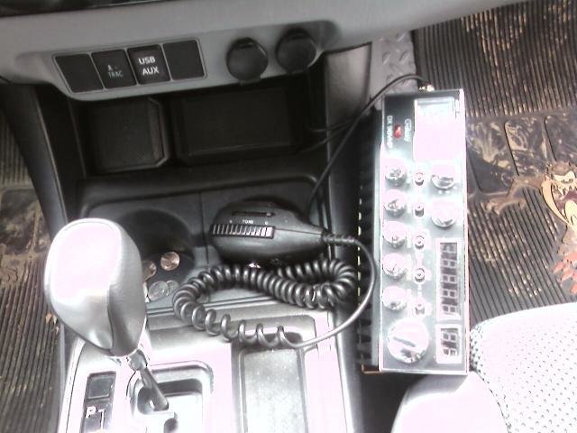

    I'll add...I've had one in the console, on the right of the center console (passenger foot well) and a Cobra 75 SWXT always wanting it in the center in front of the shifter. I've investigated doing the remote head display but that didn't seem viable. So this past weekend I cut out the back of my forward center cubby to make room to slide the back of the radio forward.
    I didn't take pictures of the process, but here is the result:
    For a mount, I use the FireStik side body mount and get a SWR of around 1.3
    http://www.walcottradio.com/firestik-m2-side-body-mount-p-298.html
    I'm pleased with this setup thus far.

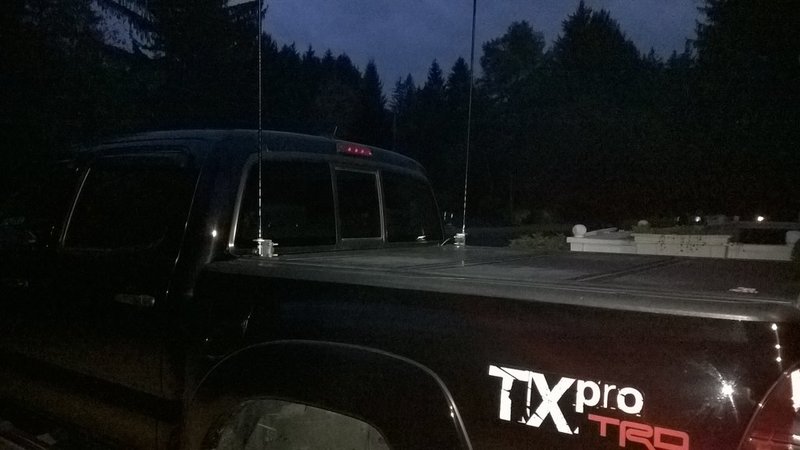

    TXPROMAN
    Sep 5, 2012
    #86308
    291
    Martin
    NY
    2012 TX PRO TACOMA

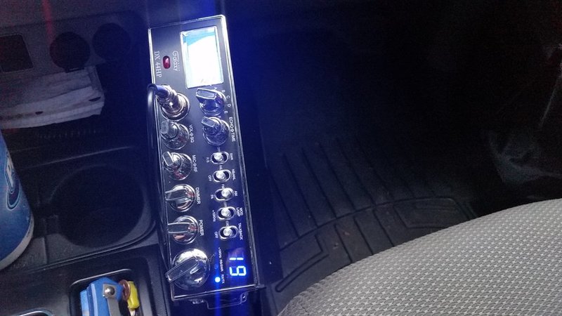

    TXPROMAN
    Sep 5, 2012
    #86308
    291
    Martin
    NY
    2012 TX PRO TACOMA

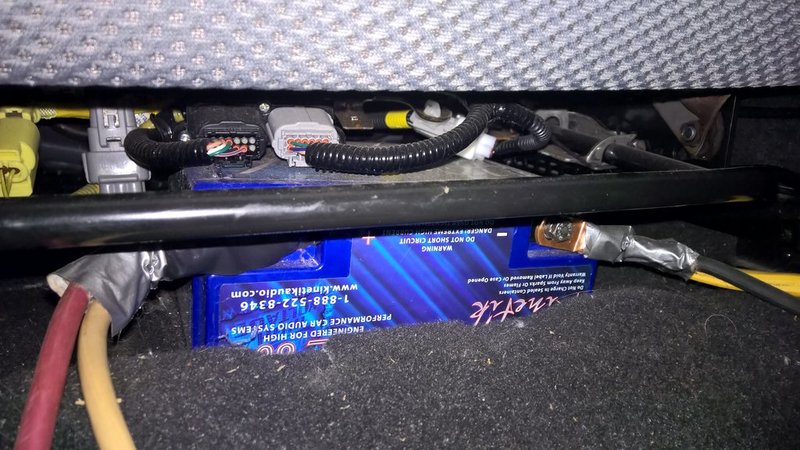

    it's a Galaxy 98. I have another battery under the seat for it also. It's been modified to do 300 watts and uses over 50 amp's when running wide open.

    EdinCincinnati
    EdinCincinnati Well-Known Member
    Mar 11, 2013
    #99457
    2,454
    Ed
    Ohio
    2014 4x4 TRD OR
    I cut out the back - not the bottom - so the radio extends now over the airbag box

    ancient11
    ancient11 Well-Known Member
    Dec 23, 2013
    #119094
    519
    robert
    tallahassee
    2019 4 cyl srsx ac
    Mine is located the same as txproman. Use a 102" whip20150727_194926.jpg20150720_134947.jpg

    EdinCincinnati
    Mar 11, 2013
    #99457
    2,454
    Ed
    Ohio
    2014 4x4 TRD OR
    3/4" maybe. When the console is removed, you'll see a black plastic support piece - passenger side of center line of truck. I studied it for an hour and am convinced you can cut that and have more room for a larger radio - but I chickened out. But I use an older Midland 79-290 which is smaller and fits without cutting.
