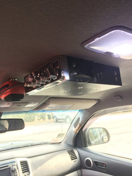

    Here is how I mounted my Galaxy DX979

    What mic is that?

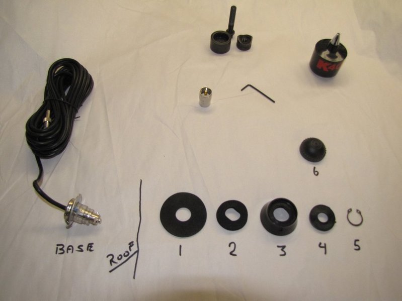

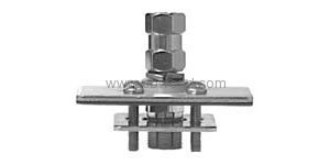

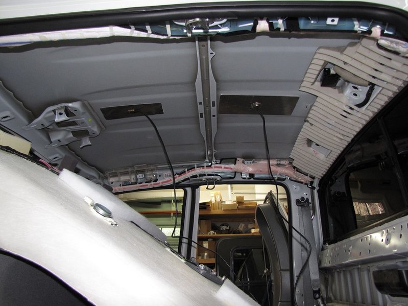

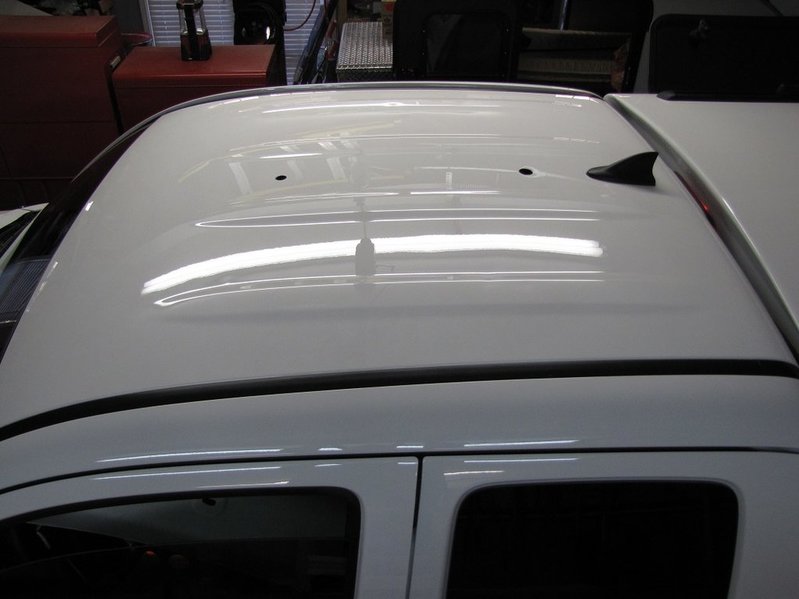

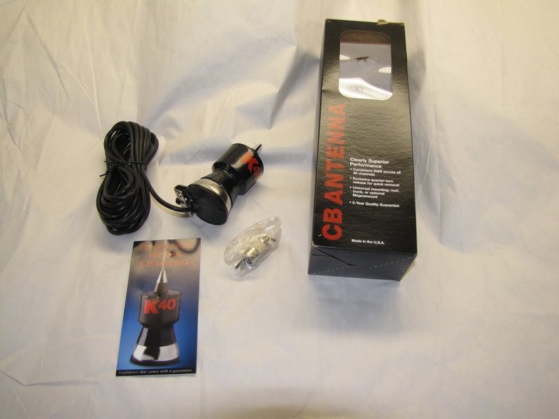

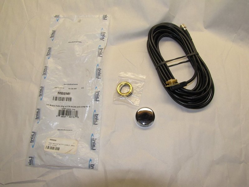

    I installed 2 communication antennas, one for CB radio and one for ham radio. For CB, I selected a K40 antenna, and for ham, a Laird NMO mount. Both antennas were mounted through the roof.
    I like the roof mount for several reasons. On the roof, the antennas are high off the ground, and not obstructed by any of the metal body. The higher the antenna, the farther the transmitted signal will travel. Also, roof mounted antennas are in the center of the vehicle, yielding the most uniform/even transmission pattern. Using the radio off-road, an omni-directional pattern is preferred. (Over the road trucks, with their dual antennas, prefer a more uni-directional pattern.)
    Here's what I installed:
    K40
    Laird NMO:

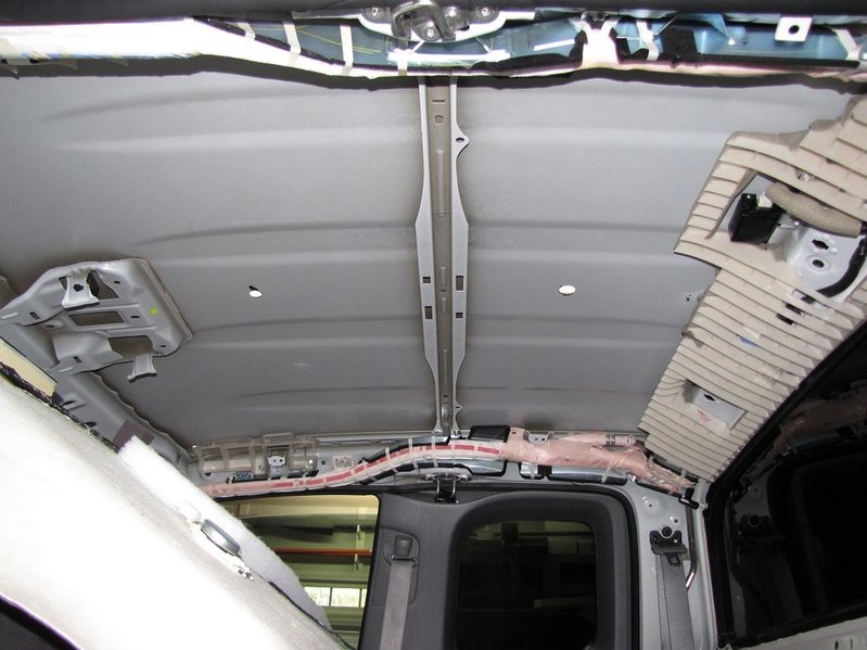

    On to the installation. First remove the headliner. On these trucks, you start removing the headliner by removing the door sills....

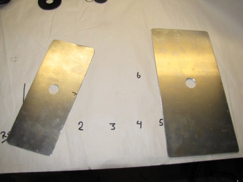

    I like to add a backing plate under the thin roof sheet metal. Extra material to carry the load when the antenna hits tree limbs and such.
    Backing plates:
    I used 1/8" aluminum for the K40 backing plate, and thinner aluminum for the NMO mount. I had to modify the K40 to use the thick plate. Unfortunately, the NMO did not allow for a thicker plate. But, something is better than nothing.
    Here's an expanded view of the K40:
    I also added Part # 1 - a 1/8" thick rubber washer. Part # 3 needed to be shortened to allow for the plate and washer.

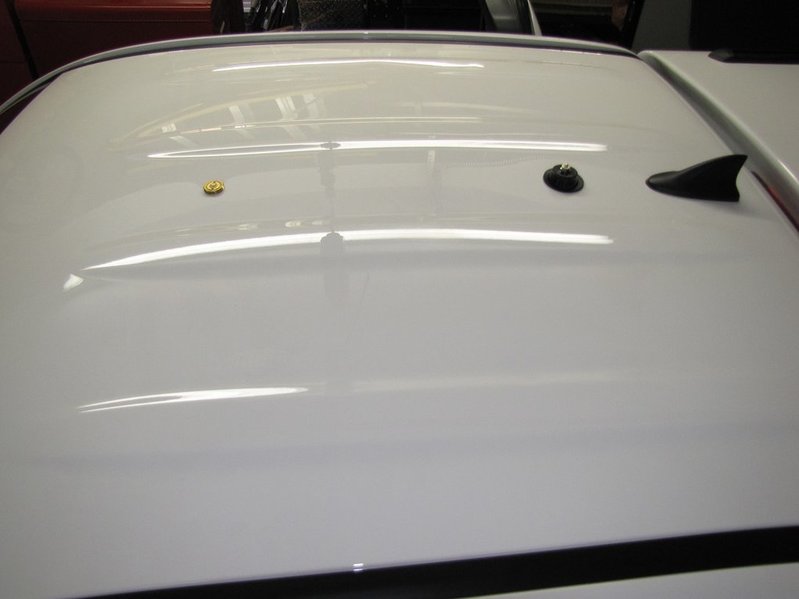

    Using a chassis punch, I punched 2 holes in the perfectly good roof:
    Assembled:
    Now to put the interior back together!

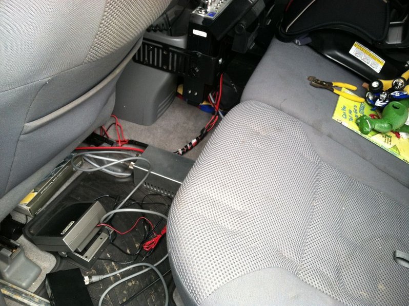

  8. Jan 29, 2016 at 3:19 PM
    #68
    holyfield19
    holyfield19 GO TIGERS!
    Jan 13, 2011
    #49179
    4,037
    Bob
    South Carolina
    06 DC TRD Sport 4X4
    Busted CV boots and lots of squeaks.
    This is the exact set up I plan on running with a cobra 75wx st. How does your set up work? @HBGIBBY

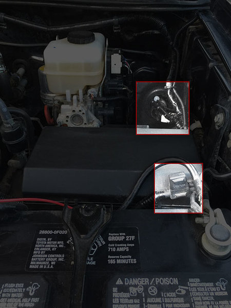

    Really simple setup. The Circuit Wizard at Blue Sea Systems recommended 18 AWG but I had 12 AWG laying around so that's what I used. I pushed a wire coat hanger through the firewall grommet (highlighted in the picture below); added an inline fuse, crimped some ring terminals to the ends. I wrapped the whole thing in wire loom, routed it to the battery along existing wiring and zip tied it in place.

    I tried to mount a full size radio above the rear view mirror and there was just not enough room. It looked pretty terrible too. Thats why i came up with my ceiling mount system.
