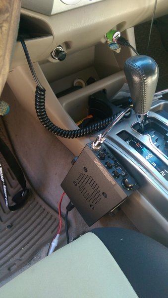

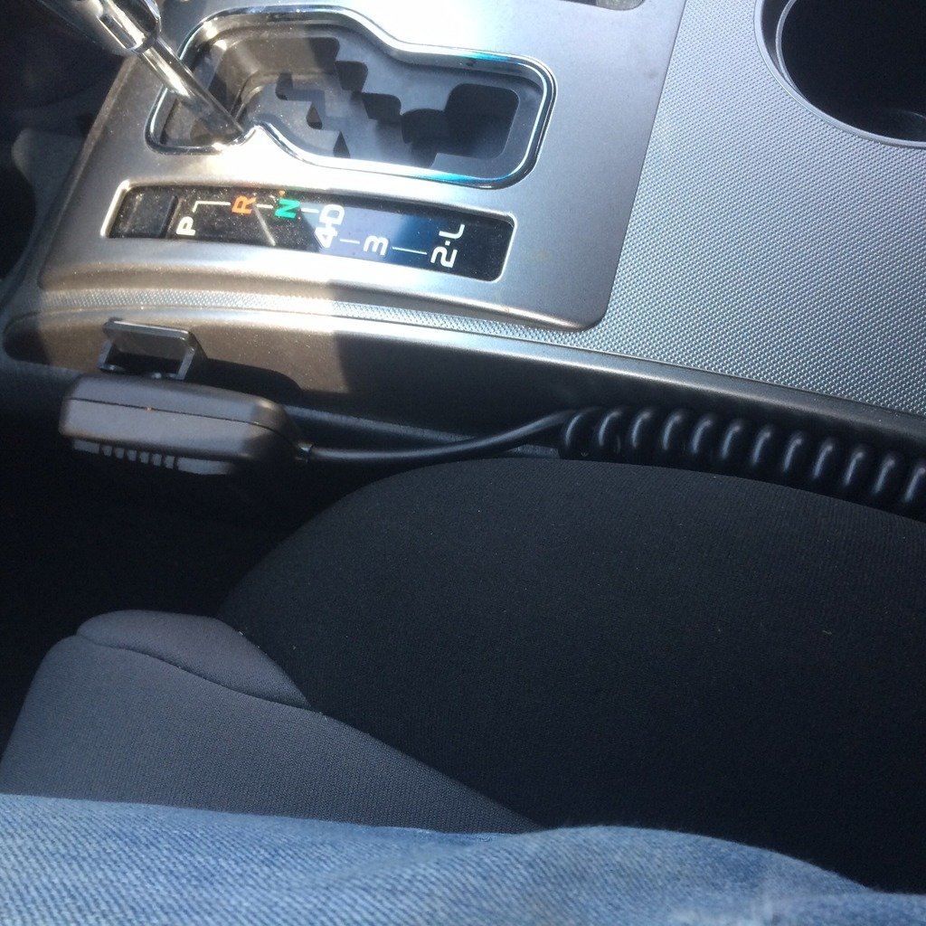

    Mounted mine in the center console.
    1496A267-7015-4FDC-9829-6D0DAADE22B3_zps_87126cd81ce26542a5c5d7ec6f6245fdc1b3ccd7.jpg
    Ran the mic up between the seat and console and mounted here.
    And ran antenna cable in up under the center console. That little grommet is is where I ran the cable in.

    Do you ever have any drinks in the cup holders and if so does your radio get in the way? I have in fact considered there with the same unit. Thanks.

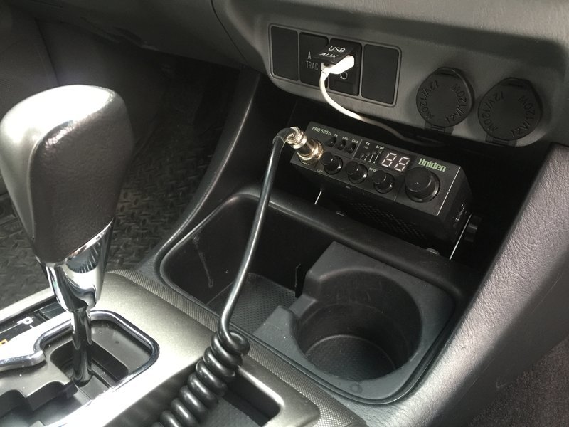

    No drink issues...including my 32oz hydroflask, it fits fine. However, I did have to cut a hole for the back of the CB...it is counter sunk with 90 deg elbow for antenna cable. It's a very tight fit up against the airbag module.

    I use a uniden pro 520xl cb and a 4ft firestik mounted to my bed rails.
    Firestik looks bigger than it actually is. Sorry bad camera angle.
