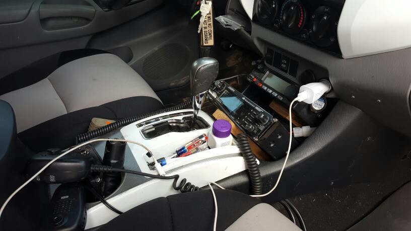

    Radio's are just temporarily set in the cubbies to see if I like where they are or not. If I stick to it I will be adding another cup holder where the one closest to the console is to get my space back for those.
    Antenna setup is a NGP 2' Firestick, also have a 4' NGP Firestick that I can swap to that I leave in the truck if I need the extra range while out somewhere. Fantastic SWR's from the NGP setup as well.
    Also, as far as SWR Meters go, Right Channel radio sells em with a jumper coax for less than $20, works great!

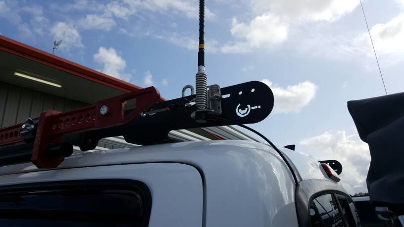

    I was thinking about moving my antenna to that same spot this weekend but didn't know how I would run the Coax, do you have it just going down the window and under?

    I've got it tucked in the window gasket and run down the back of the cab and under the truck

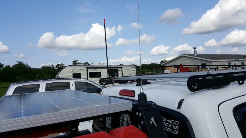

    The ideal setup is the longest possible antenna mounted on the highest point on the vehicle. Practical considerations mean compromise. But inside a camper shell would be bad. This looks like an excellent solution:

    I like the idea of mounting it to the rack like he's done.
    Could I mount a "base" to the rack (and run a wire into the cab), and attach/remove the antenna as needed?
    What would I need to buy to facilitate that?
    If the antenna is removable, function > form.

    Look into the Diamond motorized antenna mounts. It's probably going to be the rout I'm going to take, if it'll hold the weight of my antenna. I've seen a few expedition guys running them.
    There's also a few manual rotating up/down mounts. A Google search should provide a pretty good idea.
    I would avoid a removable base or antenna. Just creates more opportunities for failure. Antennas and their associated connectors are very sensitive
