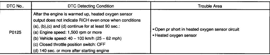

    Here's the definition of p0125 from the 98 3rz FSM code chart.
    Test the heater circuit in the upstream O2 sensor. It is the white/red wire, and the red/white wires.
    OHM test those two wires. If that circuit is open, replace the O2 sensor.
