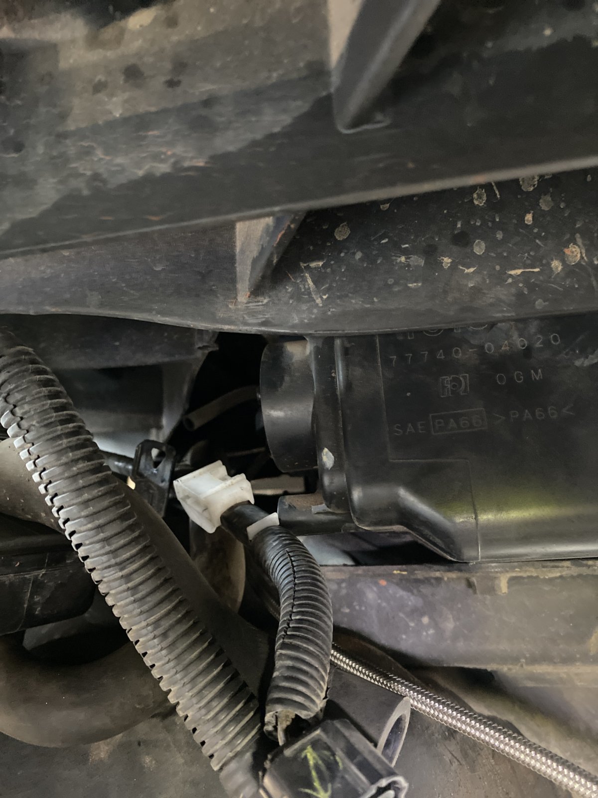

    Idk what is different for 2011, but this canister is not coming out without the bed removed. I removed the entire pump. Can’t shift it anymore to the right or left.

    Well rather than prolonging the inevitable, I ended up undoing the bed bolts and tilting the bed up slightly to get it out. I was honestly perplexed as to why mine didn’t want to come out. The ribs on this composite bed do hang low, especially next to the canister. They become more shallow closer to the end of the bed. I don’t know if that’s the case with all the composite beds. But I thank you for the advice! Still came in handy.:thumbsup:
    After finally getting the old one out, was able to reverse-order the new one in pretty smoothly. Had to disconnect the filter line from the filler neck but that went smooth. Cleared the codes and fingers crossed they won’t come back! :fingerscrossed:
