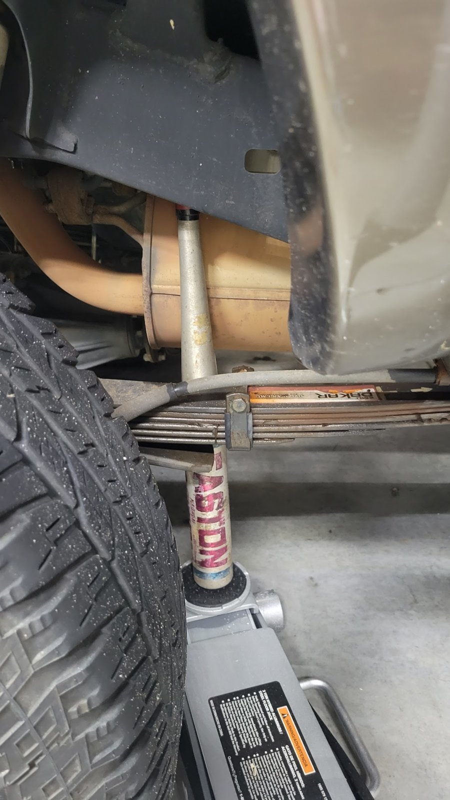

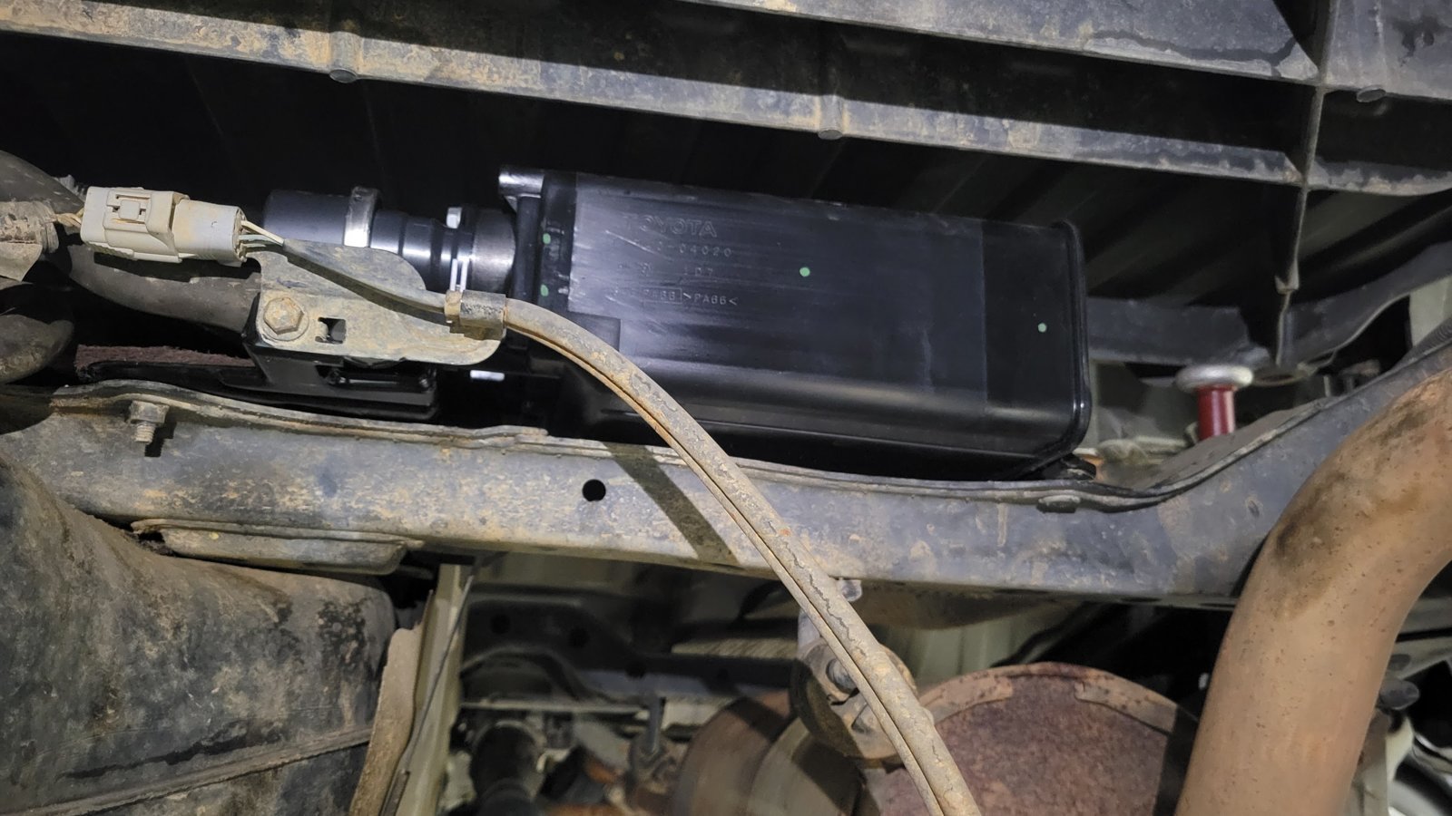

    Well, despite not having the light on, I went ahead and swapped out the canister.
    AP1GczNHbvTtl9l2ATO_kYhFC0mFFJbSv3bBW4j3_298fb335b360e64b1f084e583cc2e685cbcc31e1.jpg
    Removal of the bed is not necessary. Remove the bracket on the right (in the picture) and the canister can slide out easily. I see zero reason why anyone would cut the bed support to make room to remove the canister.
    I did end up lifting the bed though. I couldn't get the second to last connection loose. That stupid skinny hose was harder to get off than the last one that looks to connect to the top of the tank. For that last one, there are two tabs. Press them in, and then slide it off. Apparently that is a step that gets most people stuck.
    The first hose that came off has some cracks around the ends. I'm actually thinking that might be the culprit of my issue since I only get the codes when it is cold. Rubber shrinks when it is cold just like everything else. So I'll replace that hose if the codes come back this winter. I'm going to hold onto my old part though. Maybe be able to help someone locally without them having to buy a whole new unit.
    The unit that I removed is heavier than the one that went in. It didn't feel like it had liquid in it, but that's the only thing it could be based on my (limited) knowledge of how these systems work. I also don't fill to the brim. I'm pretty much a fill til it stops automatically. I might add up to $.04 to round out a number.
    Old baseball bat worked perfectly for lifting the bed.
