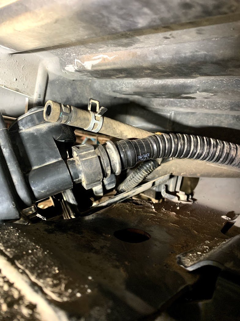

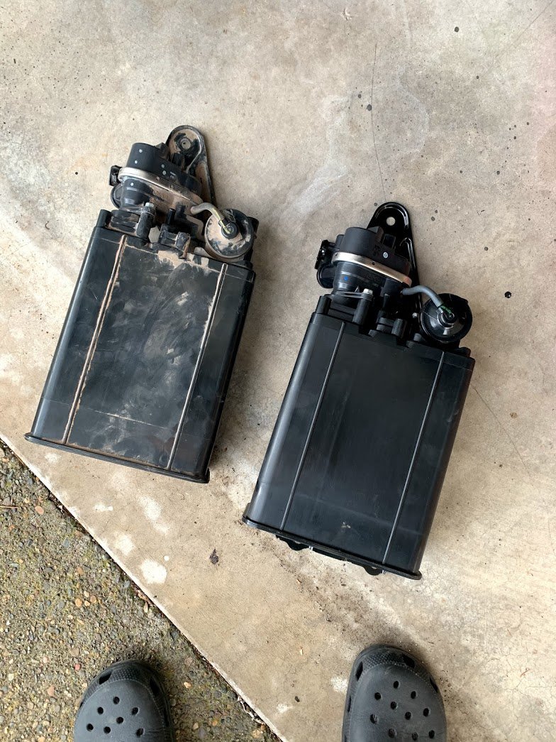

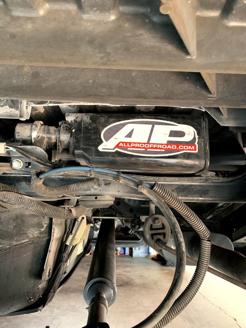

  7. Jan 16, 2020 at 4:47 PM
    #107
    inesshell
    inesshell blah blah blah
    Aug 2, 2011
    #60986
    7,166
    All stock Superwhite 10' AC
    did mine today, wasnt going to undo the bed so i notched the bed rib
    the biggest pain was the pinch hose on the very back
