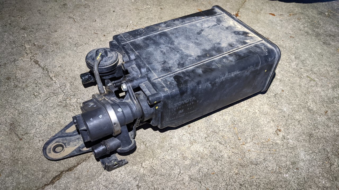

    Add me to the list, mate the drive time requirements for the test now hoping the codes clear themselves tonight, if not I'll clear them and see how it goes.
    Will update.
    Cleaned (without full disassembly) didn't fix it so a new one goes in.

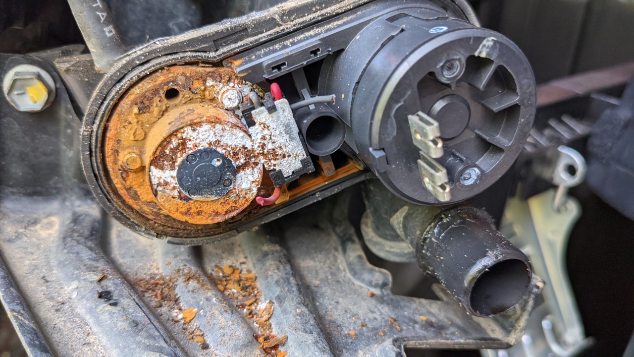

    Will open up the pump motor tomorrow and see if my old one is corroded like y'alls.
    Don't think it would have been possible to get out without my 1/2" bed lift to match the cab mount flip.

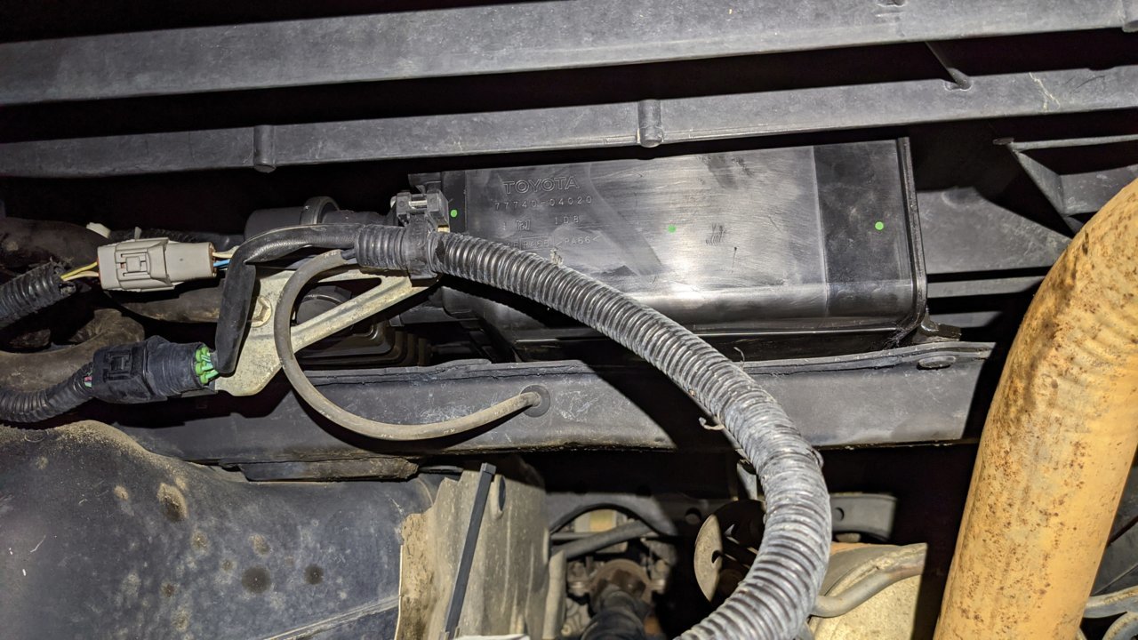

    I noticed the other day that second gen tundras have the charcoal canister in a much more accessible spot. If mine goes bad again I’m going to head to the pick n pulls and grab just the vacuum pump assembly and sensor off the canister housing to swap in. Much cheaper than spending $250

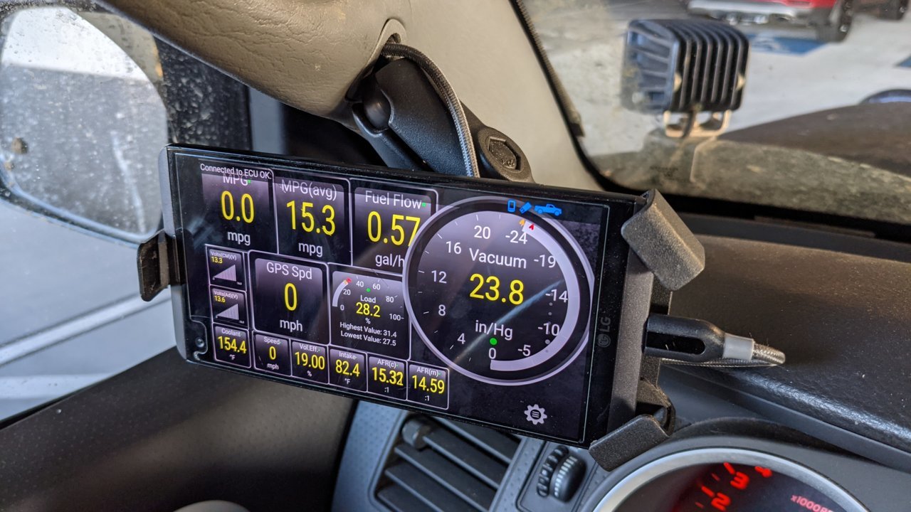

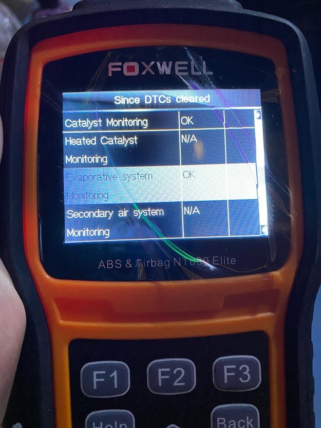

    No I cleared them through the app and they're gone now, nothing pending. But the app will pull pending codes not all of them will only the set codes codes.
    I'm not that worried about it, mainly because I don't have a scan tool to play with. It should do the check today. If they don't come back after a few days I know I'm good.
    For about the last month at least I would clear the codes, the next day they'd show back up as pending, and by the next day they had hard set.

    I still get mine so infrequently that I forget about it until it happens again. The Ultragauge that I have acts like the world is ending with a pending code, so they never make it to hard codes.
    One thing that I have noticed...or rather, have not noticed in quite a while. When I first got the truck, and for the first few years, I would hear a single "pew" a few moments after starting the truck. Like maybe 10 seconds after start. I never figured out what was making the noise. I'm wondering if since I haven't heard that in forever, if it could be the VSV part under the hood that @6 gearT444E referenced in post 134 on the previous page.

    You have an 11, do you have the secondary air injection system?
    My uncle's Tundra does the *pew* and has it.
    @6 gearT444E

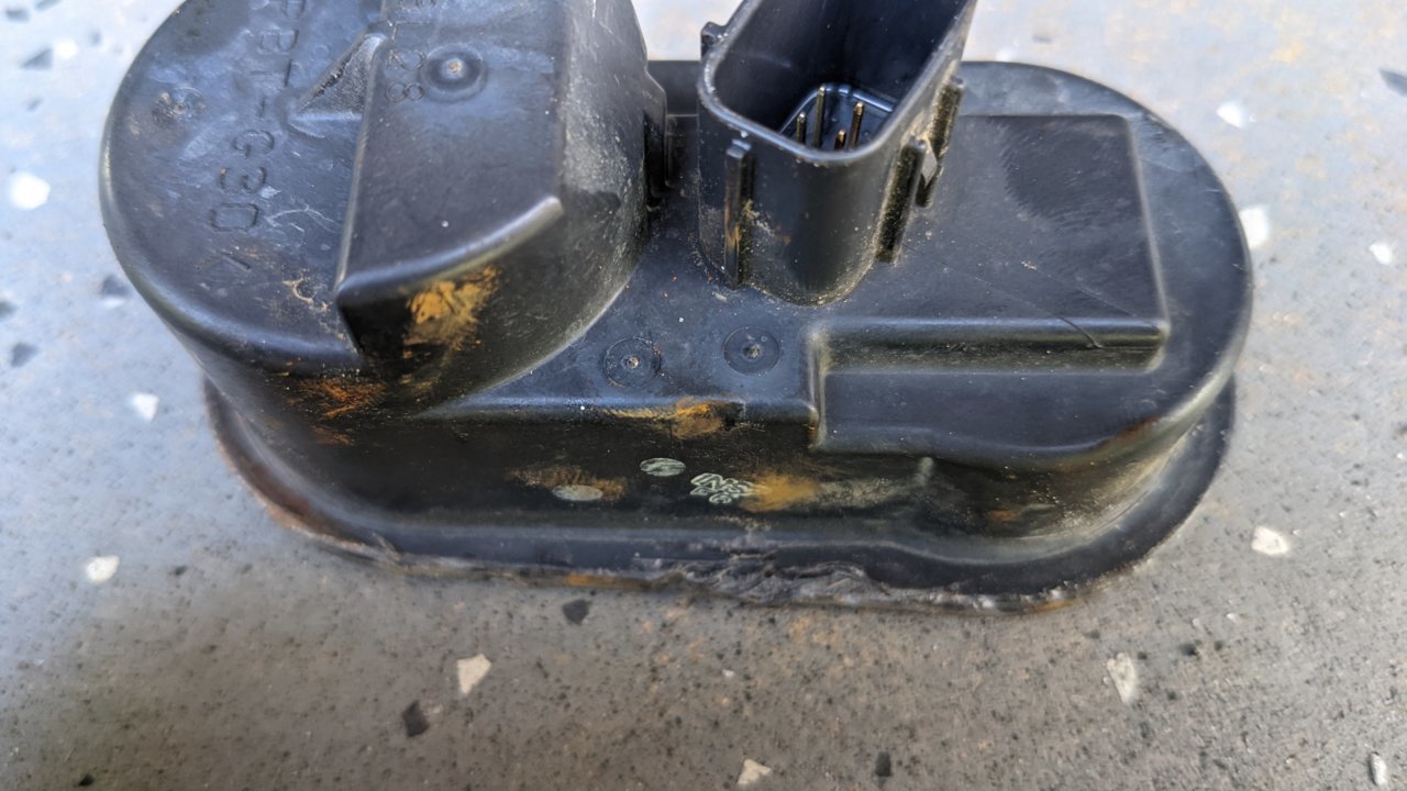

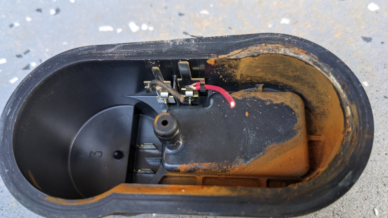

    Well well well, wouldn't you freaking know it it seems like the factory seal doesn't.
    Also, are these molded in test points?
    They're definitely contacts that pass all the way through the plastic case and I see no other purpose, I'm wondering if they are a moisture vector.

    Those are just the connections for the vent valve, looks like they are molded into the outside cover. Similar to the ADD actuators where all the circuitry is molded in the cover.

    Yeah that's it, I knew they were on the 2012's for sure I think some late production 11's had them as well.
    If it's not that then no idea.
