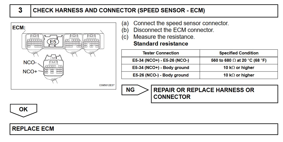

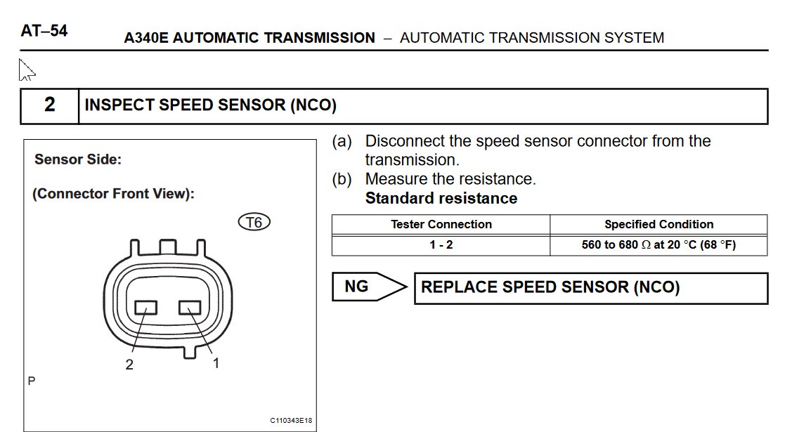

    You could just clear the code and see if it comes back. It may not. Disconnect the negative battery cable for a few minutes then reconnect it to clear the ECU Codes.
    Test it IAW the post above to know if it is the sensor the wiring or the ECU. More than likely it is the sensor.
    Easy to replace. One bolt and then twist and pull it out of the transmission. Reverse the sequence to install the new one.
