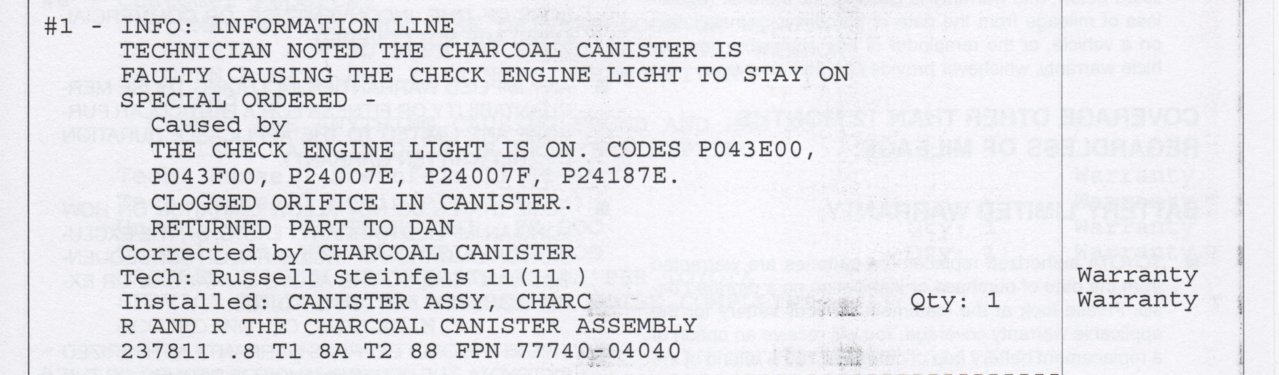

    Was back at the dealer Wednesday. They replaced the evap canister. Here's the relevant section of the invoice. These codes they show aren't the ones my scangauge was showing, but what do I know? CEL is off, and I've put ~100 miles on the truck since.
