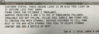

    Dealer notes.jpg The dealership did not provide me with exact codes.

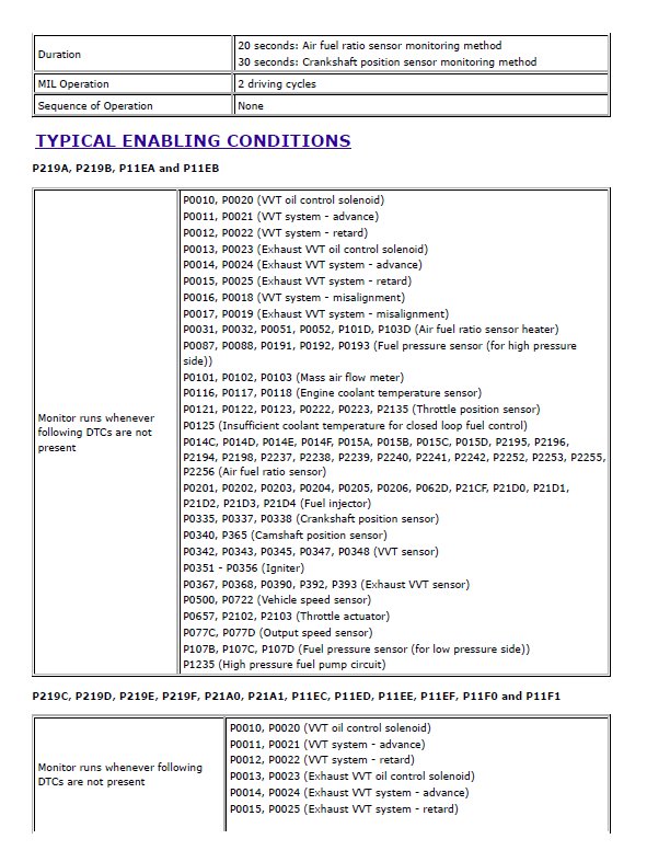

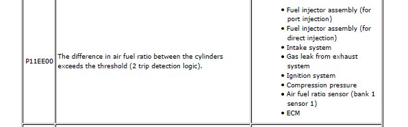

    Here's some interesting info WRT the imbalance fault:
    As you can see, either type of injector can cause this issue (if in fact it's an injector). Without the actual codes though, who knows?
    I just read the inspection procedure for imbalance codes. There are 13 specific steps to do, but NONE of them are "check fuel for high ethanol content".

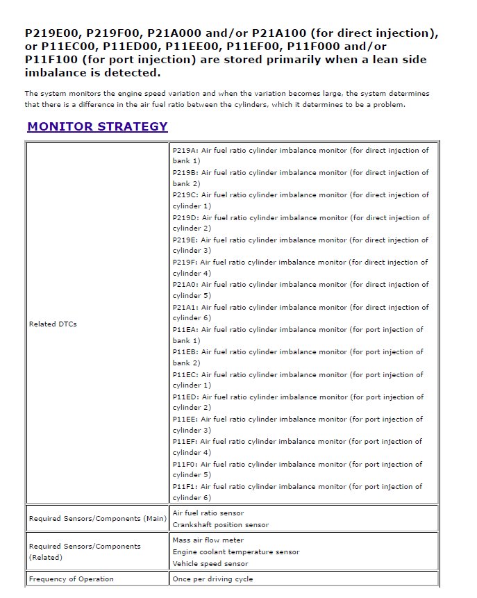

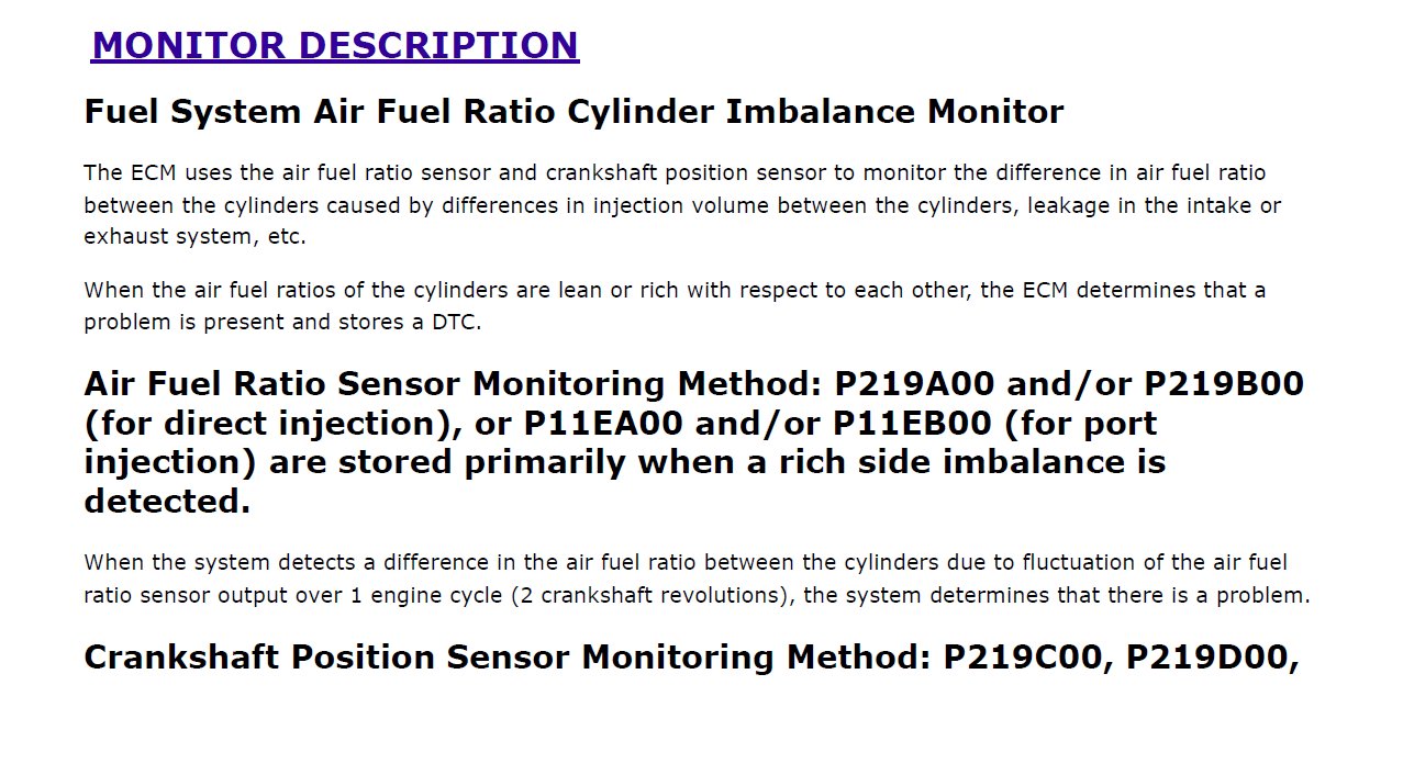

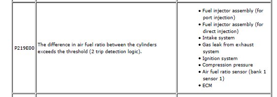

    More:
