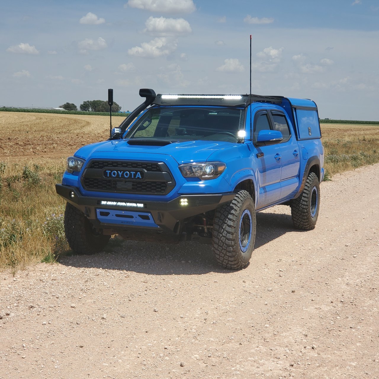

    Got the hardwire adapter for power linked to the spod; antenna cable routed through passenger firewall to the amp mounted under the passenger seat; inside antenna mounted to expedition essentials 3tpam with cable down through the dash; trucker antenna is mounted to cali raised bracket attached to CBI ditch light bracket

    I just did the 'Ditch Light' bracket but for my Midland MXT275 GMRS antenna. I use the WeBoost Drive Reach antenna on the roof and it requires a 6-8 inch ground plane so went up the windshield channel to the roof area. I have both the Midland and Weboost all under the passenger seat, hot wired it all to my sPOD.
    Question for @Papa_Smurf - Does that larger antenna need a ground plane? I went with the on one side and I could go with the your antenna on the other.

    Both my antennas up front are receive only so no ground plane is necessary, as far as I know.The OTR on the passenger side is for the cell booster and the 3' firestik on the driver side is for my scanner. I'll be running a 4' firestik CB antenna off a bed rail mount; for that I got NGP antenna and associated NGP RF cable to avoid the ground plane issue at the cost of minor performance degradation.
