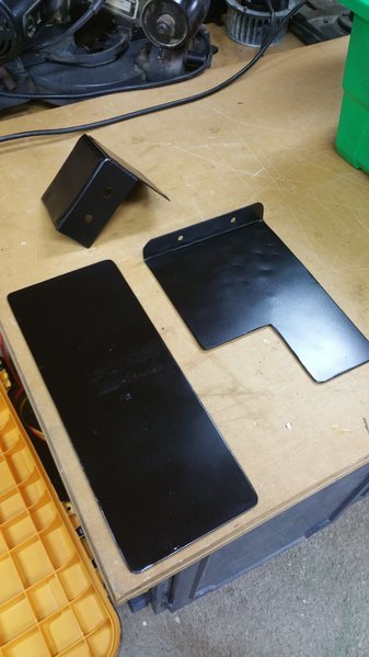

    I started with three brackets I made and painted black. One for mounting my power and fuse panel under the hood, one for mounting the cell booster to, and one for the antenna in the bed.
    Once I had those all done up, I mounted the one under the hood along the backside of the drivers side fender, where there were two available mounting holes that were already threaded. I hooked up to the battery with a 250 amp breaker, followed by two fuses. The 150 amp fuse will be hooked into later, that will be for my power inverter that I plan on installing. The 100 amp fuse is feeding my new blue sea 6 circuit fuse box. For now, the fuse box is only running 1 circuit for my cell booster, but will be added to in future. Power for the booster is run through a relay, which is tied into the injection fuse in the fuse box in the engine bay. This way the booster can only be turned on when the truck is running, and me forgetting to turn it off doesn't drain the battery. I know that this setup is extremely over kill for what I am currently running, but didn't want to handcuff myself down the road. The other thing I like about this setup is that with the exception of a fuse tap to trigger the relay, it is 100% independent of the factory wiring. I did not splice into any factory wires for any part of this project.

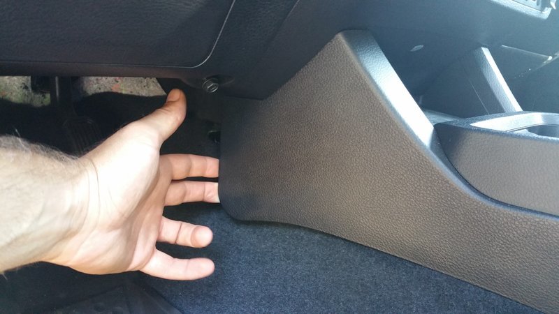

    I ran the wires into the cab through the grommet on the drivers side. Where the main wiring harness comes through the firewall, I just poked a hole and pulled the wires through. I ran to a switch underneath the climate controls. So I could put my new switch beside the wireless charger, I moved the usb and aux port over next to the ect button. It seems as though there are specific switches for specific spots, and it would not move directly over. There are grooves on the sides of the oem switches that correspond to the grooves in the holes. I assume this is done to make assembly slightly more idiot proof. A new blade in my Olfa knife quickly solved that problem, just shaved the edge of the switch. Once I had it moved over I was able to install my new switch beside the wireless charger switch. I couldn't find a switch that I liked or that was remotely appropriate to mount in the cab with three kids to see. Although the stripper lights switch would have been awesome, I had the switch custom made by Will at your4x4store.com. I gotta say he did an awesome job. It turned it exactly as I had hoped. Sent him the picture I wanted and what I wanted it to say, and I had the switch in hand in less than a week. The only other part of this project that has to be done is get the light under the words on the switch to come on with the dash lights, but I need one more add a circuit. I ran the wire from the switch, but it is coiled up under the dash until the add a circuit comes in next week. Going to tap the tail fuse under the dash. The switch itself isn't hard to install once you figure out how to access the panel. I couldn't figure it how to take out any of the plastic, even trying to start with the console. I suspect it is mostly clips that hold it together rather than bolts and screws. I didn't go too far that way since I know once I start prying things will break. I ended up pulling the head unit out. Just took off the plastic trim, unbolted the unit and pulled it out as far as I could without disconnecting any wires. I was then able to reach in and down to pop blanks and do what I needed to do.

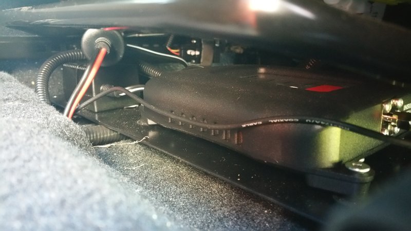

    Next I installed the booster itself. It came as a plug and play kit, so I almost left it as such and only kind of hard wired it. The power line had a 12v plug that runs a transformer for 5v power. Rather than cut the line and hard wire the power, I hooked the switch into a hidden 12v port that I installed under the drivers seat. I ran power to it from the switch, behind the dash, behind kick plate, and into the door sill plate where I went under the carpet and out where the wiring comes out under the drivers seat. Kind of hard to see now but...
    This booster is wireless, but gives best results when the inside antenna is within 18 inches of the phone, so I followed the same path for the power wiring back to the plastic of the center console that is to the right of the gas pedal. I mounted the inside antenna on the back of this plastic. It cannot be seen but gives optimal performance when my phone is on the wireless charging pad.

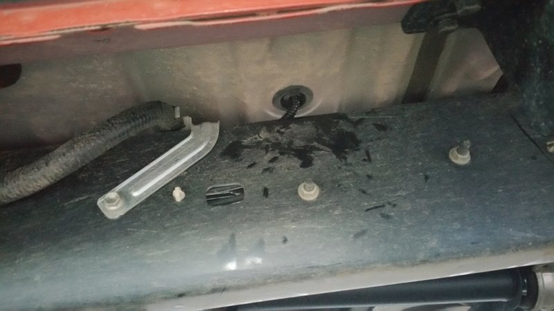

    Lastly, I had to run the external antenna line. I mounted the antenna mount I made to the track in the box of the truck. I didn't use any fancy fasteners, just stainless bolts with washers that fit snugg in the track. It worked well, but I had to grind down the edges of an old box end wrench to fit it in the track so I could hold the heads of the bolts while I tightened down the lock nuts. The bracket has 2 surfaces, one vertical, and one horizontal. The antenna is magnetic, and will typically live mounted horizontally so that I can close my tonneau cover. When I am hunting or out in a really bad reception area, I can roll up my tonneau cover and flip the antenna up. I drilled a small hole beside the mount, popped in a grommet, and ran the wire under the truck to the grommet under the drivers seat, where all the rest of the booster was installed. Just to note this isn't the antenna it came with, but an upgraded one.
    Well that's it! Booster only runs with the truck, is completely hidden, and works best when it is on the wireless charger. Could not be happier with the set up! Thanks to everyone who helped out with my million questions! If any one has any questions please feel free to ask.

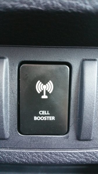

    Love the work on this - and I really like the cell booster switch. I think I'll go this route myself!

    I want this switch as well!
    Been looking for something like this
