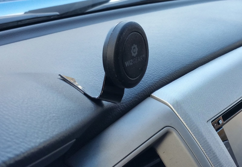

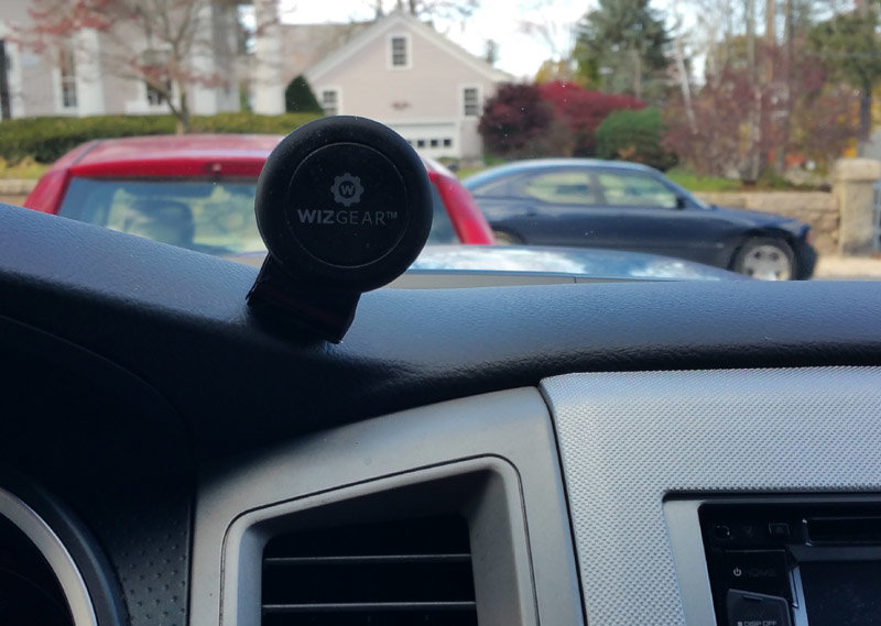

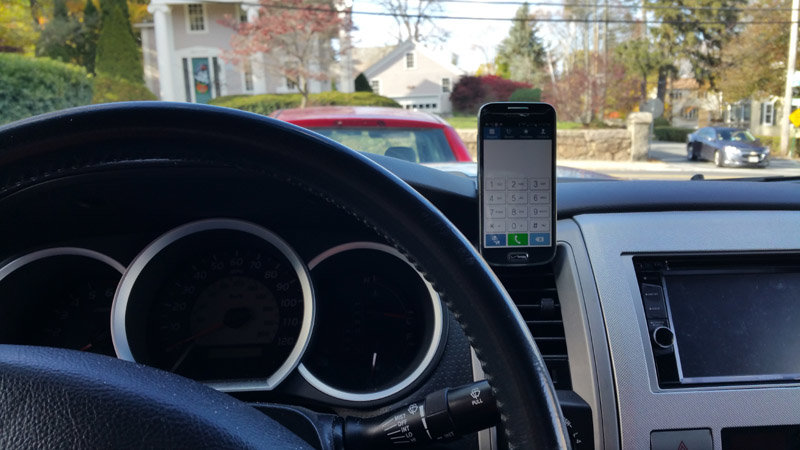

    I bought one of these for $8 on Amazon: https://www.amazon.com/gp/product/B00PGJWYJ0/ref=oh_aui_detailpage_o00_s00?ie=UTF8&psc=1
    The vent mount screws off. I cut a piece of 1"x1/8" brass shim stock ($4 at local hobby store), bent it to shape by hand over a metal edge, and covered it with black film tape. The magnetic mount went on via a screw through a 1/8" hole, and I mounted it to the dash with 3M extra heavy contact foam. Less than an hour all-in.
    Mine is to the right of the wheel because I'm right-handed, but it could be on the left just as easily. Isn't blocked by the wheel, blocks none of my road view, doesn't block the vent, and doesn't violate the "nothing on the windshield" laws that seem to be popping up.
    Is it a bit unsightly from the side? Perhaps. I could have spent a few more minutes trying to soft curve it to meet the dash curve, but I typically have the phone there while I'm driving (Waze, mostly), so I can't see it at all.
