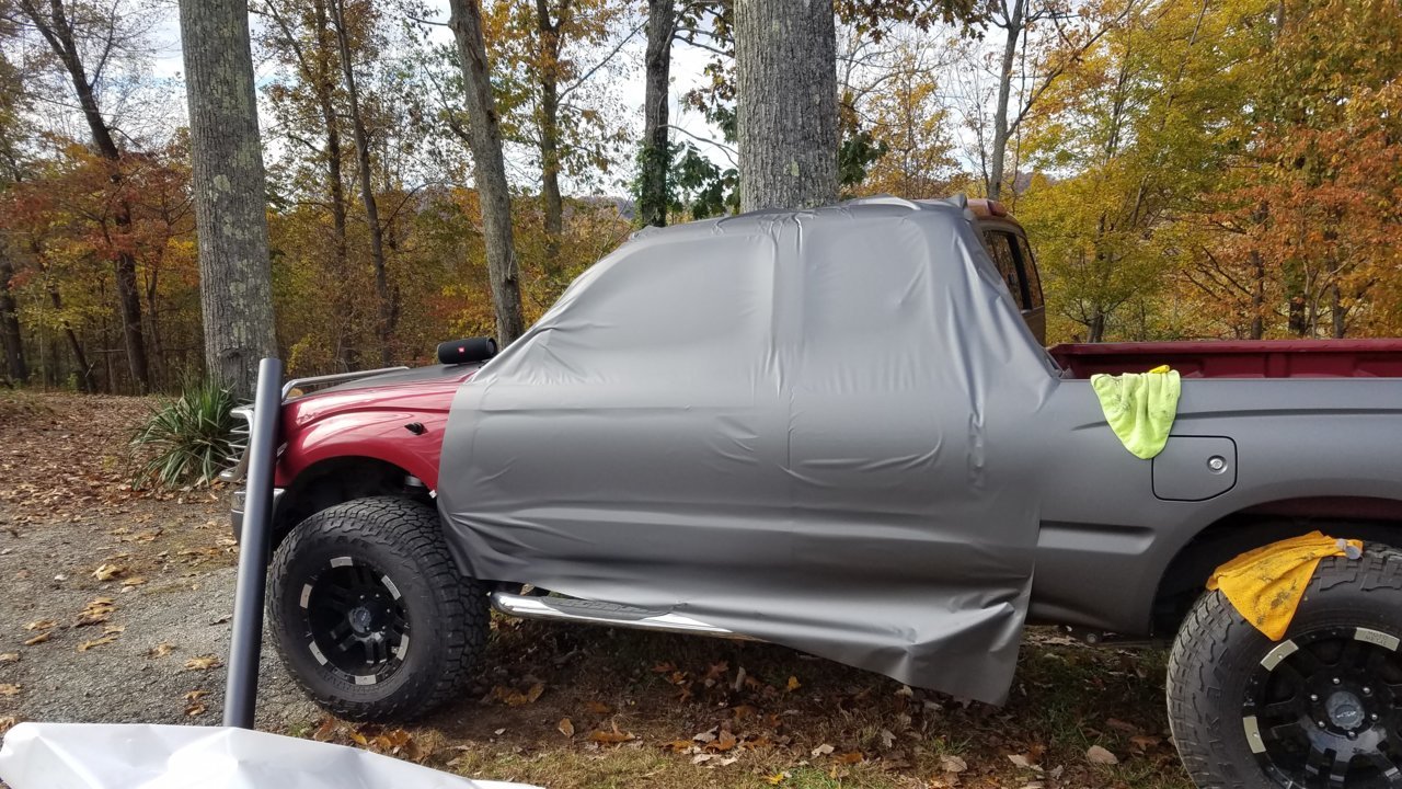

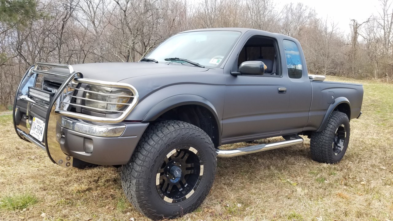

    Ok. I wrapped mine because of the same problem, fading on the hood and roof, but at the time i didn't think of wrapping it in my favorite 2 tacoma colors, Cement gray or Cavalry blue. I just wasn't sure how it would look.

    Wrapped the whole truck. Just make sure you sand off the pealing clear coat if you wrap anything.

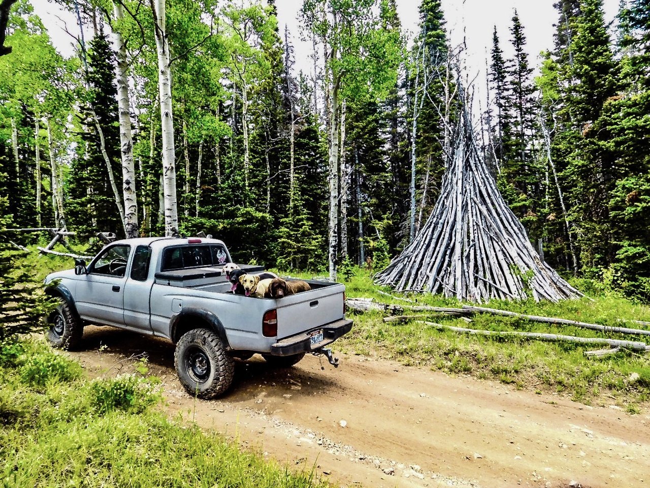

    @commandotaco has arguably the best aftermarket paint I’ve seen.

    hey man looks good, sorta has that matte finish which is cool.
    Yea I figure for the wrap to look best it'd need to be super flat without any leading edges.

    Thanks. It's the 3M Dark Gray Matte color. Says it should last 5-7 years outdoor. Not bad for $350 and a weekend of work.

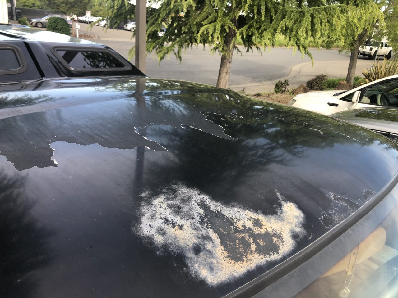

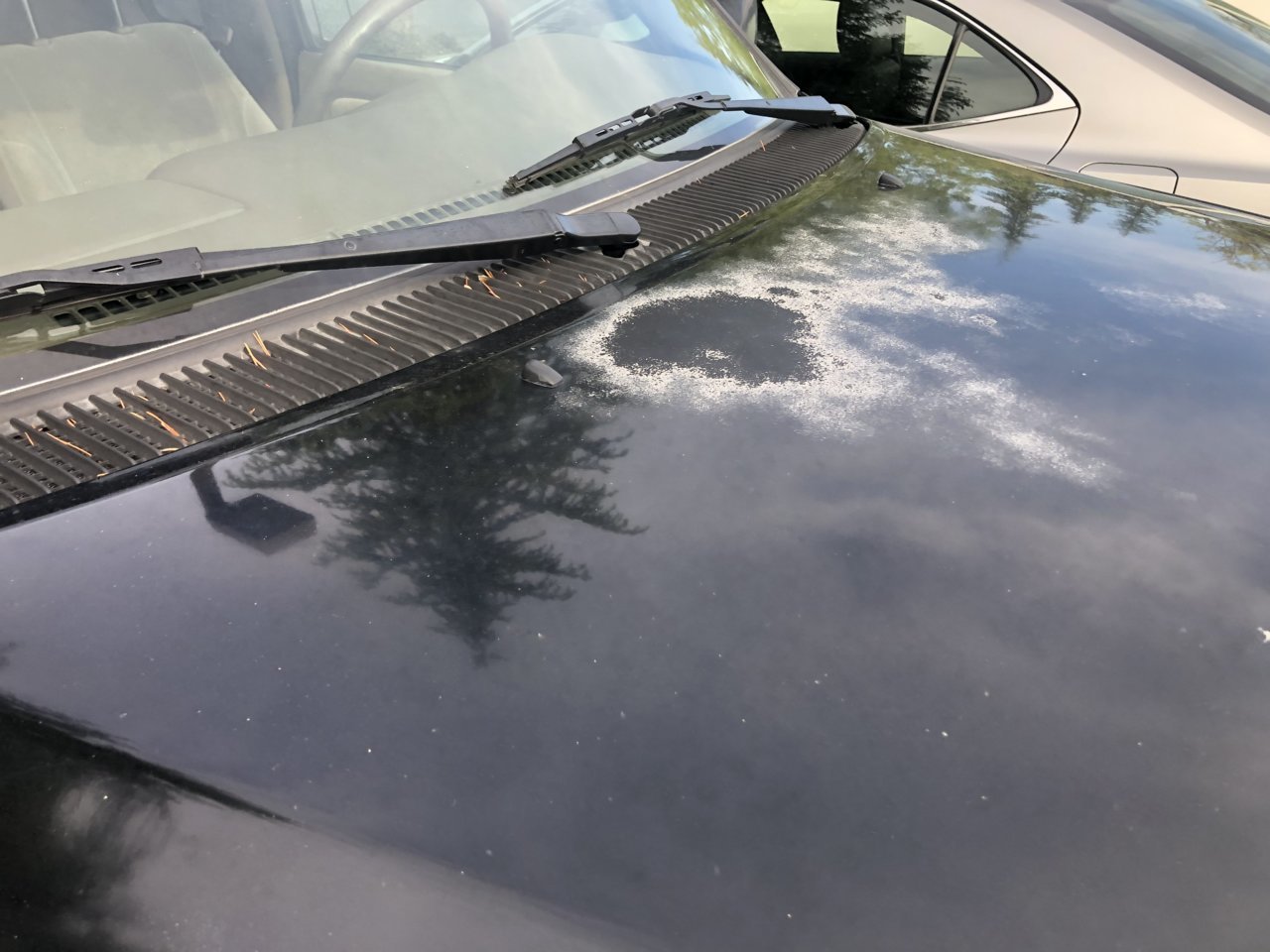

    Here’s my hood and roof
    The clear coat is peeling so far back on the roof lol
    I take it you did the wrap yourself, did you order sheets and do the trim yourself? Or can you order them pre trimmed to the panels?
    $350 not bad at all, beats a $3,000+ paint job or having someone else do the wrap

    Yea, I did the work myself. Ordered one big roll and did one panel at a time. Removed mirrors, door handles, bed liner and fender flares for easier install.

    That actually looks kick ass man. I've always like red or maroon and gray together, like came on a couple 80 series Cruisers. But looks good for what it is. Nice work

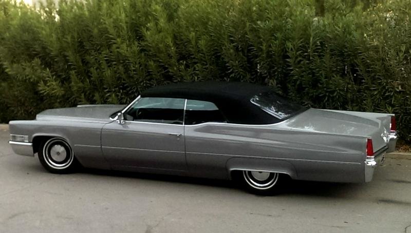

    Love it. I remember driving those when they were almost new. That's before the "detuned" engines of 1971.
