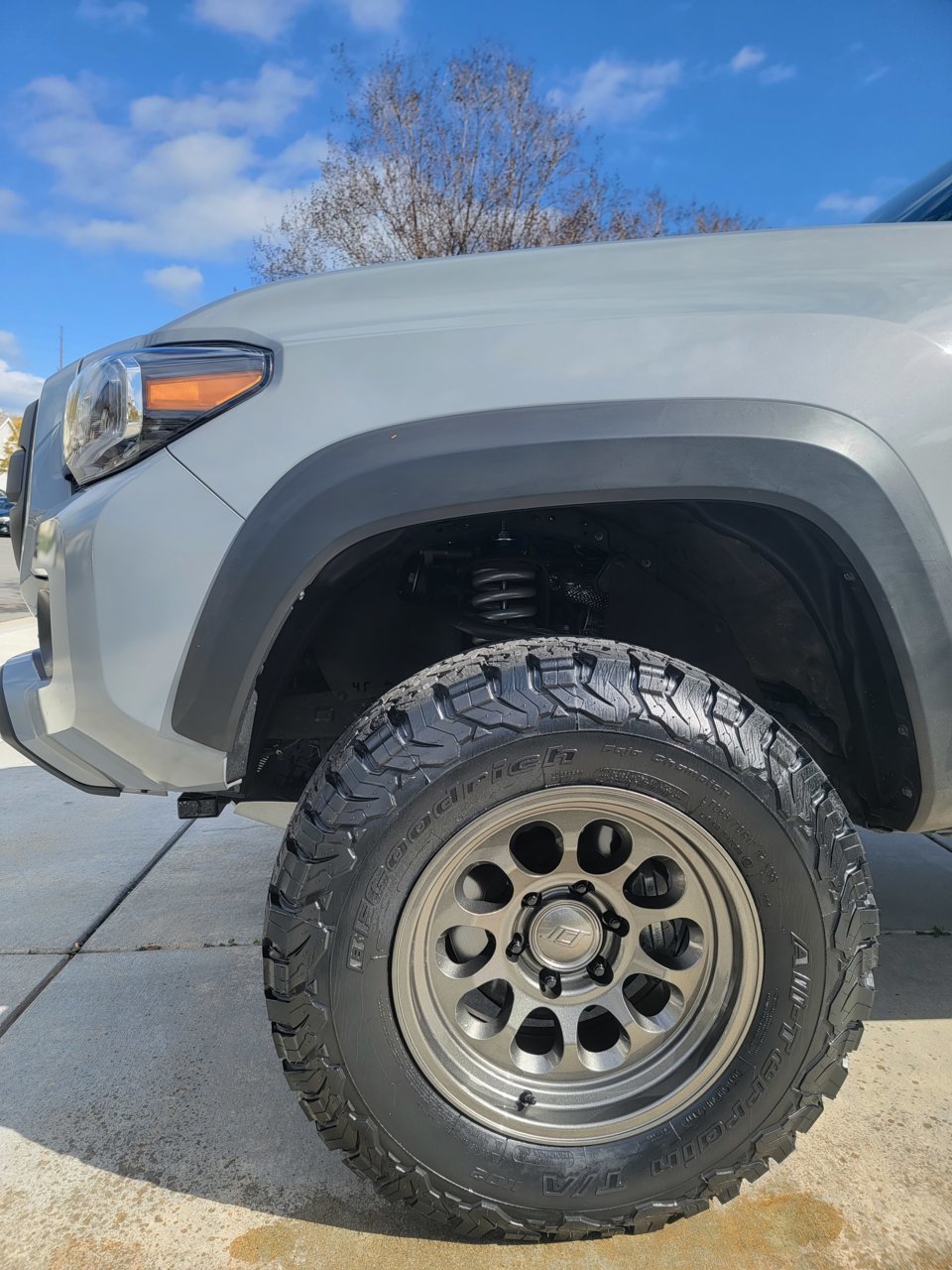

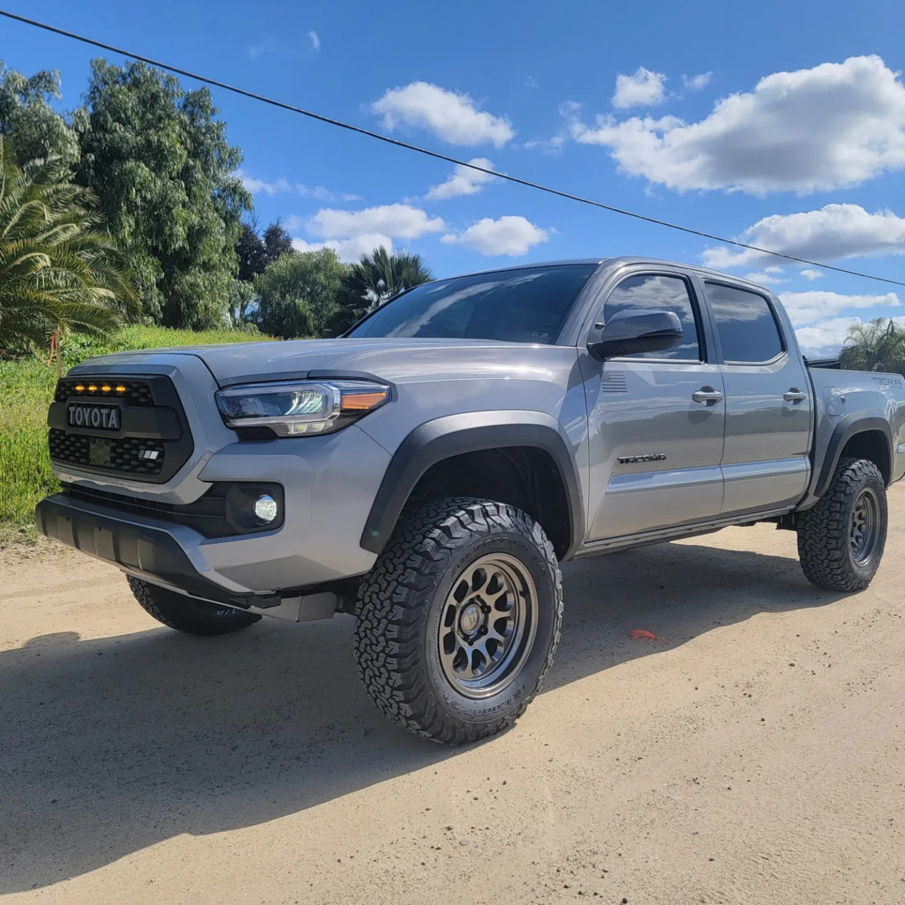

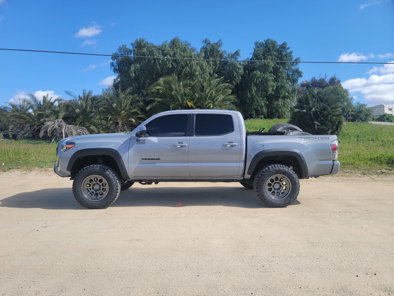

    Hey fellow Tacoma friends! I dont post here much but wanted to share the new upgrades! Pretty stoked overall and really excited how this looks and feels compared to stock. I just had the wheels and tires installed literally a few hours ago and figured Id post it up!
    I recently had the lift installed and was lucky to score some new SCS wheels at there last 5pm drop and scored some k02s and got it all buttoned up. Rides stiff but feels awesome, im stoked on the stance and feel like this is ready to take to the mall finally :eek::D hah!
    New Upgrades:
    • SCS Blaze10 Wheels - Gloss Gunmetal 17in -10offset
    • BFG K02 265/70/R17 Load C rated
    • ( No rub No Trim No CMC )
    • Allignment and TPMS Swap!
    Lift:
    • Recently Installed Eibach Stage 1 Pro lift (2nd notch)
    • ECGS Bushing
    • No Sway Bar relocate
    • ICON AAL Rear 1.5 ( overload taken out)
    • Lift professionally installed by @Speed Freek / Jason in Vista! Thank you for the awesome install. Cant recommend this guy enough for work, if youre in so cal hit him up!
    • Stock UCA ( for now)

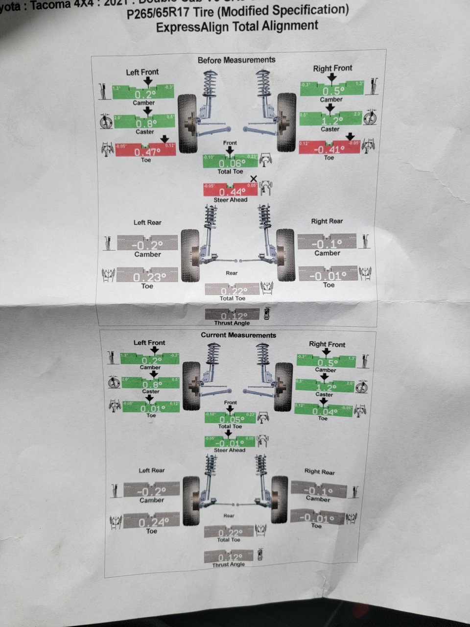

    Also how's the alignment look can anyone give me a thumbs up on it? Feels like it pulls to the right but maybe that's the best that can be done on stock UCA?

    The truck looks good with the Blaze10. I always feel like a good alignment guy should always be able to make left and right match number wise.

    Why are the specs modified? Specifically the caster. Looks like they changed it to make it "green" because I'm fairly sure the spec is from 1.4 to 2.9 degrees.

    It looks like all they adjusted was toe.
    Right front tire seems like it could be corrected closer to left side camber/castor specs in order to minimize wear. :confused:

    When you say modified, can you elaborate more? Also is there a way I can find if the data suggests it should be between 1.4 to 2.9? I dont want to be rude to the guys who did the alignment but I want to lean in a little bit on them with actual data to see if I can get them to adjust it better*

    Your printout says "modified specifications". The min/max of the caster specs was changed from 1.4/ 2.9 to .5/ 2.0 which would make your readings of .8 left and 1.2 right both look like they are in spec (green) but actually are out of spec. To be fair this is normal with a 2" lift. Oh and just because both are green doesn't mean it's a good alignment (especially for camber and caster)
    Here's a printout of a 2020 I found on here. Notice the specifications

    Yeah that's making a lot of sense. So let me ask you a question if you dont mind...After doing some research and looking at this print out it looks like it's safe to assume this allignmet was the bare minimum. They did no adjustments to any other setting other than toe and didn't even attempt to fix the toe in the driver rear. Would you let them try again or just ask for a refund and try another shop.

    Nice looking ride. Nice to see something in grey and not black or bronze.

    Well, TBH, they did all they could do with the alignment, with stock UCAs. They might be able to get a little more caster angle while keeping the camber in spec. The pull you feel could be loss of caster, the toe being a little off, or maybe just road crown. The toe in the rear is not adjustable. I honestly think they had the target mounted on the wheel a little off. This would affect the front toe readings the alignment machine calculates for the front. It might be worth redoing the toe if the pull bothers you just make sure it's not because of road crown. I would be inclined to take it somewhere else that uses a similar alignment machine (Hunter)

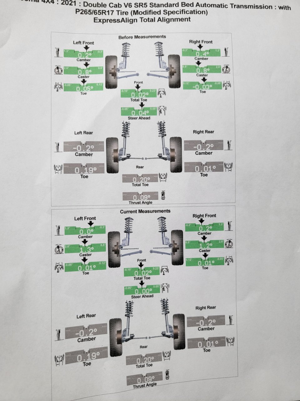

    Updated alignment looking dialed in

    Your specs are still modified

    I asked about that and the tech said that just refers to my truck being lifted. He brought me back to the garage and showed me my truck on the rack and showed me the caster was maxed

    That's why I said there's nothing more they can do. They still modified the specs and it was done to make the final alignment go "green" I've seen many shops do this and I've been in hundreds with my shop equipment repair business. Specs don't change just because of a 2" lift. Factory specs are what you follow until you get into MAJOR suspension changes like and SAS or long arm lift.

    would you recommend aftermarket uca's in this case then?

    I would. Specifically the SPC UCA because he doesn't need that much correction.
