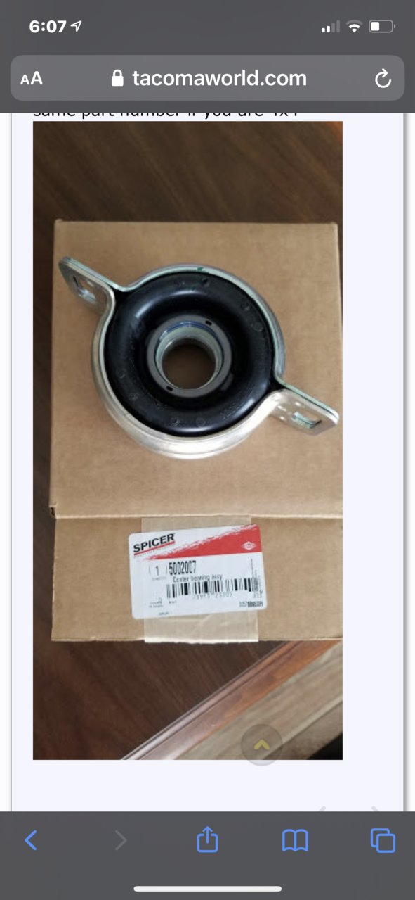

  5. Jul 1, 2022 at 4:53 PM
    acparker12
    acparker12 Well-Known Member
    Apr 5, 2022
    #394358
    128
    Penns Valley, PA
    2014 MGM Tacoma TRD Sport 4x4
    Still figuring it out…
    I plan on doing mine soon and was wondering if the part number I plan to order is correct the part # is 37235-35030, hell it might help OP out too since he needs one.
  6. Jul 1, 2022 at 5:03 PM
    01 dhrracer
    01 dhrracer Well-Known Member
    Aug 27, 2013
    #111316
    1,918
    Palm Desert/Bermuda Dunes
    Still Shopping
    FYI. I had a local driveline shop to me www.iedls.com replace all three u-joints and center support bearing with Spicer components and a rebalance for $360 Parts at Oriley's would be about 200 plus tax.
