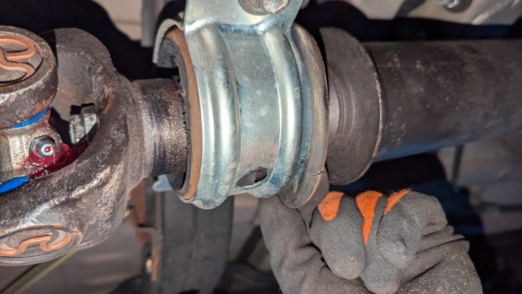

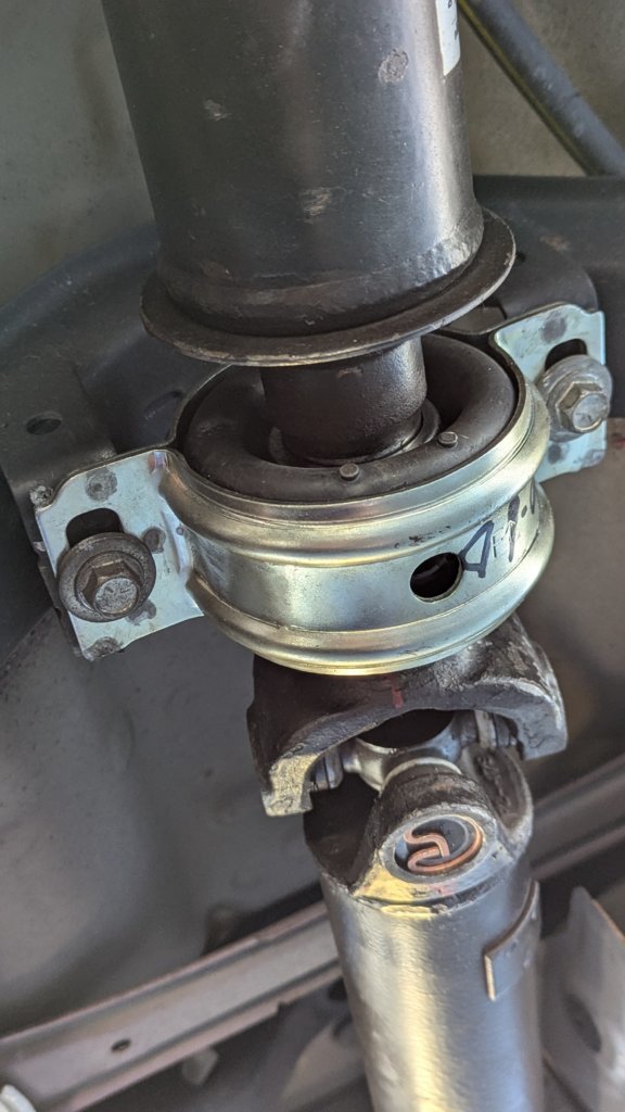

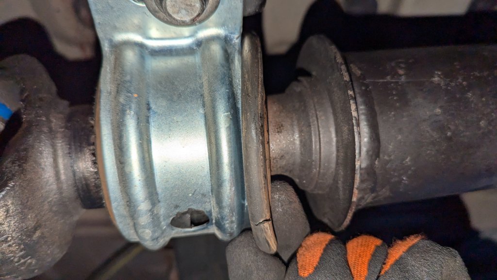

    Installed new U-Joints and a new carrier center support bearing over the summer.
    The u joints are awesome, less grumbling noises coming from beneath.
    However, in my last diy inspection of the driveshaft, I noticed the center support bearing looked d a bit weird.
    It still drives fine, no noises, no weird things on acceleration either so far.

    That center carrier is destroyed, you need to replace it.

    Did you actually replace the entire bearing/bushing assembly, or just the metal clamp surrounding it... because nothing else here looks like it was replaced this summer.
    Doesn't matter in the end, I concur with @xtremewlr: the bearing is shot, time for replacement!
    This is ultimately a wear item, but not on the timescale of a few months. If a shop did this job, I would go after them, unless you drove like 60k+ miles in this time frame... and even then I'd be disappointed.

    I'm really disappointed in this purchase from Splicer. After my DIY replacement of old worn out parts on the driveshaft, where I replaced the entire assembly, the u joints seem fine, but the center carrier hasn't held on after a mere 5 months (driven only a bit over 6k miles).
    Does anyone know a better place where I can get a more reliable replacement parts? Or should I just go to a shop and have them replace it?

    Was that the original carrier bearing? IMO I’d go back with OE.

    That carrier bearing isn't a Spicer part. I'd question those u-joints too. Don't buy critical shit like that off Amazon.

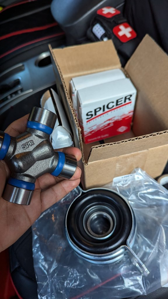

    UPDATE:
    I took it to a Driveline Shop in East Williamsburg, Brooklyn (NYC). They specialize in drivelines and driveshafts.
    They came back to me after an inspection and said that the new U-joints I installed were put in too tight, leaving a lot of wiggle room on the ends and causing the end clips to move around when the shaft rotated. As a result, it wore the center carrier bearing excessively - he said I was lucky that there was no more damage beyond that.
    The shop is replacing the 3 u-joints and the carrier bearing for me with sealed (non-grease-able) u-joints and a new carrier bearing, all Spicer. Total came out to over $600 (I'm assuming for labor, OE Spicer parts, diagnostics, and the space my Taco took up in their Shop - in NYC, everything is expensive)

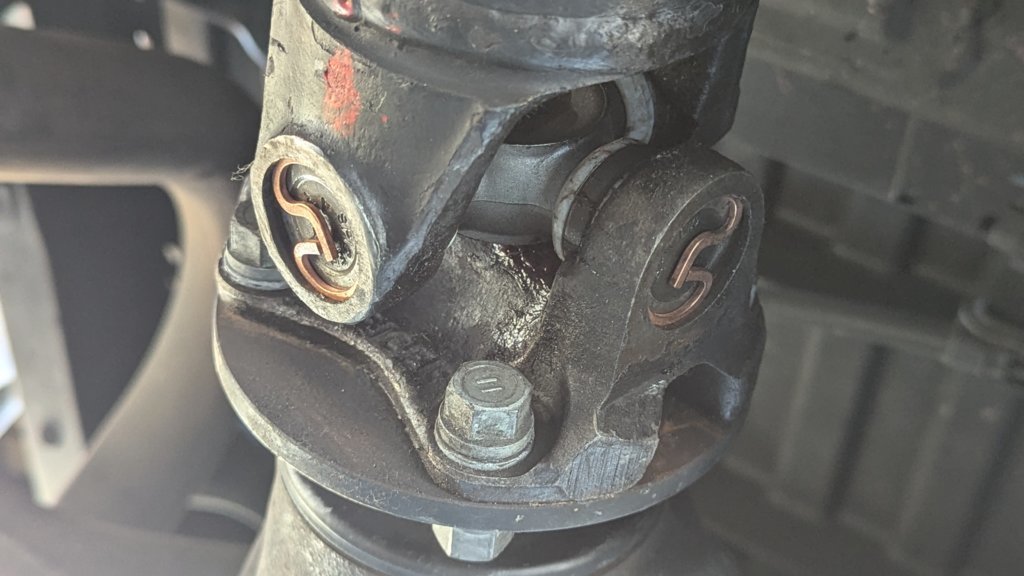

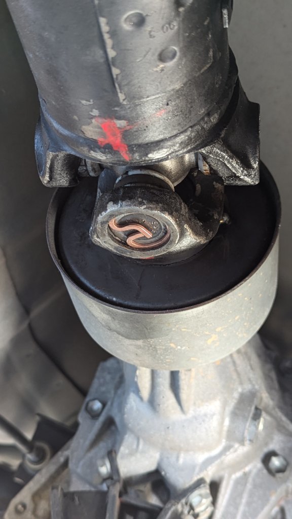

    Here is the U Joints that I replaced myself as a DIY thing, obviously with the center carrier already worn out. PXL_20241207_211755403.jpg
    The drive line specialist said that there was enough wiggle room at the end of the U-Joints ends that allowed the metal clips to wiggle around, causing all that vibration and ending the center carrier.
    Here are the new U-Joints and center carrier bearing, from back to front:
    The only thing, something my brother and I have noticed in the front seats, is that the motor (or transmission) seems to be much more audible during acceleration only, and I do feel more vibration - all consistent with acceleration.
    Maybe the new parts just need to be "broken in" more (?).

    i gotta ask - how do you put in u joints too tight.

    I kept pushing my press tool to the point that the blue rubber seals looked kinda squished in, more than they do here in this pic of when it first came in the box:PXL_20240704_000455781.MP.jpg

    I don’t understand this either.
    Sounds more like it was a shitty gray market support bearing that crapped out and then the driveline shop scored extra cash on u joint replacement.
