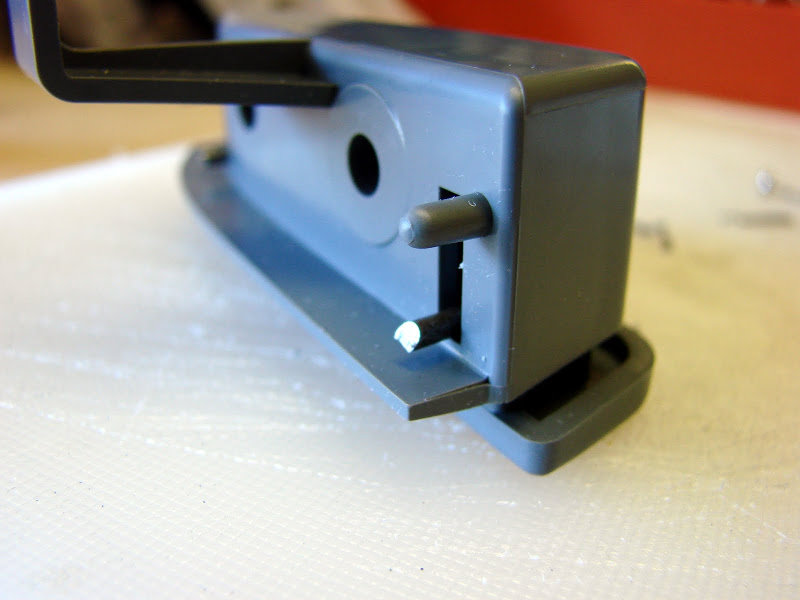

    After mine being broke for three weeks I finally found the time to fix it. I used a nail which I cut down with bolt cutters and a bench grinder to put a point on the cut down nail. It went in there good, so hopefully it stays in.

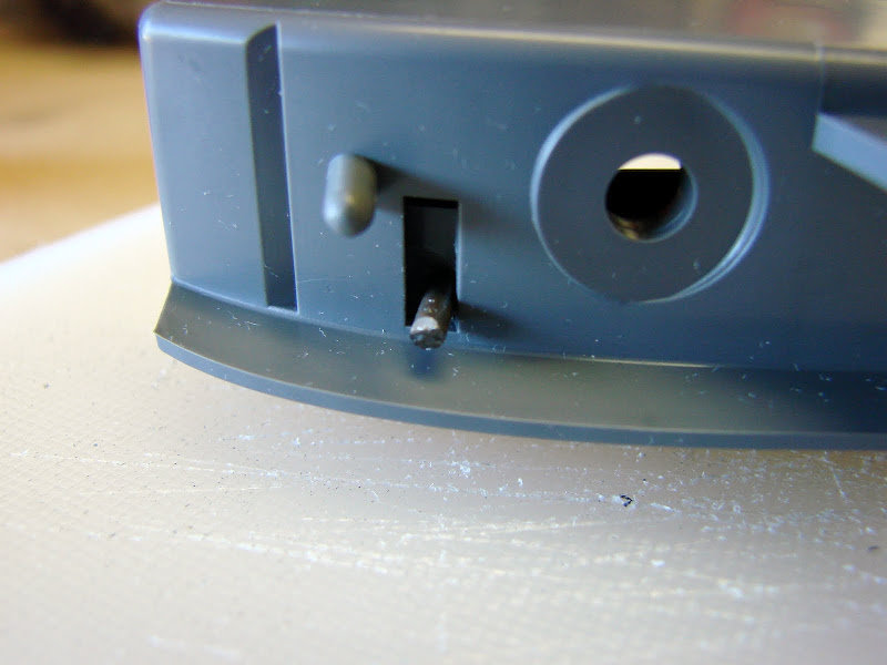

    Just to add to the knowledge base here I used nails. No time to go to the store to buy set screws and nails are free. :D I finally got the pictures online to share. The guy who used stiff wire gave me the idea. I cut the nails down to size with a bolt cutter. It worked perfectly and took about 5 minutes to do.

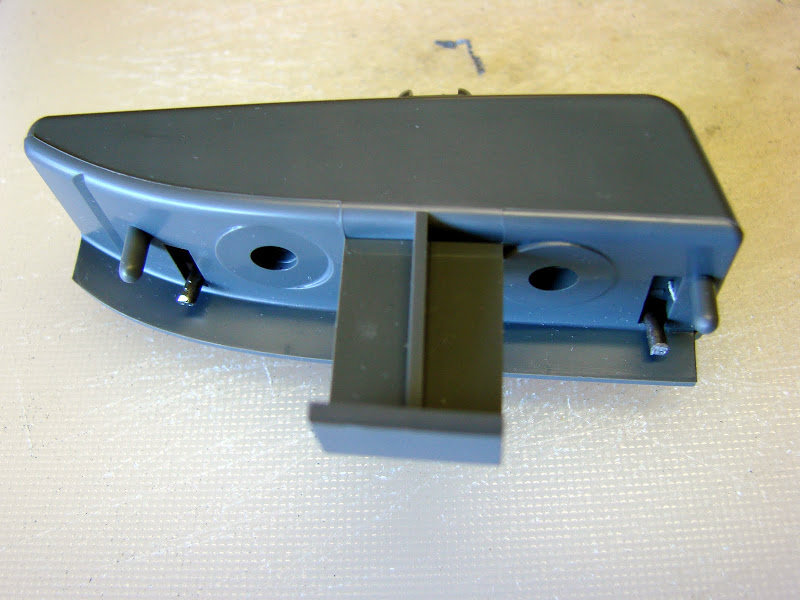

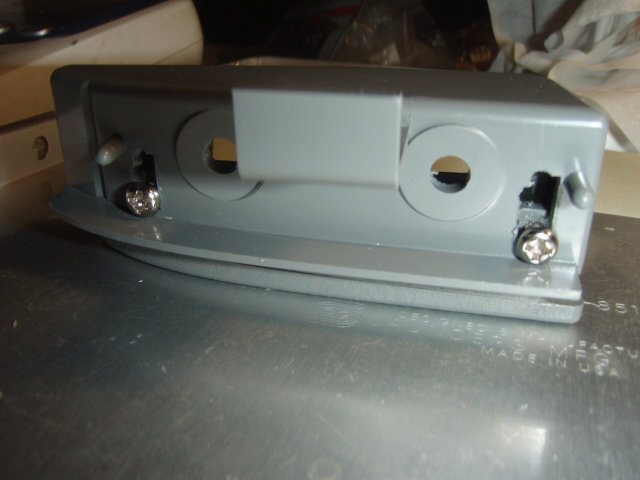

    And yet another way: Hard drive mounting screws:

    Thanks for the help! Drilled 2 holes and used some stiff wire I had around and the latch is back in business. Love the free fixes!
