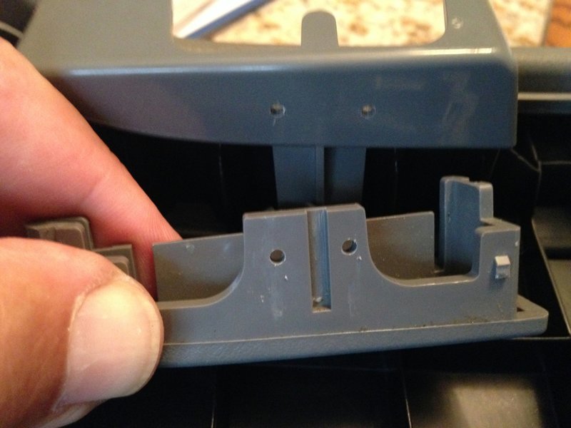

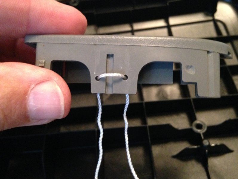

    Here is how I fixed my center console. First, I took the lid off and then removed the latch assembly so I could work on it. I drilled 4 small holes - two in the latch and two in the frame.

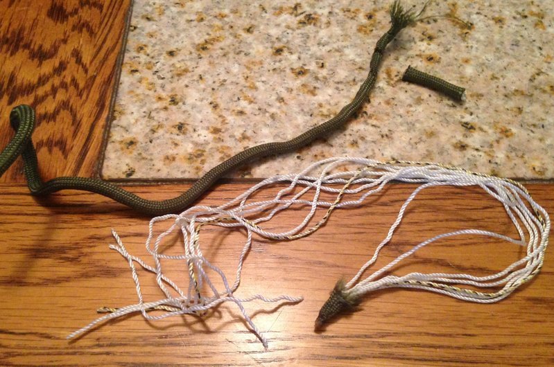

    Next, I stripped out some of the inner threads from a short piece of 550 paracord.

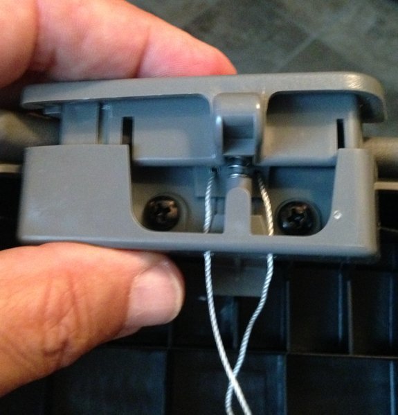

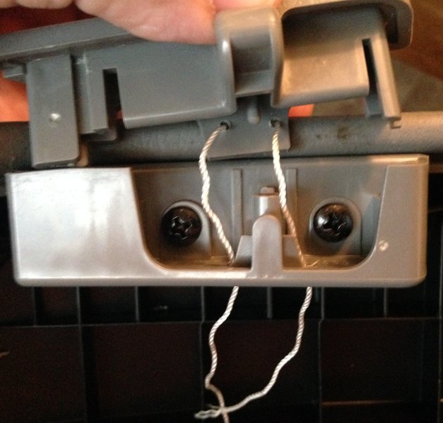

    Now I threaded one strand of the cord through the two holes on the latch (also, loop it around the inside of the latch, where the cords come out) and through the two holes in the frame.

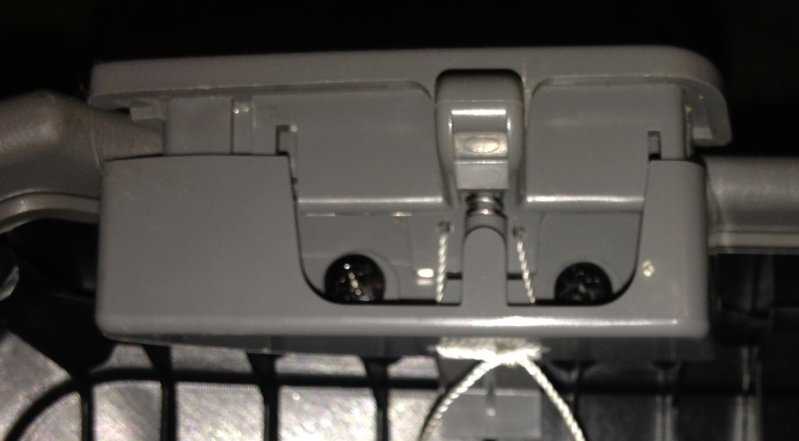

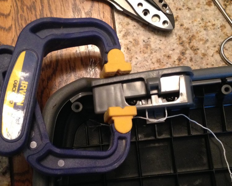

    Now, reassemble the latch and spring. I used a clamp to hold this in place while I tied it off.
    Note the last picture shows the final assembly before putting things back togeter. This was my first attempt and was way too loose. Tie the thread as tight as you can, as you can always pull a bit out if you get it too tight. A second pair of hands would make this a lot easier.
